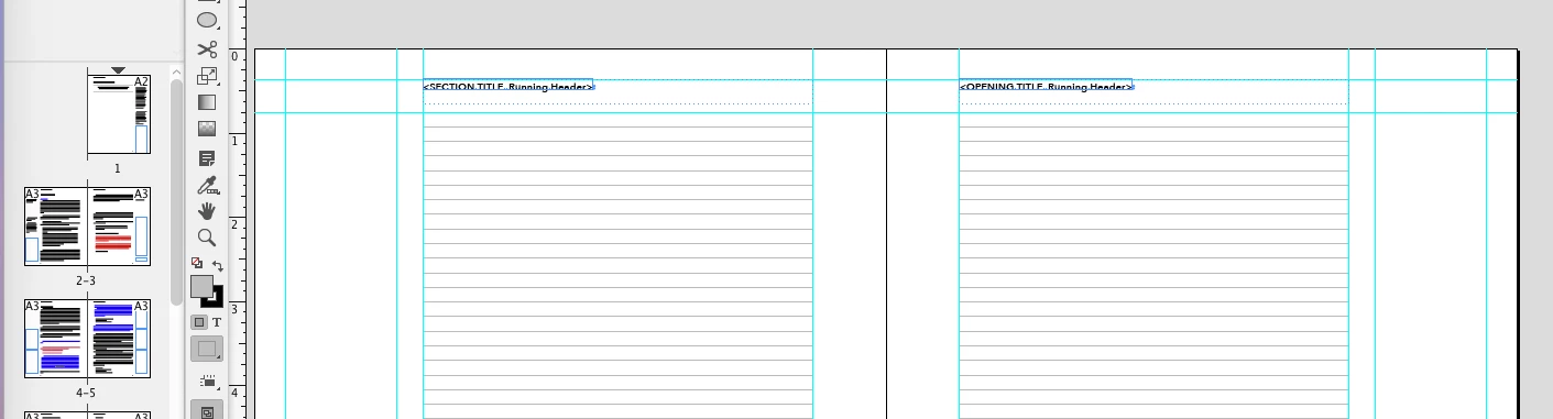

I have seen instances where facing pages in a book have the chapter title in a running header on the left hand page and a chapter subsection running header on the right hand page. I cannot find a resource with instructions - how do I do this?
See image: Screen Shot 230729-01
The A2 master is for the chapter title (here "Section" means "Chapter").
The A3 master is for the chapter subsections (here "Opening" means "Subsection").

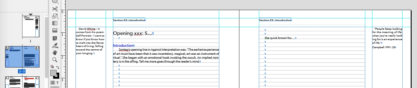

See image: Screen Shot 230729-02
The Section (Chapter) name is carrying over as desired from the first page of the file and appearing on the left hand page.
However, it continues to show in the header on the right page even though the Master A3 right hand running header is set to the variable for "Opening". Is this because the "Opening text is on the left hand page?
Is it possible to get the arrangement I would like ?
Thanks in advance for assistance.
Correct answer Thunder-Lightning
Hi Michael,
My suggestion is to check if your text variable <OPENING TITLE. Running Header> is set to the correct Paragraph Style, i.e. the paragraph you have used for 'Opening xxx; S…'. It might be still set to the Paragraph Style you used for Chapters.
Thunder-LightningCorrect answer
July 31, 2023
Hi Michael,
July 31, 2023
Aaaaahhh !!! That was it; I thought I had double checked...doing too much that day.
Thank you soo much !!!
