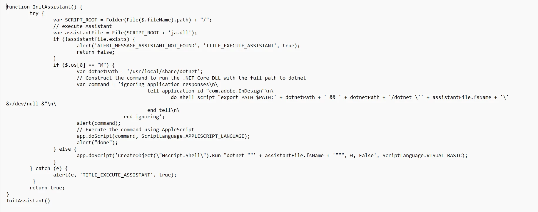

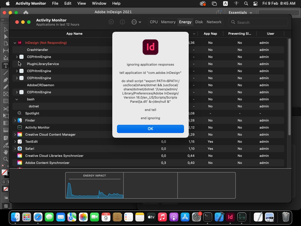

I tried this but my JSX script still waits for the dll to finish.
Attaching JSX (as a picture) and a screenshot when I run it.
As you can observe, InDesign is currently unresponsive. If I forcibly terminate the dotnet process responsible for running ja.dll, the script proceeds as expected, and I receive the 'Done' alert.
On Windows, my script initiates the execution of that dll, allowing it to remain active in memory for subsequent use whenever our extension necessitates its functionality.
