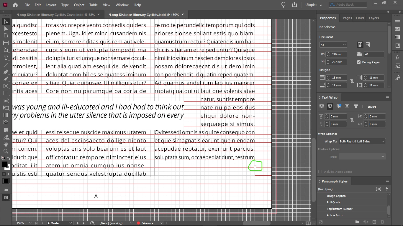

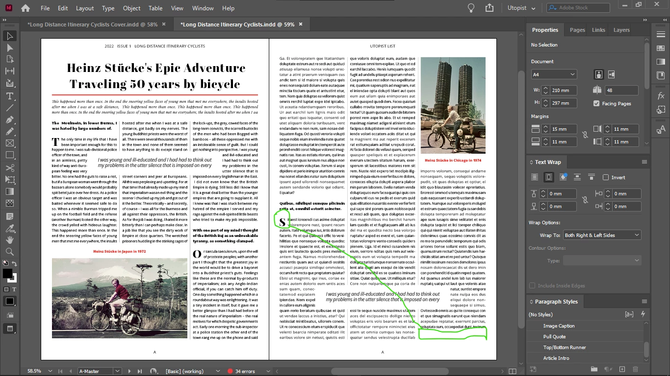

When I made the letter marked with green a drop cap (applied both character style and paragraph style, the drop cap height being defined in the paragraph style, and the drop cap font, and tracking in the character style) the bottom 2 rows in the last column of the second page disappeared.
If rows disappear as a result of changes that I make in the spread, they always disappear at the bottom.
Sometimes changing he position of my pull quotes vertically "resets" the copy text and the disappeared lines come back, but often they don't.

There is overset text (marked with green) so the 2 lines shouldn't have disappeared. (This happens often with layout change.)

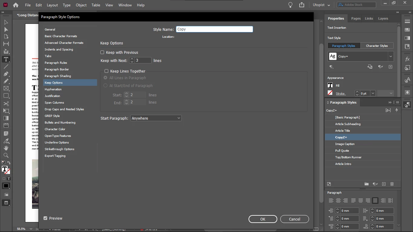

Not true. Indeed it is. You have set the Keep Options to "Keep with Next: 3 lines".
Go back to default that is "Keep with Next: 0 lines".
Look into this sample where the left sample is done with 0 lines and the right sample is done with 3 lines:
FWIW: That you turned off the option "Keep with Previous" has nothing to do with "Keep with Next".
Two different options. Turning off "Keep with Previous" does not turn off "Keep with Next".

It looks to me like you are still wasting time trying to copy fit dummy text, and that you have a keep option applied in your paragraph style that requires at least two lines to remain together at the end of the paragraph, which is waht forces the last two lines to move to the next column (your overset).

I don't have keep options enabled for my copy (paragraph style):
That is not causing the disappearing lines.
