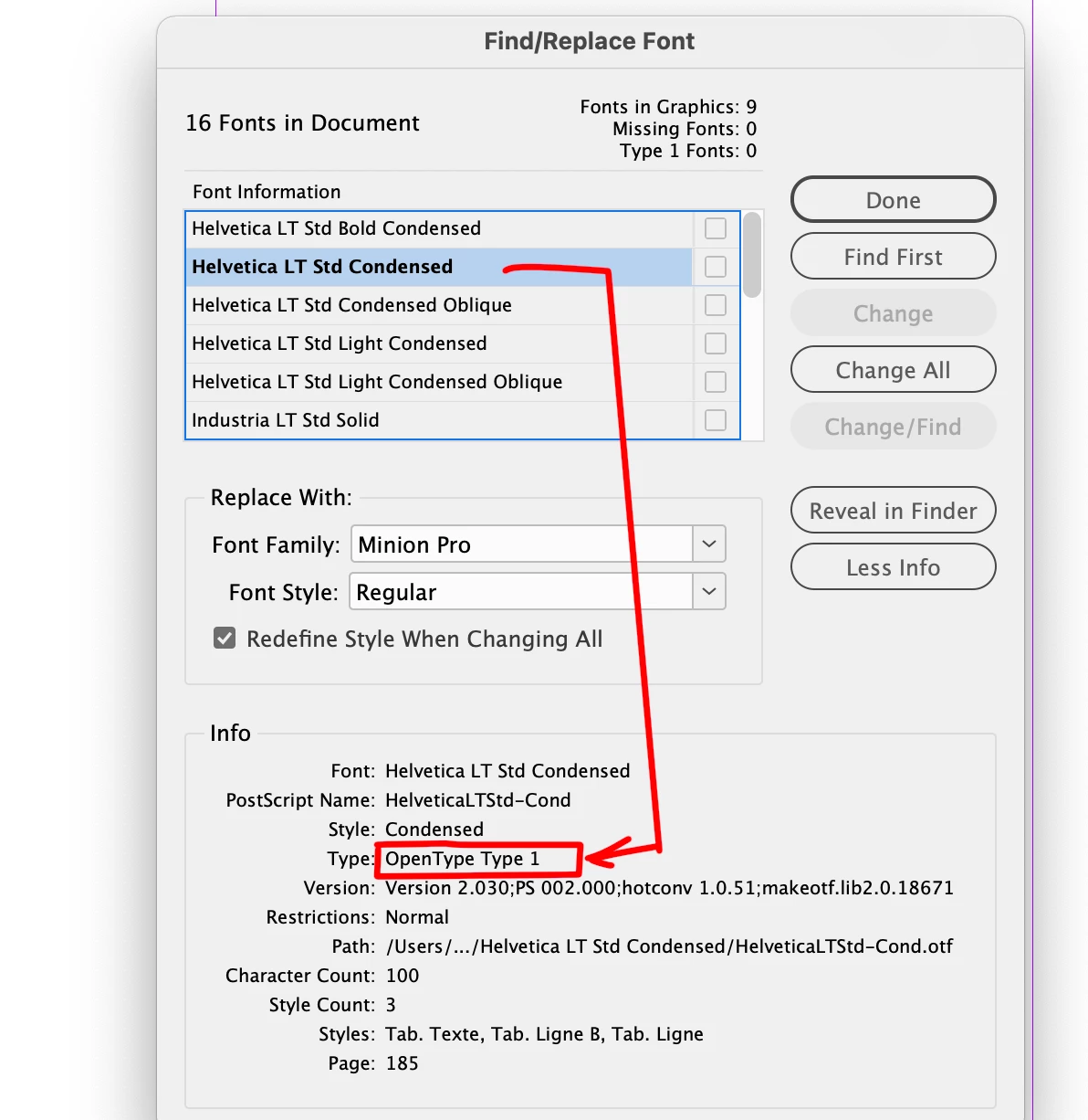

As everybody else has said the fonts that you are using are Open Type Fonts. I am wondering why you thought that the fonts were Postscript Type 1. The warnings that have been popping up for the last couple of years as to the discontinuation of the old fonts can actually pop up if perhaps there was at some time a Type 1 font used in the document which may have left either a blank space or unused paragraph return that is still reading as the old font. You can check this by going into Find/Replace Font under the Font menu and see if there is a listing for any fonts other than the ones you actually want in the file. If there are then globally change those to the Open type versions.

"I am wondering why you thought that the fonts were Postscript Type 1."
I think it's because InDesign lists them as OpenType Type 1 in the Font Lists. The fact it even mentions Type 1 is throwing people off into an unnecessary panic. I wish Adobe had been clearer about this, but here we are.

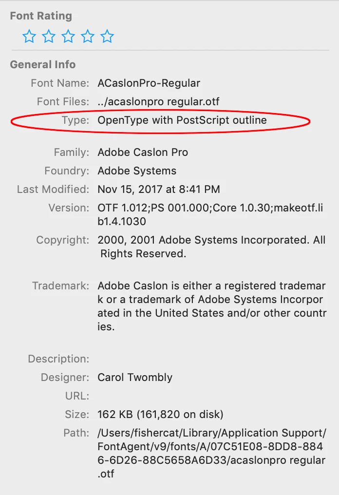

Sep 12, 2022 1:45 PM UTC
Apparently these are Type 1 fonts which Adobe plans to stop supporting in January.
Hi @Tom2604280896iw , AdobeCaslonPro is not a Type 1 font—the FontAgent font manager app lists it as OpenType with Postscript outline, not Type 1. All of the OpenType fonts in my library are listed this way:

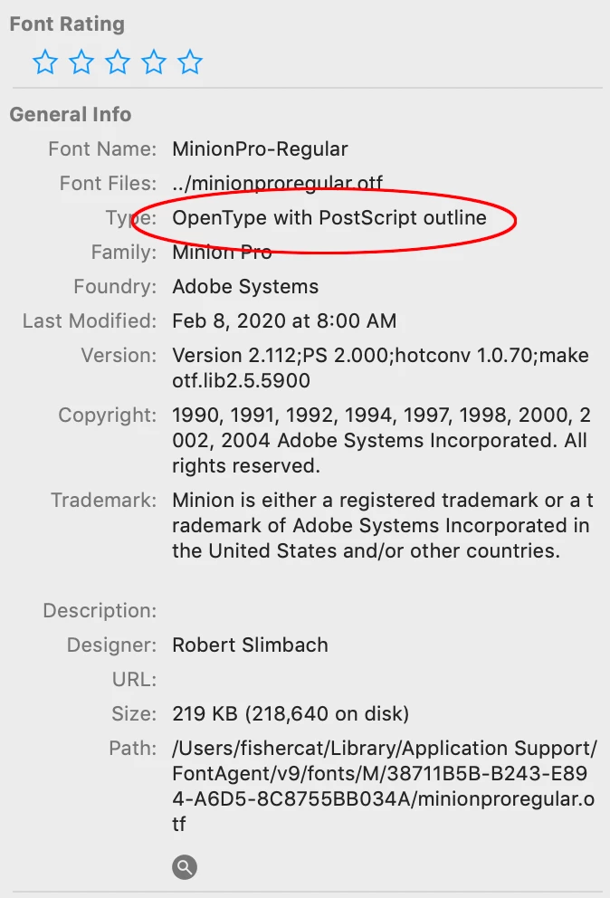

The InDesign default font MinionPro is the same:

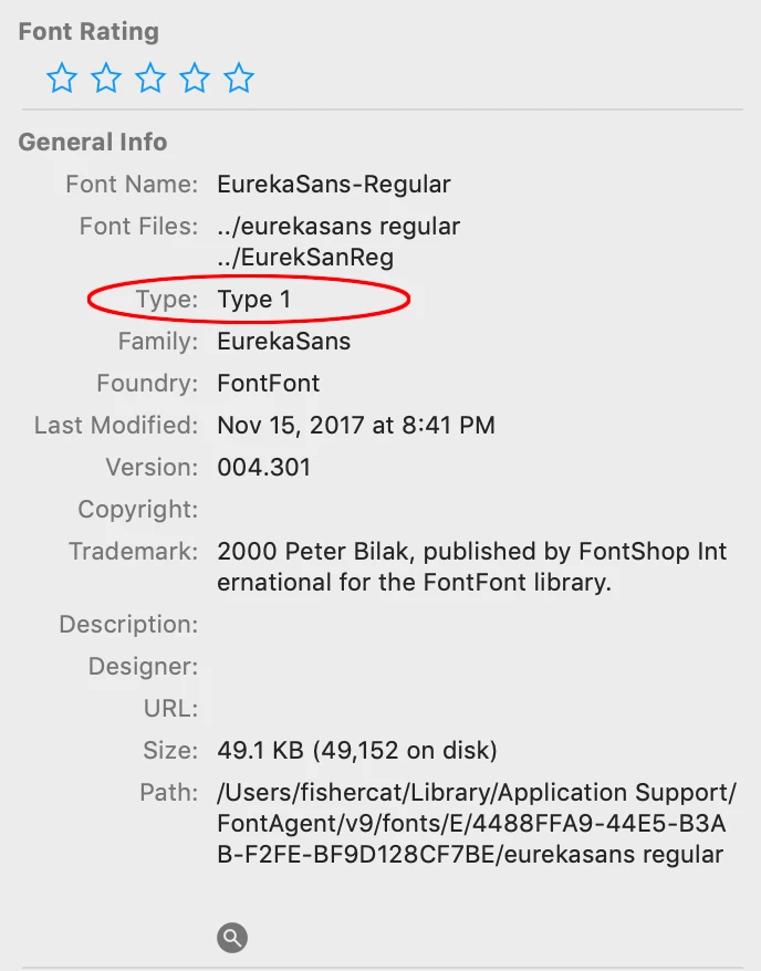

FontAgent lists Type 1 fonts as Type 1. EurekaSans is an example of a Type 1 font that future versions of InDesign will no longer support.
