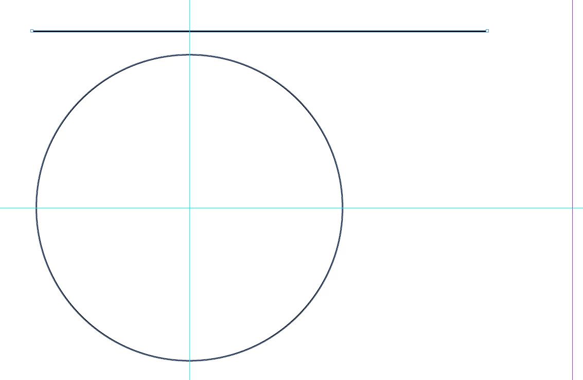

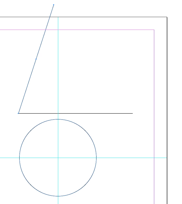

I've googled everywhere about this but can't find a working answer yet. I want to divide a solid circle into 5 equal parts. All of the suggestions out there suggest I use the "paste in place" function. I create a circle. I draw a horizontal line that's equal to the radius of the circle. I align it to the right and centered vertically in the circle. Then, I do a "paste in place." This confuses me because I see a little flash as it duplicates the line. But, when I try to rotate that second line 72 degrees, nothing happens. I don't see where that second line is that I supposedly duplicated from the first. So, I end up just duplicating the line, rotating it appropriately and try to have it start at the same point as the first line. I do this for 5 lines, 72 degrees from each other.
360 degrees divided by 5 is 72. That's why I'm creating these lines 72 degrees from each other. And, I get my circle with 5 equal parts with these lines. But, they're just a bunch of lines. I want to use them to cut the circle into 5 pie shapes. I've tried compounding the paths, but, that doesn't work.
Thanks a lot for any help.

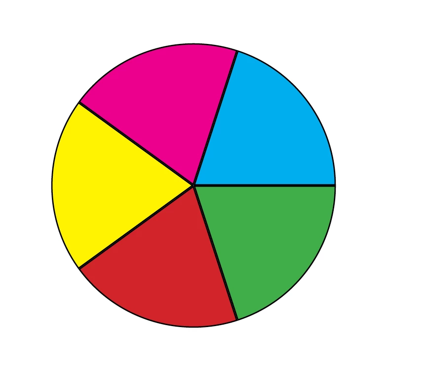

    If you don't have Illustrator and you have to do it in InDesign, here's another way. I'm not saying it's better or worse than any other way, but it does work.

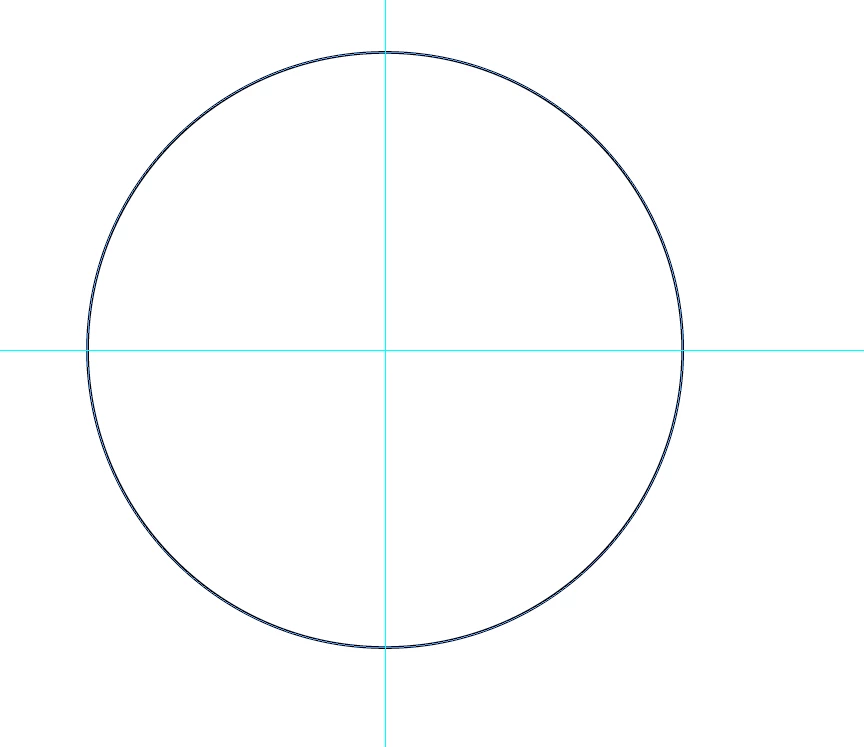

    1. Start with a circle, and place guides at the center both vertically and horizontally.
    2. Make a straight line.
    3. Rotate the line 72° from the left side, and hit the Copy button instead of the OK button.

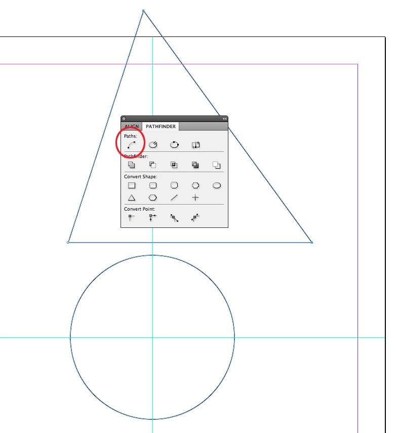

    4. Join the angle at all three sides with the Join Path tool in the Pathfinder.
    5. Snap the bottom left corner of the triangle into the intersection of the two guides in the center of the circle.

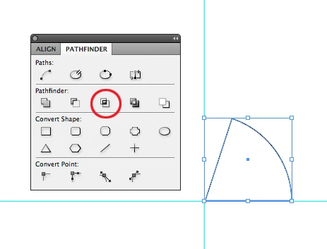

    6. Select the circle and the triangle and use the Intersect tool in the Pathfinder. This will create a wedge with one rounded edge.
    7. Use the Rotate tool to rotate a copy of the wedge 72°, with the rotation proxy set to the lower left corner where the guides intersect.
    8. Repeat the rotation/copy for the other 3 segments with Object>Transform Again.
    July 25, 2012
    This looks great, but, it doesn't seem to work for me. I managed to make the triangle, but, not in the way you suggest. Pathfinder did nothing for me. There is no "join" for PathFinder. So, I just used Path/Join. After I placed it at the center of the circle, though, all of the PathFinder attributes are grayed out. I can't use them to slice the section out of the circle. Your finished product up there looks great to me, so, I'm open to more prodding.
