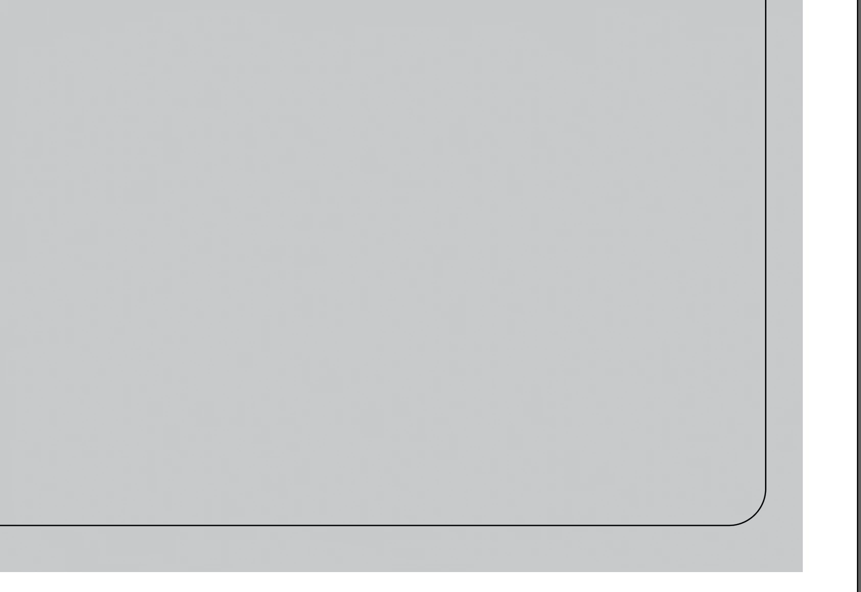

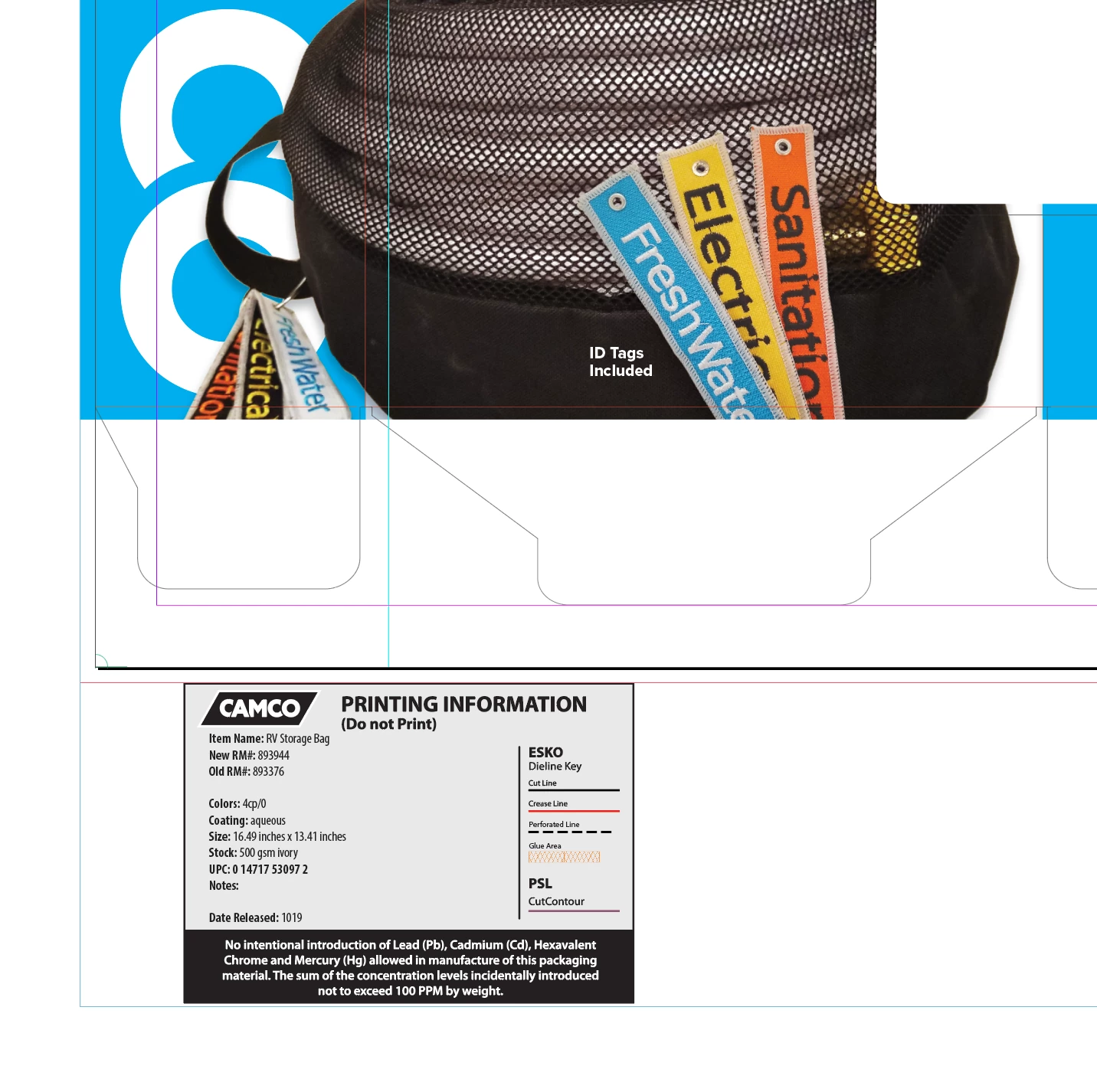

Bleeds and Slugs
Bleed: an area outside of the cutting edge of your document -- this is used if you have color or an image that you want to print all the way to the edge of the page. Becasue cutting dies will not hit precicely where planed, it allows an extra margin (around 1/8 inch) so that if the die moves, you will not have a white halo on your finished piece.
Slug: An area outside the printed piece that is used to convey information to the printer -- colors used, page size, what kind of varnish, ect. (Left image shows bleed, right one shows slug area)
