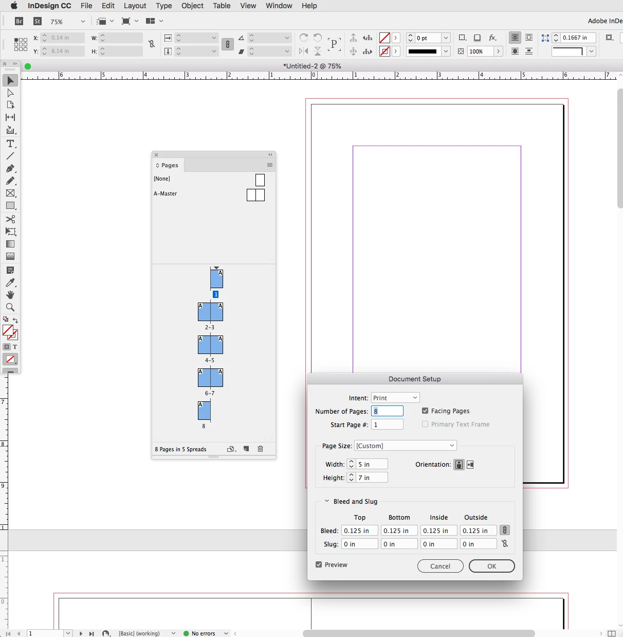

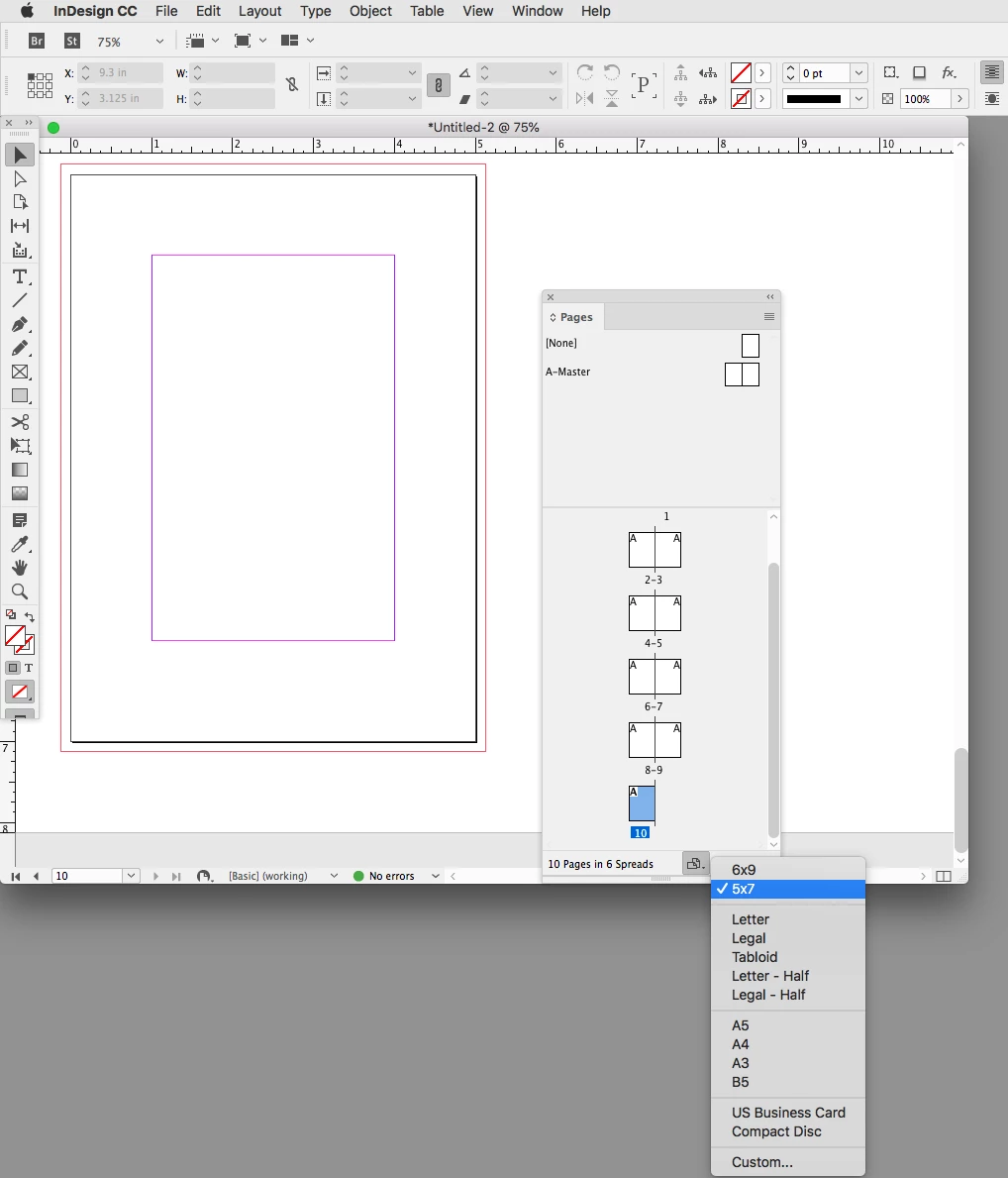

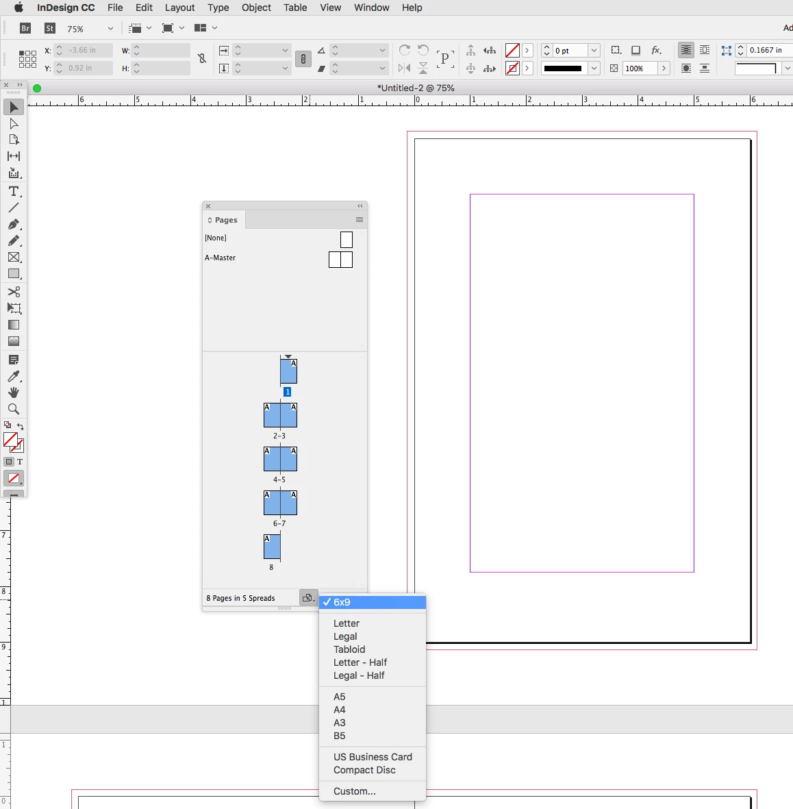

    Sounds like you may have made a custom page size and applied it to all of the pages?
    Here my Document is set up to 5x7 but the pages are set to a custom size that I made via the Edit Page Size>Custom... icon in the Pages panel. Try selecting all of the pages and make a new custom size that matches the 5"x7" document setup
