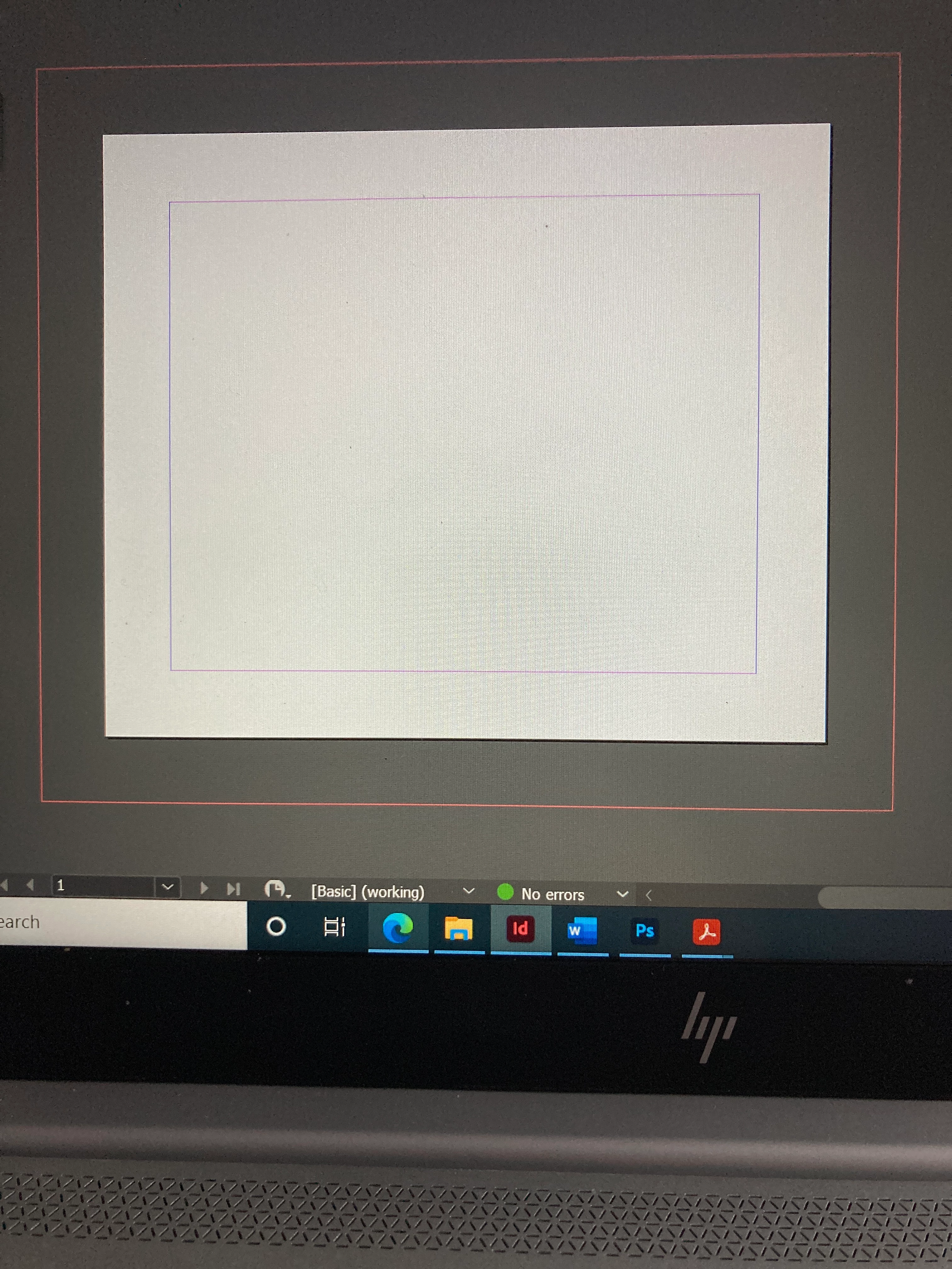

I am new to InDesign so apologies if this is a stupid question.
I have to design an ad for a newspaper and the dimensions are quite odd. Width 2.68" by height 2.25".
Usually, I would use 0.25 margins and bleed but I am just a bit confused with how everything looks. There is a much larger margin size/white space than usual and I am unsure if I am supposed to have everything designed to reach the black lines/ go over that white space to the edge or if I should have everything designed within the pink/purple lines (but then there are the huge margins just there). Can someone please help me out? I was just told to stay within the purple/pink lines and to never reach the bleed so I am confused about the actual document size/ad size. I hope this makes sense..

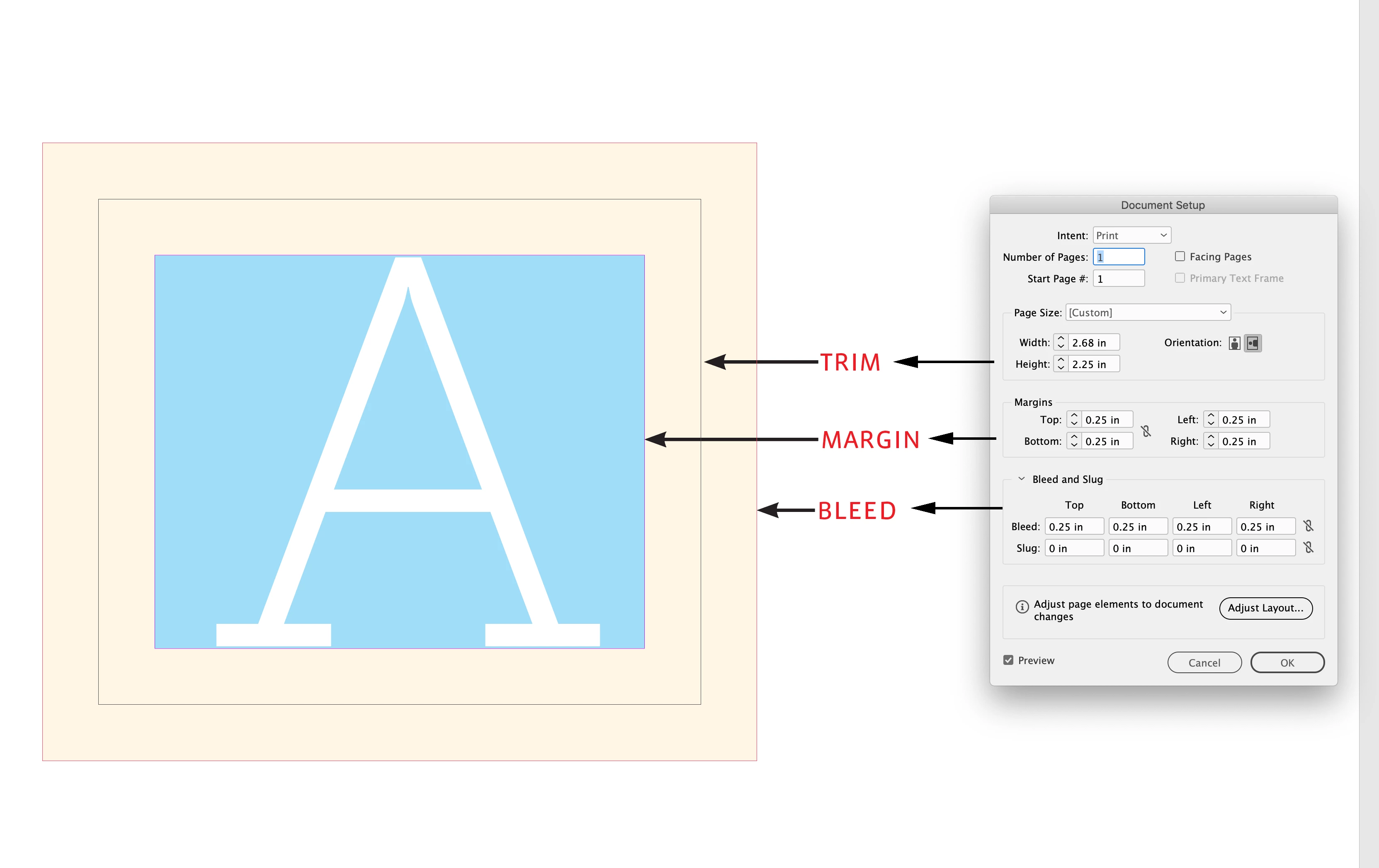

HI @abstract_Melody5E5D You can take the Margin, Trim, Bleed terms literally. The Trim line is where the page would be cut if it was output as a single page and trimmed, the Bleed is the amount that would be cut off, and the Margin would be the visual space from an object set on the margin to the trim edge.

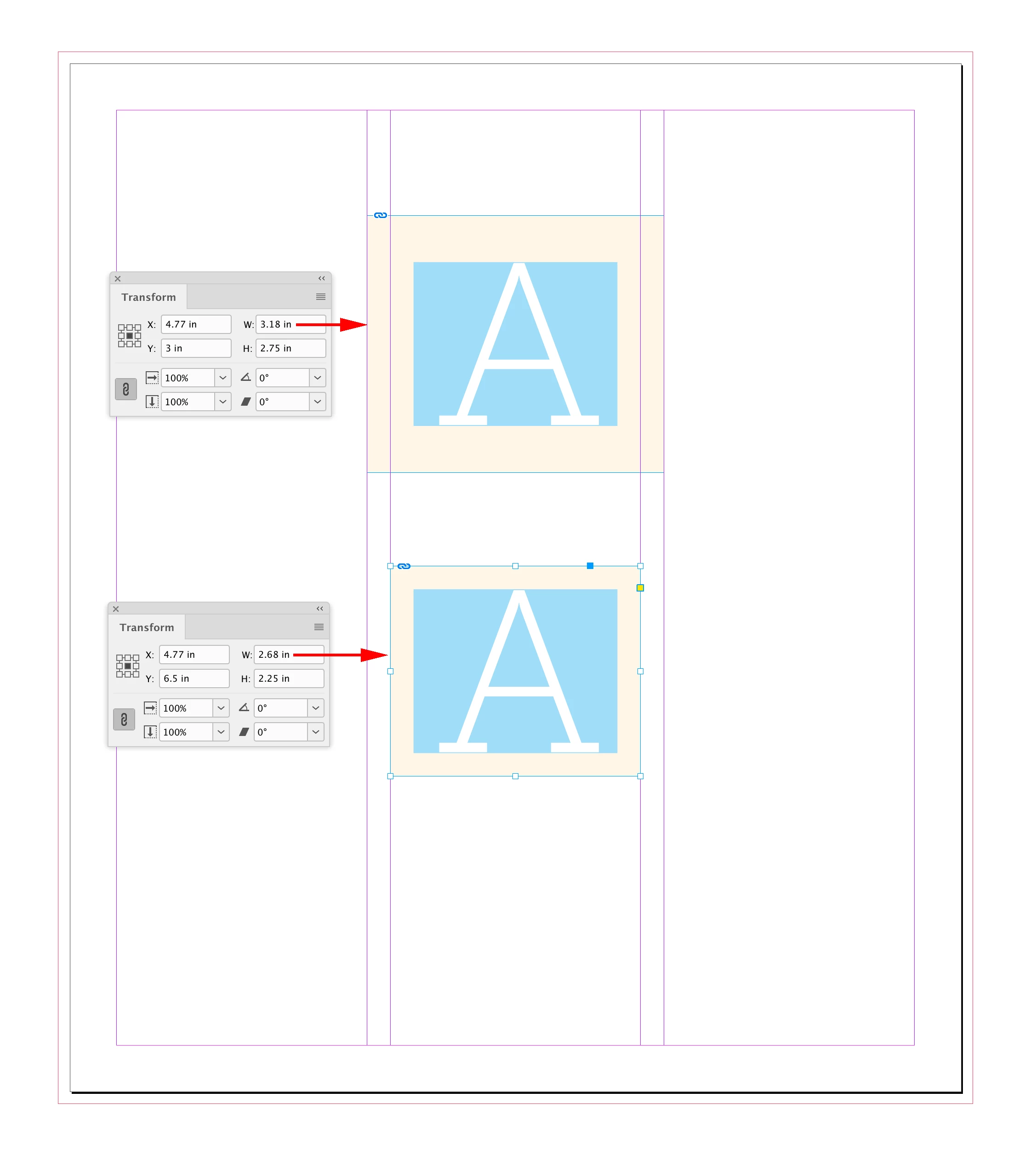

So to illustrate Jame’s post:
Your ad is going to be placed in another page layout and not trimmed, so you don’t really need to include a bleed—if you do and your ad gets placed with its bleed it will be 3.18" not 2.68":
