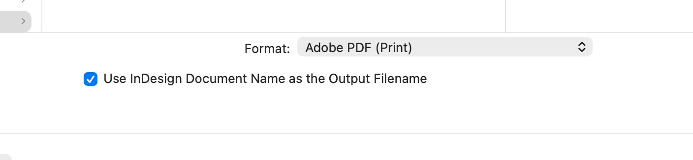

    davecourtemanche
    Mar 25, 2026 9:36 PM UTC
    When you export to PDF, do you see this box checked?
    Alsie Boy
    Alsie BoyAuthor
    Mar 26, 2026 9:17 AM UTC
    Thanks for your reply, I have re installed an earlier version and the problem is solved.
    I will try the latest version again and double check that box is checked.
