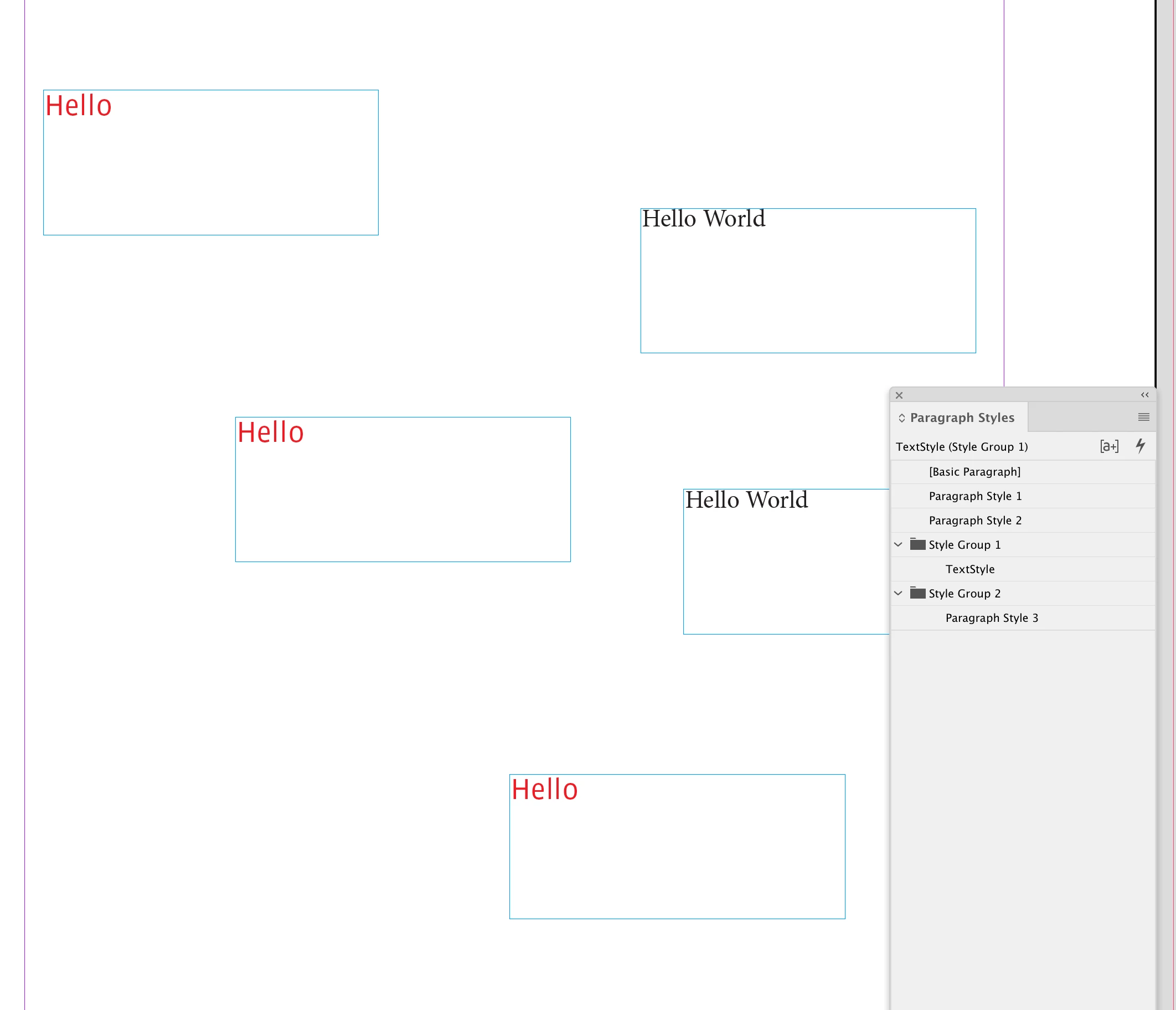

Thank you so much, this does exactly what I need! Only issue is, as Robert alluded to above, it doesn't work if the style is inside a style folder. Can you help me understand how to alter this code to fix that please?
Eubha

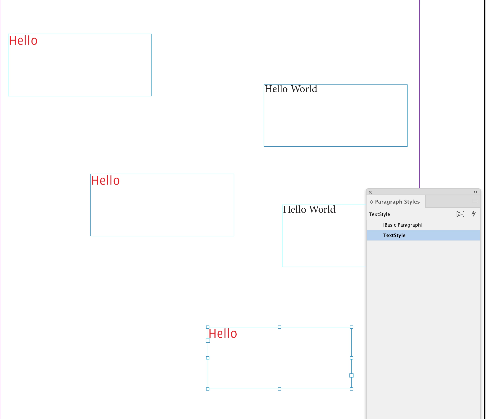

Try this:
var ps = app.activeDocument.paragraphStyleGroups.everyItem().paragraphStyles.itemByName("TextStyle")
pStyleSearch(ps,"World", "");
* Paragraph Style Grep find and change
* @ param ps the find paragraph style
* @ param f the find string
* @ param c the change string
* @ return void
function pStyleSearch(ps,f,c){
    app.findGrepPreferences = app.changeGrepPreferences = app.findChangeGrepOptions = null;
    app.findChangeGrepOptions.properties = {includeFootnotes:true, includeHiddenLayers:true, includeMasterPages:true, wholeWord:false}
    app.findGrepPreferences.appliedParagraphStyle = ps;
    app.findGrepPreferences.findWhat = f;
    app.changeGrepPreferences.changeTo = c;
    app.activeDocument.changeGrep( true )

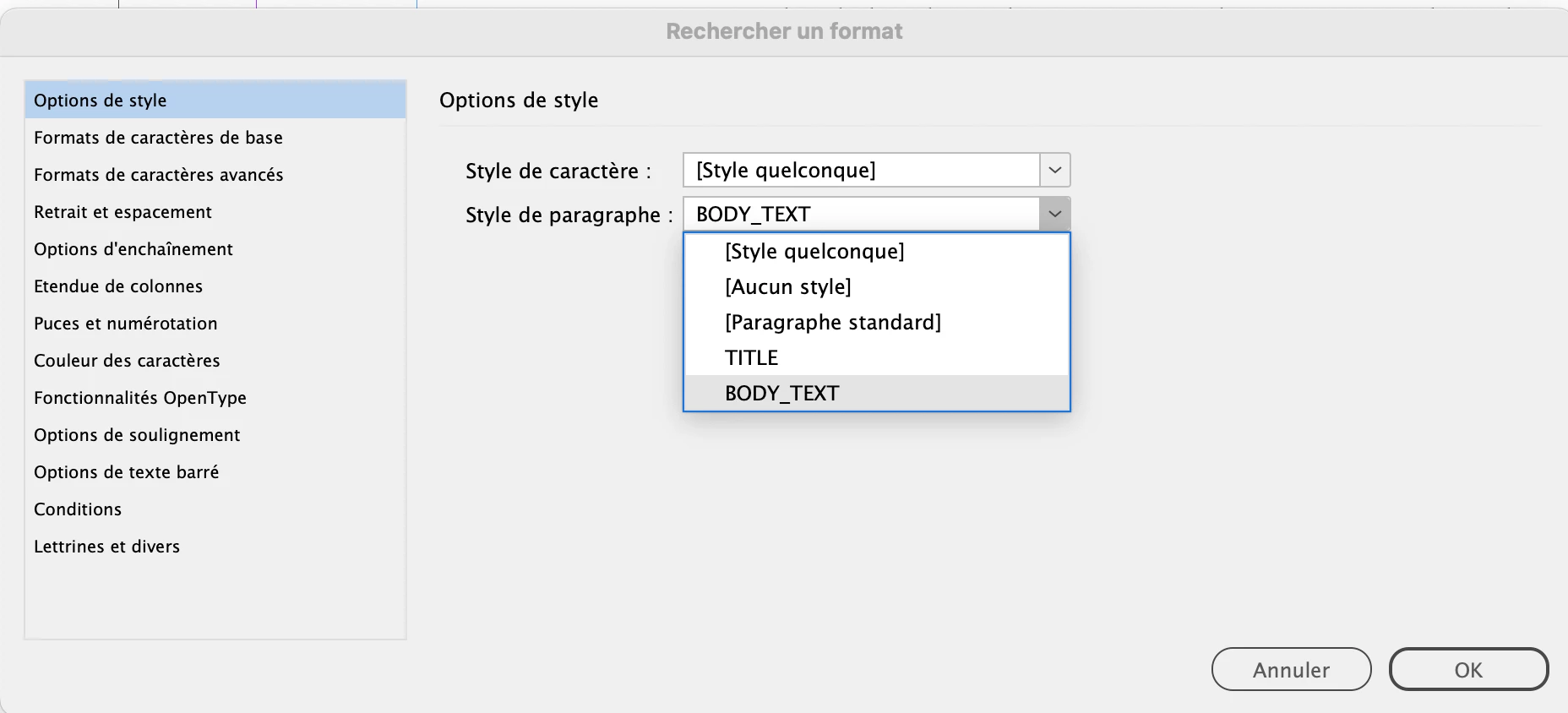

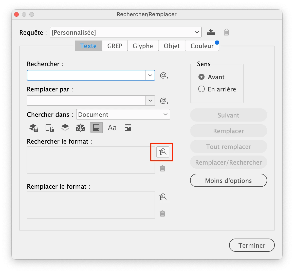

I am not a scripter but you don't need any script to do this. Simply run a find change and specify the paragraph style you want by clicking on the icon which is surrounded on my screenshot.

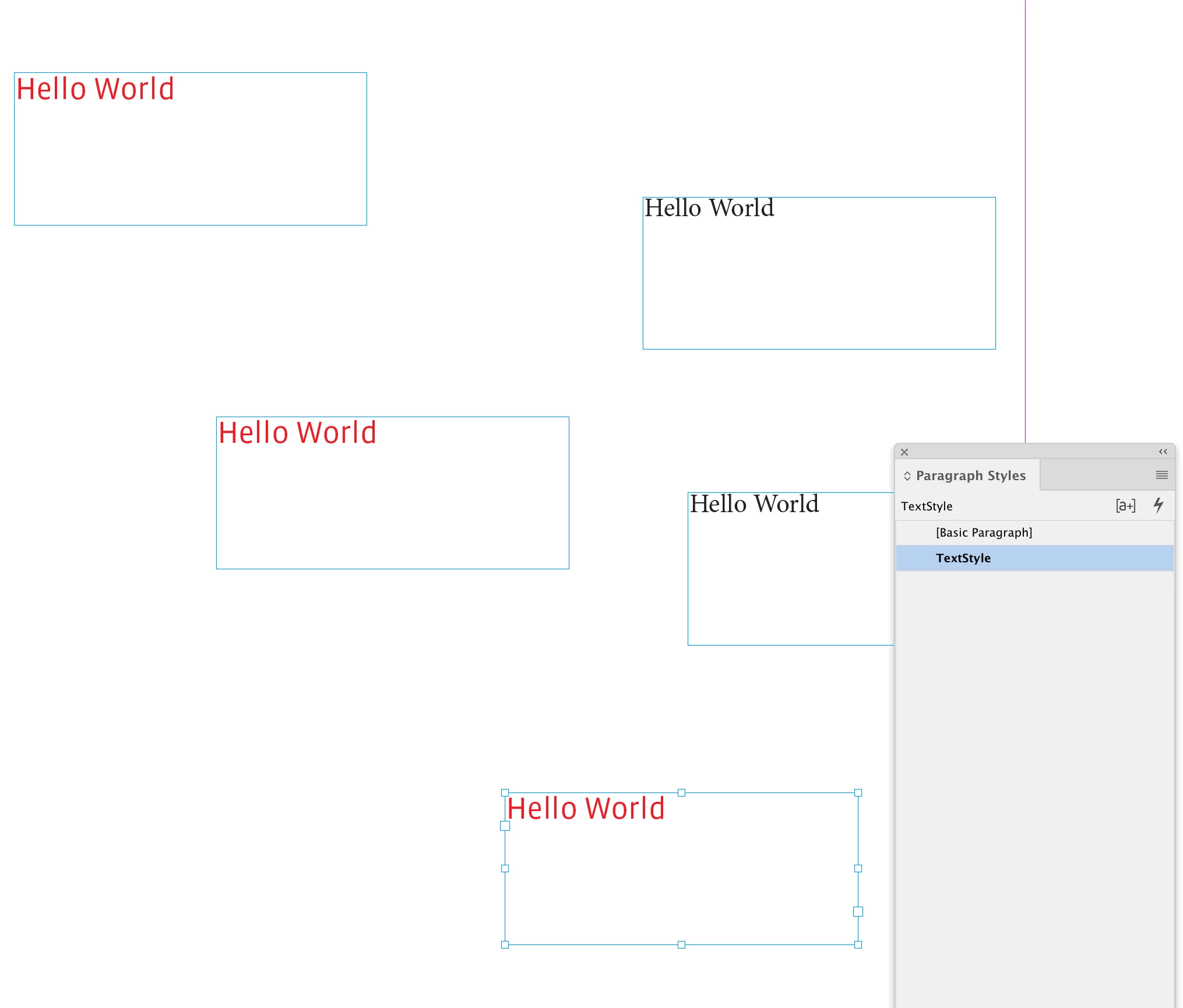

Hi @EubhaLiath , You could add a helper function to your larger script, something like this:
pStyleSearch(app.activeDocument.paragraphStyles.itemByName("TextStyle"), "World", "");
* @ return void
