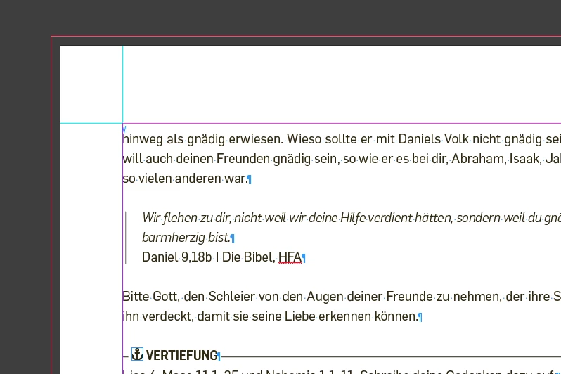

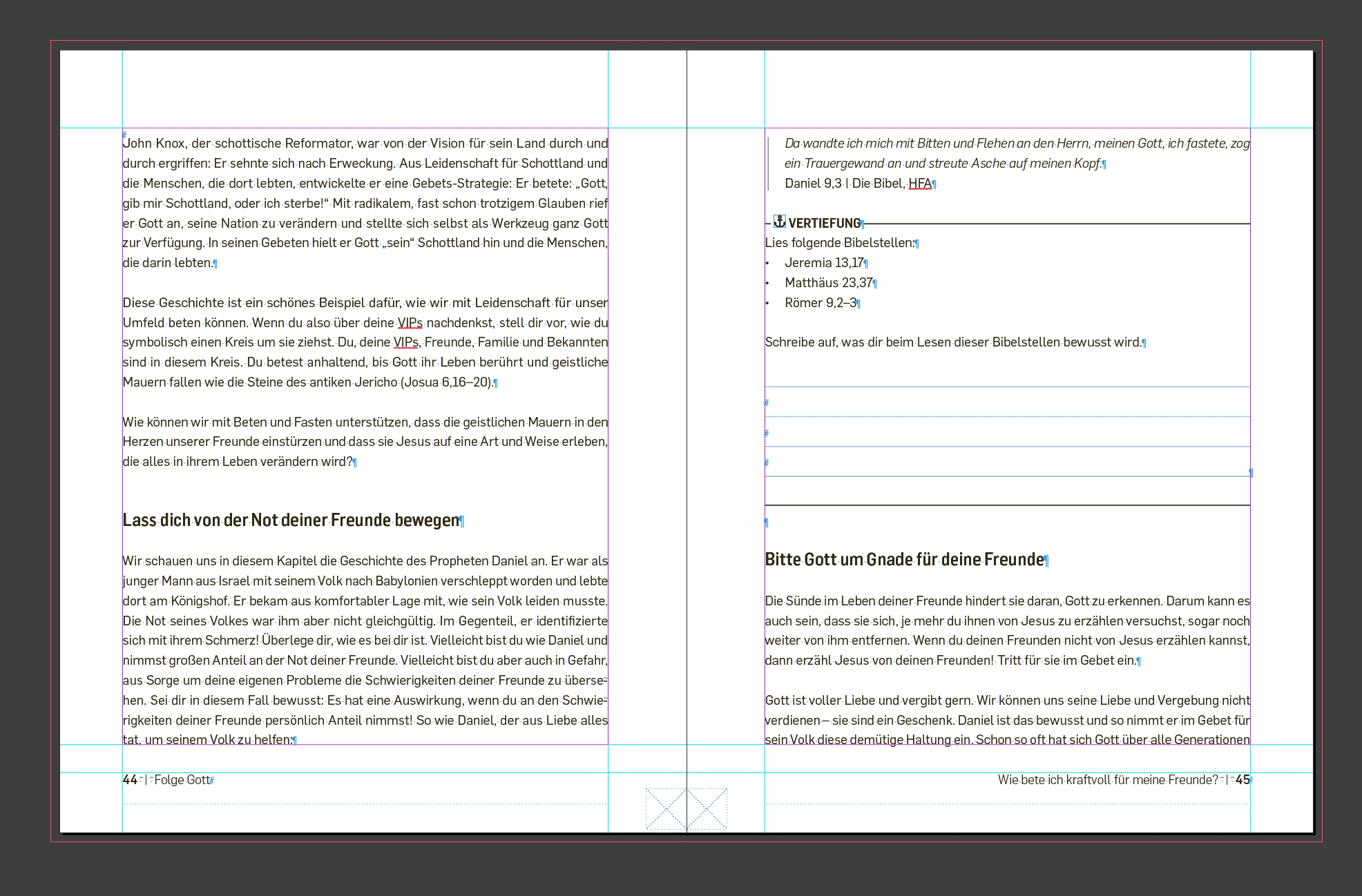

Hi everyone,
This might be a super basic question, but should my background extend all the way to the bleed? This is for a book project, and I am not using any specific background color. The backound is just the overall layout.

Any element intended to bleed — reach the trimmed edge of the page  —  should extend all the way to the bleed line, or past it so that it is trimmed/truncated there on export.
The page background itself does not need to visually reach the bleed line; it's assumed the paper goes that far on the press. Your pages above look fine. (And you don't need to specify a bleed for most printers/print services if nothing extends past the page margins, or at least the printer's defined "live content" limits of about 3/8 of an inch from the page edges.)
But some print services, KDP notably among them, will throw an error if there is a "gap" between an element that extends into the bleed but does not reach the bleed line. So for best practice, any line, graphic, background, etc. intended to bleed should, yes, reach or overlap that bleed limit.

@James Gifford—NitroPressThank you very much for your input! So, if I understand correctly, in my case, I can leave the layout as it is?

If you have no bleeds, you don't need to worry about or export with bleed. That the page image doesn't extend out there is just a quirk of how InDesign displays things.

Any color or image that reaches the edge of the page must extend to the bleed frame.
