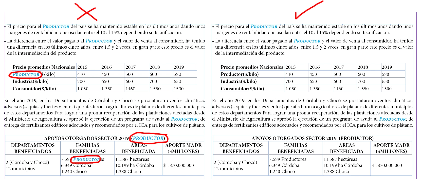

Hi, I'm new to scripts.
Performing searches I can apply styles to specific words, so far so good, but the problem is that my document has many tables where that searched word is also present, is there a way to apply the style only in the document and not in the tables? Maybe using script?
I would appreciate your help. And sorry for my writing, I don't speak English well.
I am attaching a picture so you can better understand what I want.

Hi Jesuale,
the basic algorithm could be this:
[1] Run a GREP Find action and store the found texts to an array.
[2] Loop that array of results and check the parent of the found text snippets.
If the parent is a cell, do nothing and continue to the next found item.
If the parent is not a cell do a change to that found text.
Look up this discussion we recently had:
[JS] Problem with change grep with look behind/ahead and /K
Kasyan Servetsky, Mar 16, 2022
https://community.adobe.com/t5/indesign-discussions/js-problem-with-change-grep-with-look-behind-ahead-and-k/m-p/12818708#M469736
In a nutshell the code below should work for you with GREP Find/Change. Not intensively tested, though. That's your job. To make that work do the following:
[1] Do your settings in InDesign's GREP Find/Change normal user interface.
[2] Then as a second step run this ExtendScript (JavaScript) code:
Posted by Uwe Laubender at the InDesign User Forum:
https://community.adobe.com/t5/indesign-discussions/don-t-search-inside-tables-or-skip-tables/m-p/12937086#M476815
( function()
app.scriptPreferences.userInteractionLevel = UserInteractionLevels.INTERACT_WITH_ALL;
app.doScript
	ignoreTables,
	ScriptLanguage.JAVASCRIPT,
	UndoModes.ENTIRE_SCRIPT,
	"Find/Replace GREP; Leave out Tables | SCRIPT"
function ignoreTables()
	var txt, changed,
	doc = app.activeDocument,
	found = doc.findGrep(false);
	for (var i = 0; i < found.length; i++)
		// IGNORE TEXT IN TABLE CELLS:
		if( found[i].parent.constructor.name == "Cell" ){ continue };
		// TEXT OUTSIDE TABLE CELLS:
		txt = found[i];
		app.findGrepPreferences.findWhat = txt.contents;
		changed = txt.changeGrep();
If the result is not to your liking you can undo the whole thing with one single undo that is reading:
Thanks Kasyan Servetsky for providing the core part of the code.

Thank you very much Laubender the code worked perfectly, I appreciate it very much, I will review the link you gave me to learn much more.
Greetings from Bolivia
Jesus Aguilar
