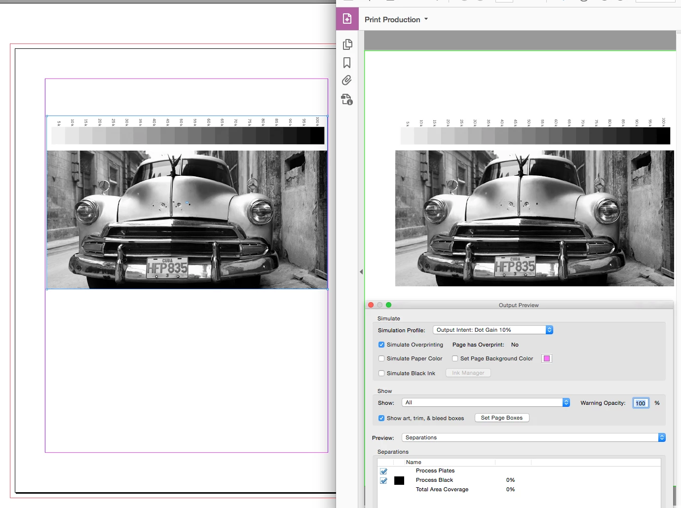

    When you convert from RGB to grayscale the preview of the converted gray values would depend on the gray profile used to soft proof in AcrobatPro. So if you export a PDF with the destination as a gray, make sure that you set AcrobatPro's simulation profile to the same profile otherwise you will get a different preview for the same output numbers.
    So here I've exported an RGB image with 10% Dot Gain as the destination. I've used the PDF/X-4 preset so the 10% Dot gain profile is the default for soft proofing (see my post in your other thread). If I change the simulation profile the preview changes even thought the output numbers are the same:

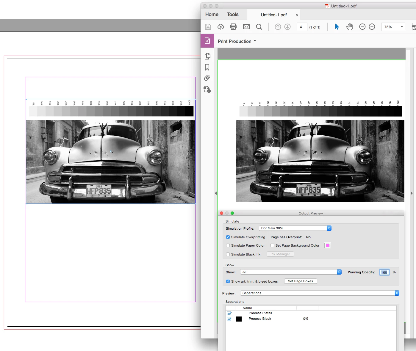

    My 10% Dot Gain export soft proofed as 30% Dot Gain:

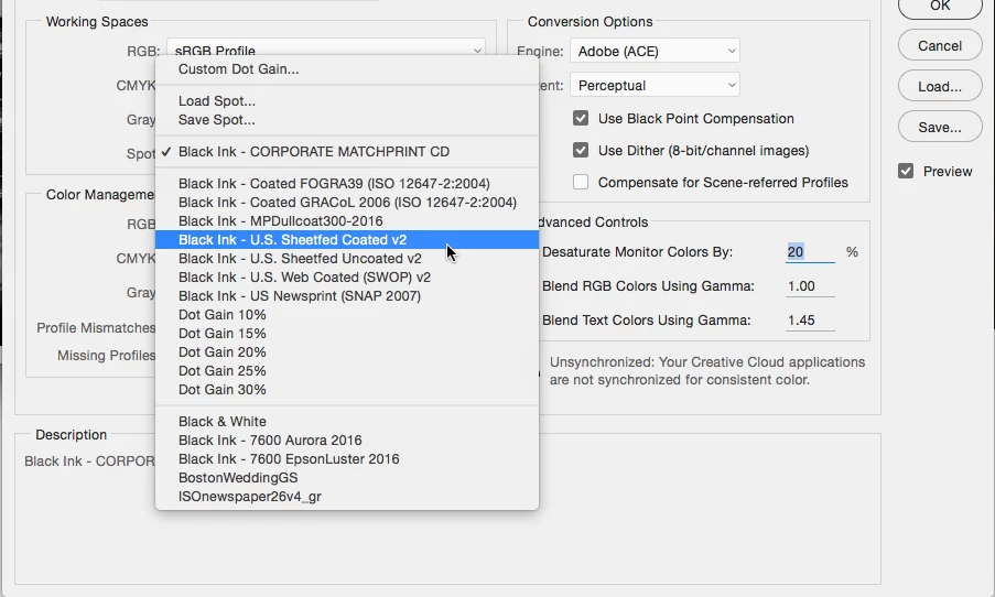

    That link is pretty old. Later versions of Photoshop let you save out Black Ink profiles from any CMYK profile so you can avoid older, less accurate curve based profiles. So if I'm using US Sheetfed Coated as my InDesign CMYK profile, I can use a matching Black Ink-US Sheetfed Coated for my grayscale  conversions and previews. A press can't have two different profiles—gray and K normally print on the same plate:

    One thing you have to be careful about is InDesign has no support for gray profiles. Embedded profiles in placed grayscales are ignored and the document's CMYK Black ink profile is used for the preview of grayscales. While you can force a conversion to grayscale on PDF export, the exported gray objects have no profile assigned. Exporting to 20% Dot Gain and 30% Dot Gain will produce the same preview if the PDFs are viewed via their respective destination profiles. The difference is 20% will export with higher output values than 30%.
