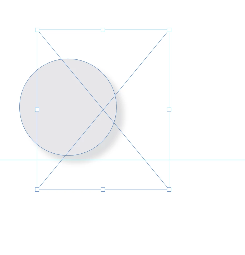

Hello, I am trying to create a double page spread where the shapes are cut off at the binding - so I do not want them to bleed into the facing page. There is probably a simple solution but I'm a novice. Any suggestions?
Attached an example of a circle, I want this to be cut off where the binding is, and the rest of the shape just appear on one of the pages.

You can do your document as single pages - not spreads - and create and apply different Master Spreads.
But like already mentioned - talk to your printing place.
October 26, 2022
draw a graphic frame with its edge on the page edge, and large enough to accomodate the circle and its shadow.
Select the circle and cut it. Then select your empty graphic frame and choose Edit > Paste Into
