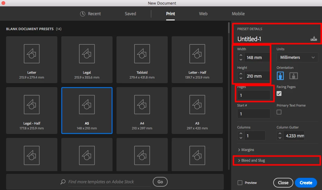

    File>New Document
    Select <Print> from the top
    Select your width and height
    Pages (how many you need)
    Add a title if you wish
    All the above can be altered at any point anyway.

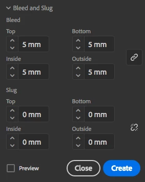

    In same panel - select how much bleed you wish to add - 5mm is  plenty and 3mm is usual (for me anyway)
    Clicking Bleed and Slug brings you the section to add this information (although selecting a print document should automatically add at least 5mm bleed by default imo).
    Add the amount of Bleed (your print provider can advise you of that).
    Now click the Create button.

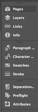

    Click the pages panel to reveal the pages in the document.

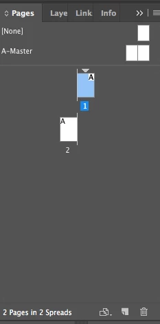

    Oops - slight error it's setup as facing pages - no  problem

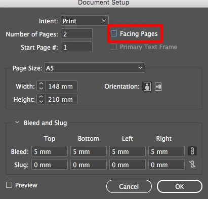

    File>Document Setup
    Untick Facing Pages
    You can also alter your page size, number of pages, bleed etc. from here

    File>New Document
    File>Document Setup
    Untick Facing Pages
