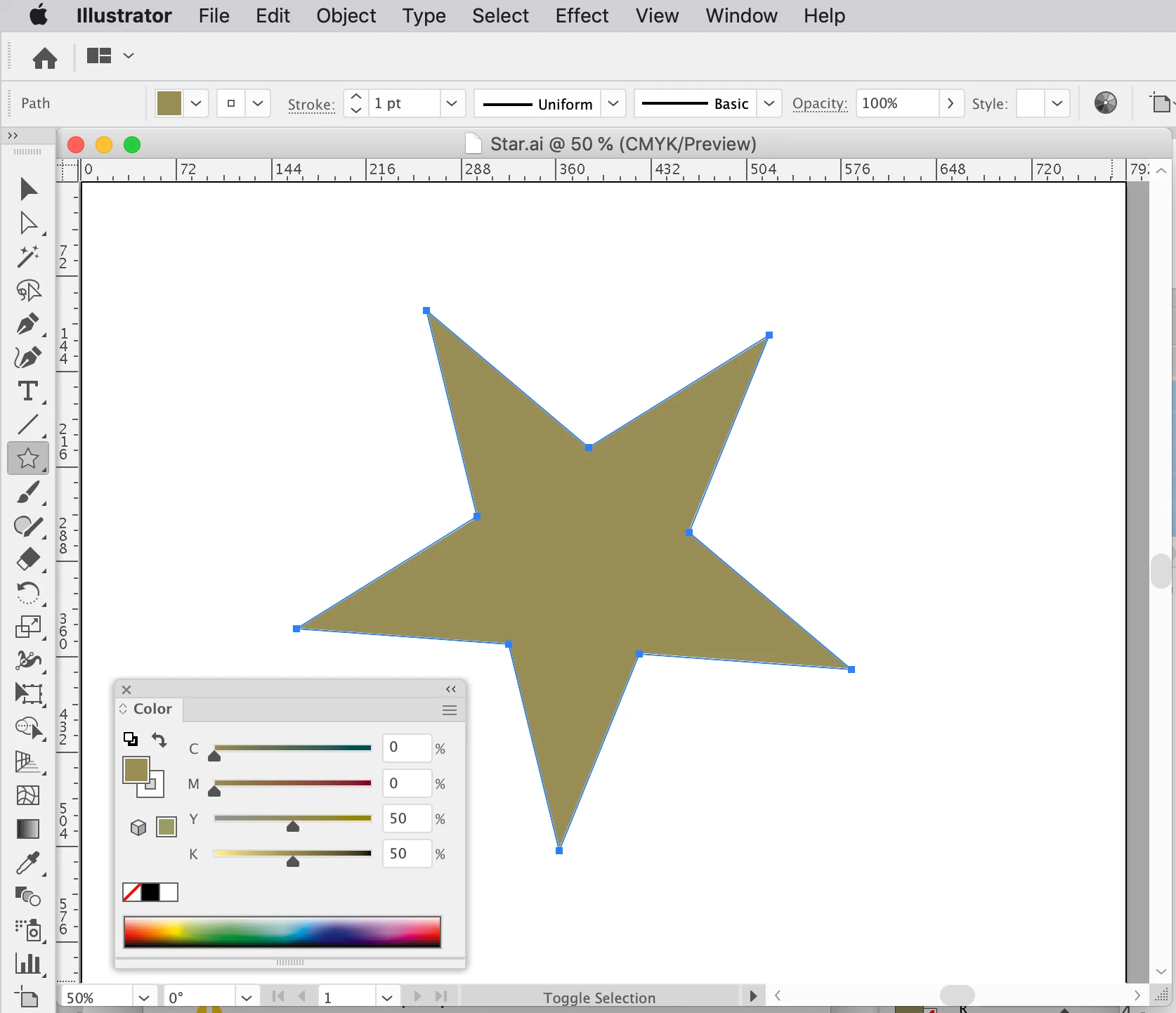

Hi @e.l , Also, the reason the eyedropper is sampling the preview and not the actual values is, a PDF or AI vector file could contain objects with any number of color spaces, while an image can only have a single color space—the eyedropper will sample an image file’s actual colors.
You could use Separation Preview to get the document CMYK output values of a placed AI or PDF file. If your AI file’s Document Color Mode is CMYK and it does not have a conflicting CMYK profile embedded, Separation Preview will get the actual CMYK values:

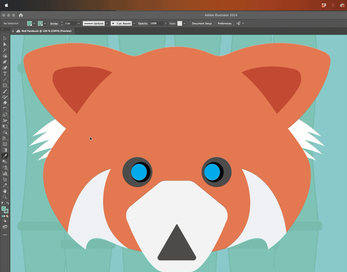

And in Illustrator, here's how:
~Barb
