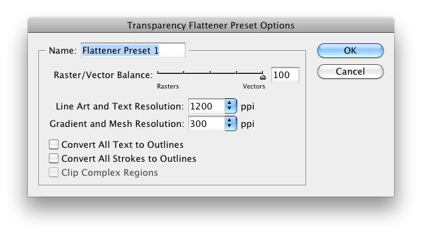

There are two places where you specify output resolution in InDesign. These do not affect the active file, just how that file is printed or exported to PDF. First there is the Flattener Preset, which is used when you output to a format that does not support transparency. This means EPS, Printing to a PostScript printer, or exporting to older versions of PDF.
This is what the High Resolution Flattener Preset looks like:
This says if there are transparency effects, raster effects like glows and drop shadows will be rendered at 300 ppi. This does not affect placed images, except where the transparency effect (like a drop shadow) interacts with a placed image. The reason for this feature is that the PostScript file format, used in most high end printers and the initial foundation of the PDF format, did not support objects that would could partly see through, such as faded images, glow effects, or drop shadows. When preparing files for PostScript (like a printer) or older versions of PDF there must be some rule for how Indesign will blend overlapping transparent objects. If you are preparing PDF files for print and they require flattening you will probably be using this preset or one proscribed by the printer.

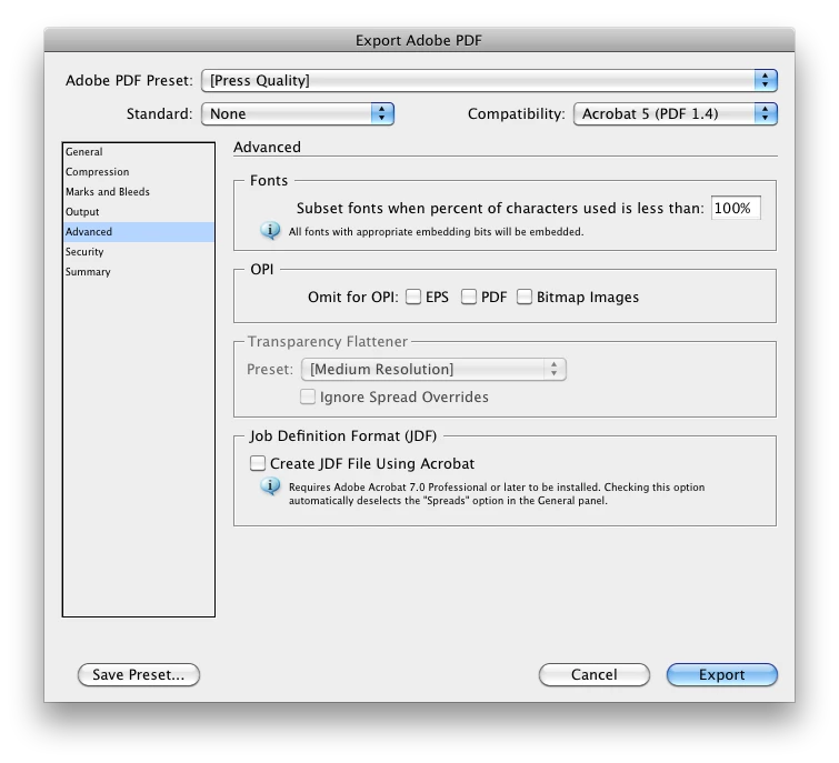

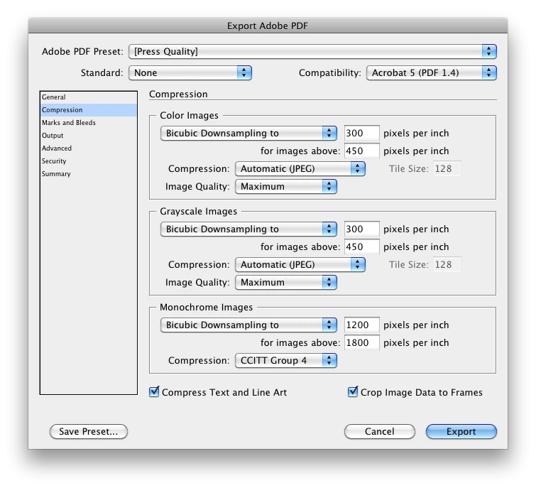

The second place you specify resolution is when you export a PDF. There are many resets that ship with InDesign, and you may have created some of your own or you may be given preset files by a printer. When you export a PDF you start with a preset and, if you wish, change any values you wish.
Below is the default for Press Ready. As you can see, it tells InDesign to resample image that are above 450 ppi to 300 ppi. Images below 450 ppi will remain the same.
Note that the Compatibility setting is Acrobat 5 (PDF 1.4). It so happens that that is the earliest version of the PDF format that supports transparency, which is why I am unable to select a Transparency Flattener Preset: There is no flattening. If I changed the Compatibility to Acrobat 4 (PDF 1.3) I could then select a Transparency Flattener Preset.

What was pointed out in the Image Resolution for the PDF - that will only affect images ABOVE a certain PPI.
As you can see it says
Downsample images to 300 ppi for images that are above 450 ppi.
So any images that are below 450 ppi will not be downsampled.
If you need all your images to be 300 ppi then change it to
Downsample to 300 ppi for images above 300ppi.

When you export Indesign won't touch anything below where you set the downscaling to, so if you set it to 300dpi your images will go through as you have them.
