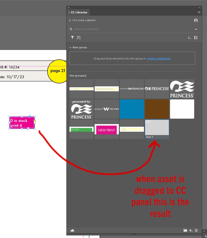

When I drag an asset to CC Library, I get a grey box with "text 1" - what am I doing wrong?
Correct answer Steve Werner
What you have done is to copy the text. If you want the frame's appearance copied, click the + at the bottom of  the CC Libraries panel, and from the menu, select "Graphic". It will show in the CC Library as a Graphic.
MdesignAZAuthor
November 1, 2023
That's it, thanks!
