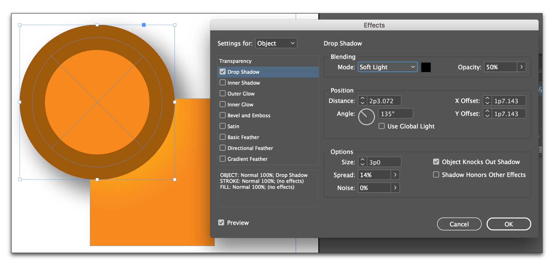

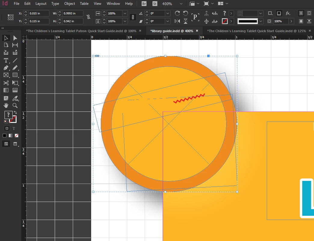

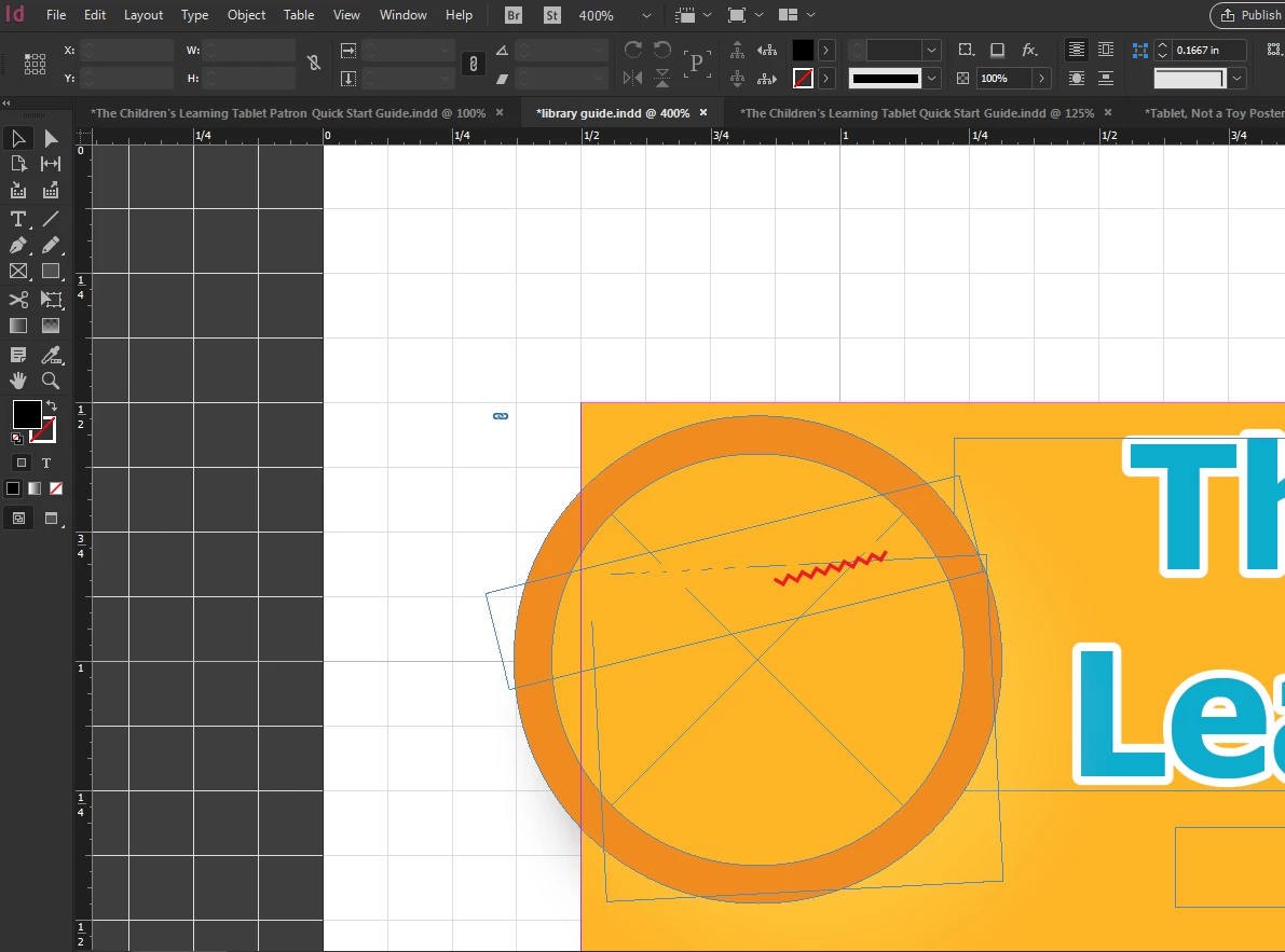

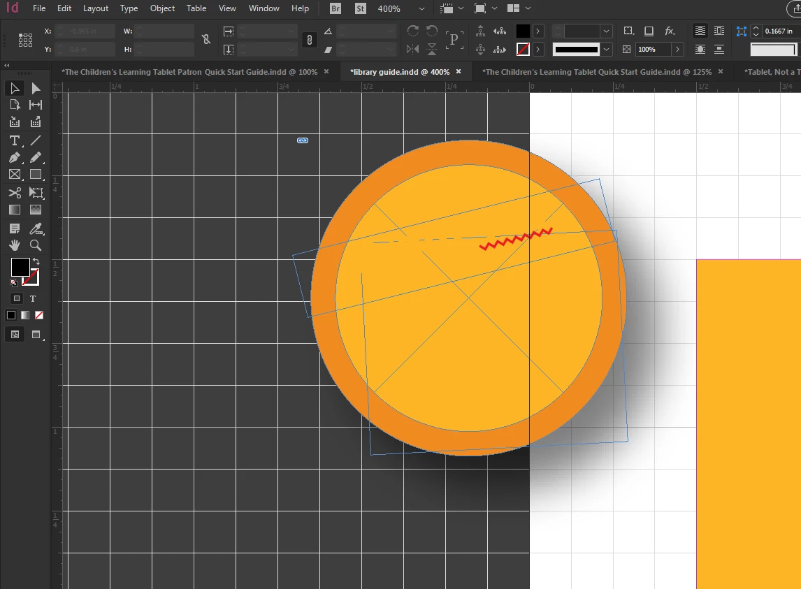

You see how it has a lovely drop shadow? Isn't that just the bee's knees? But wait... what's this?!
The button has been moved in front of another object... but where is it's lovely drop shadow? It's just disappeared! I didn't do it... promise!
Oh look at that!
It's hiding behind the other object...... WTH?!?! !%^#*&$
I've made sure that the button is arranged to the front and the other object all the way to the back.

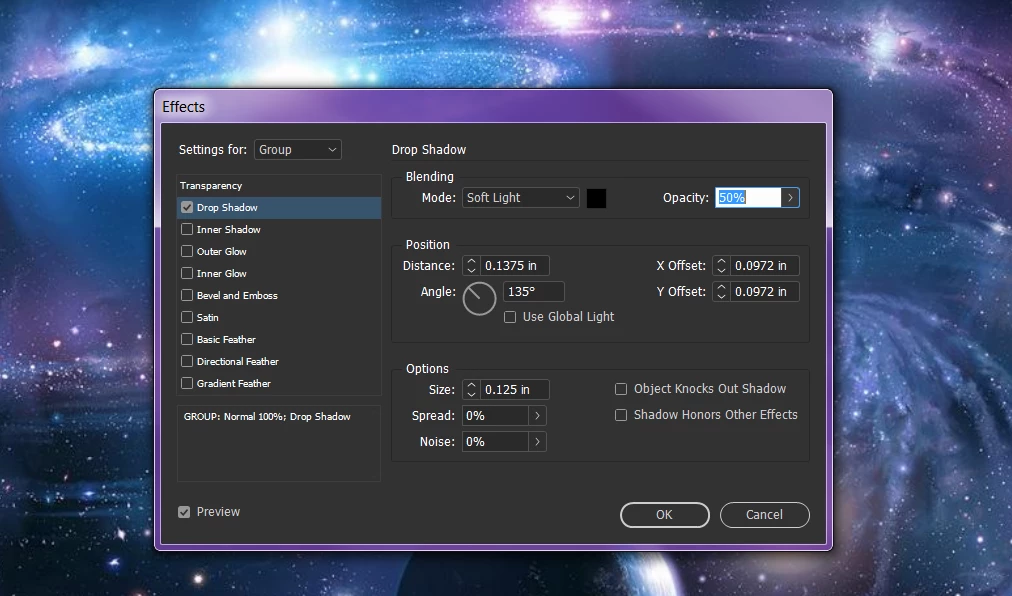

Here are my settings...
What am I doing wrong?!
Correct answer Barb Binder
It's because you are using the Soft Light blending mode. Drop Shadows are typically set to Multiply. Mine is brighter than yours, but I can see yours when I look closely.
Multiply:
Soft Light:
