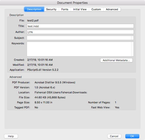

The file you shared was created by Distiller, so you must have used the Print dialog rather than File>Export using the Output settings I posted in #8.

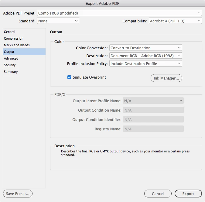

Also if you try my Export settings make sure the Advanced tab’s Transparency Flattener is set to [High Resolution]

You can replicate the JPEG flattening on a PDF export by setting the Export Output tab like this—composite printers typically do better with RGB color. Standard None, Compatibility Acrobat 4, Convert to Destination to Document RGB, Simulate Overprint checked, Include Profile

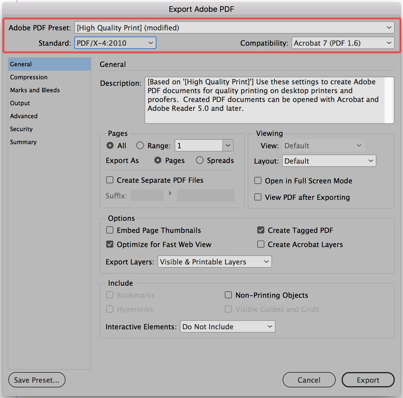

In your Export Adobe PDF dialog window try using the High Quality Preset with the PDF/X4 Standard.
