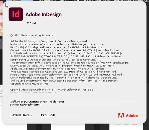

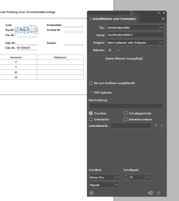

I am using the version shown in the screenshot. Unfortunately, I do not have the option to test another version. Attached is a screenshot of the button settings. I can provide you with the CSV file, the PDF, and the InDesign document. Here is the link to the files.
By @andre_5823
You can install InDesign 2025 (20.x) from the Creative Cloud app - only make sure to uncheck the option to remove older versions so that you install InDesign 2025 in addition to your existing InDesign 2024.
