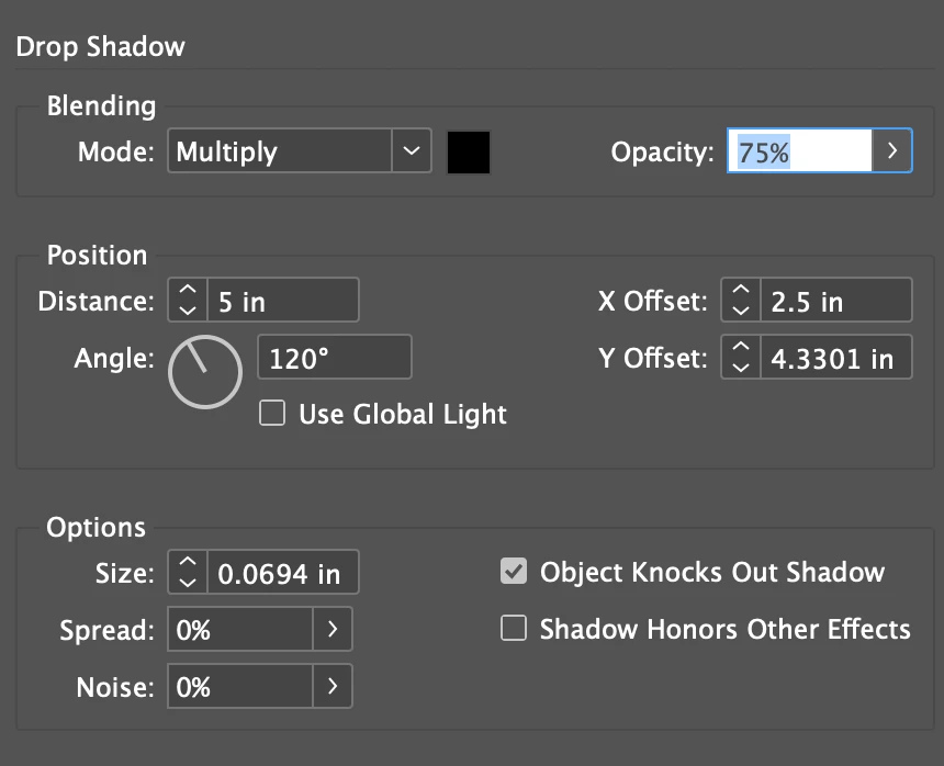

Dropshadow > Size is limited to 0-144 points within scripting but manual can be 0-1000 points
My understanding is indesign dropshadow effect needs to be updated for the option: size within the dropshadow panel to be able to accept 0 - 1000 points for scripts. You can input higher numbers within the size by doing it manually but not with scripts for whatever reason. It will only accepts 0-144 point or 2 inches within the code.
  1. Indesign CC 2025
  2. Run the attached script a 100 in height image and you'll get the error.
  3. On the dropshadow applied to have the distance 5.0 in and size 5.0
  4. Distance: 5.0 in and Size: 0.0694 in
  5. Script attached.

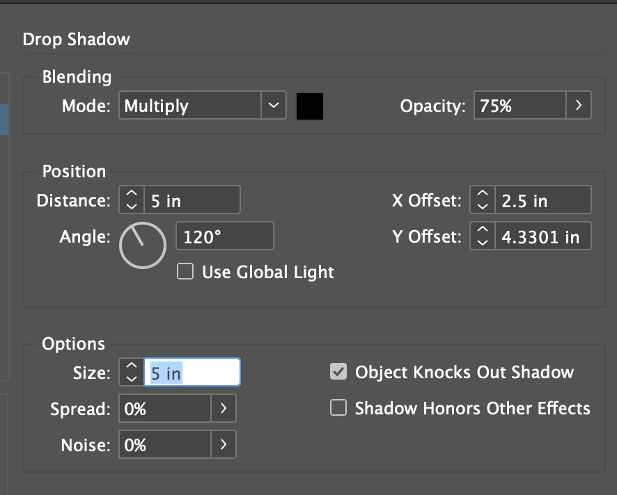

I have a script to automatically apply dropshadows and we have a formula where we take the height of the image and multiply that by 5% which gets placed in the Distance and Size. This works for smaller images but when there are larger images the number it puts into the distance works but the size seems to be limited to 2 inches. But if I do it manually it can go up to 13.8889″
for the size
I get this error: ERROR in applyDropShadow: Error: Invalid value for set property ‘size’. Expected Unit (0 - 144 points), but received “5.0 in”. 13.8889 in = 1000 points

Hi @donovang64683985, yes there seems to be an arbitrary limit to the size property of the dropShadowSetting.
From the documentation:
> The radius (in pixels) of the blur applied to the drop shadow. (Range depends on the unit type. For points: 0 to 144; for picas: 0p0 to 12p0; for inches: 0 to 2; for mm: 0 to 50.08; for cm: 0 to 5.08; for ciceros: 0c0 to 11c3.128.)
When I tested it seemed to simply ignore values greater than 144 (pts), using this code:
app.scriptPreferences.measurementUnit = MeasurementUnits.POINTS;
var doc = app.activeDocument,
    item = doc.selection[0];
item.transparencySettings.dropShadowSettings.properties = {
    mode: ShadowMode.DROP,
    angle: 120,
    distance: 1000,
    size: 1000, // this is out-of-bounds apparently
    opacity: 35,
    noise: 0,
    xOffset: 0,
    yOffset: 0,
    spread: 0,
That doesn't help much I know, but at least it agrees with your observation.
- Mark
