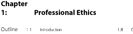

We have just upgraded from CS6 to CC 2018 and we have an issue with our ebooks. They worked fine in CS6 but now the Chapter headings are splitting across two lines.

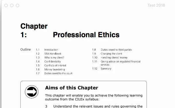

First, as you can see, I, too, see the title breaking lines. Here's your EPUB in iBooks, but it happens in all ereaders.

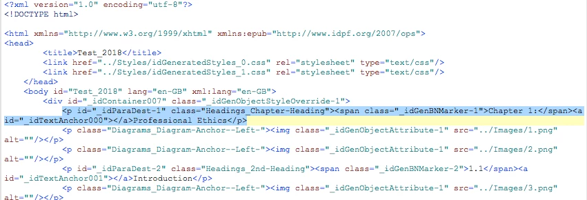

In the HTML of the chapter, "Chapter 1:" is wrapped in a SPAN tag with the class of "_idGenBNMarker-1", as you can see in the HTML code of the chapter file below.

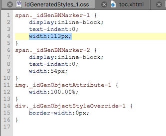

In the CSS, that class of text is defined as being only 113 pixels wide, which is what forces the rest of the line to wrap after "<span class="_idGenBNMarker-1">Chapter 1:</span>".
Removing the above highlighted CSS attribute completely fixes your title wrapping issue.

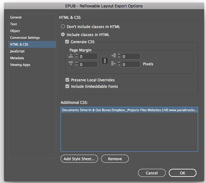

1. Your EPUB includes two style sheets. When exporting to EPUB Reflowable, do you have any external CSS stylesheets set to load from the Additional CSS area on the HTML & CSS pane (as in the image below)?

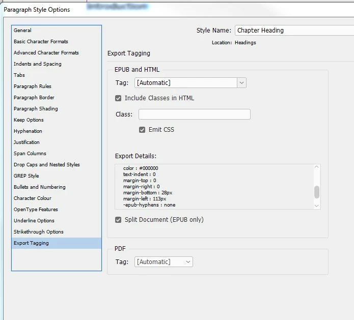

I have tried all the suggestions you mention but nothing works. I am attaching a screen print of the export tagging options in the paragraph style that are automatically generated and it mentions the 113px but I do not know where to change this.
We are really grateful for your time in assisting with this. I would just reiterate this is exactly the same paragraph style that worked perfectly in CS6, we only have the problem since upgrading to CC. Has there been a change between the two versions that could have created this problem?

Hi. It's August of 2020, and I have just come upon this same problem as the OP: _idGenBNMarker-1 -- actually, in my CSS, ID generated -1, -2, and -3 versions for (respectively) the chapter number, the first figure (they begin afresh each chapter), and succeeding figures.
The only solution I have come upon is to use an editor (Calibre or Sigil have been recommended, but I imagine Dreamweaver would work) and remove the width:XXpx specification from the span._idGenBNMarker-X in the CSS generated by Indesign. (Another poster has tried changing the width number and apparently that did not work for him; I just deleted it altogether.) I have also tried removing the character specification from Bullets and Numbering (the earlier poster was right; it wasn't needed), but that didn't make a dent in _idGenBNMarker-1, -2, or -3. Nor do I use GREP in my styles. ID still created -1, -2, and -3.
It is possible that a coding solution is achievable from the tag specification on both paragraph style and character style... but I don't know what that solution is, and haven't experimented. I am using the default CSS that ID generates -- and only that CSS. I suppose I could roll my own CSS so that it cascades over the _idGenBNMarker created by ID... but have not.  At this point, for me, the brute-force solution is to edit the default CSS and remove the width spec. It came from somewhere, it had to -- but I don't see it in my paragraph styles or character styles, and the actual px number seems to vary with each regeneration of the file (142, 136, etc.). Just a guess, but it's probably something in the programming that generates the CSS -- and it's been around for several years, now.

  1. Does this happen with every instance of Chapter headings, even a very short, one-word heading?
  2. What does the code look like?
  3. In what application are you viewing the EPUB when you see the title broken like that?
denisen35942289
May 8, 2018
1. Yes every Chapter heading regardless of length.
2. We have never needed to access the code before, could you please advise where I can find it?
3. We are viewing in Digital Editions.
