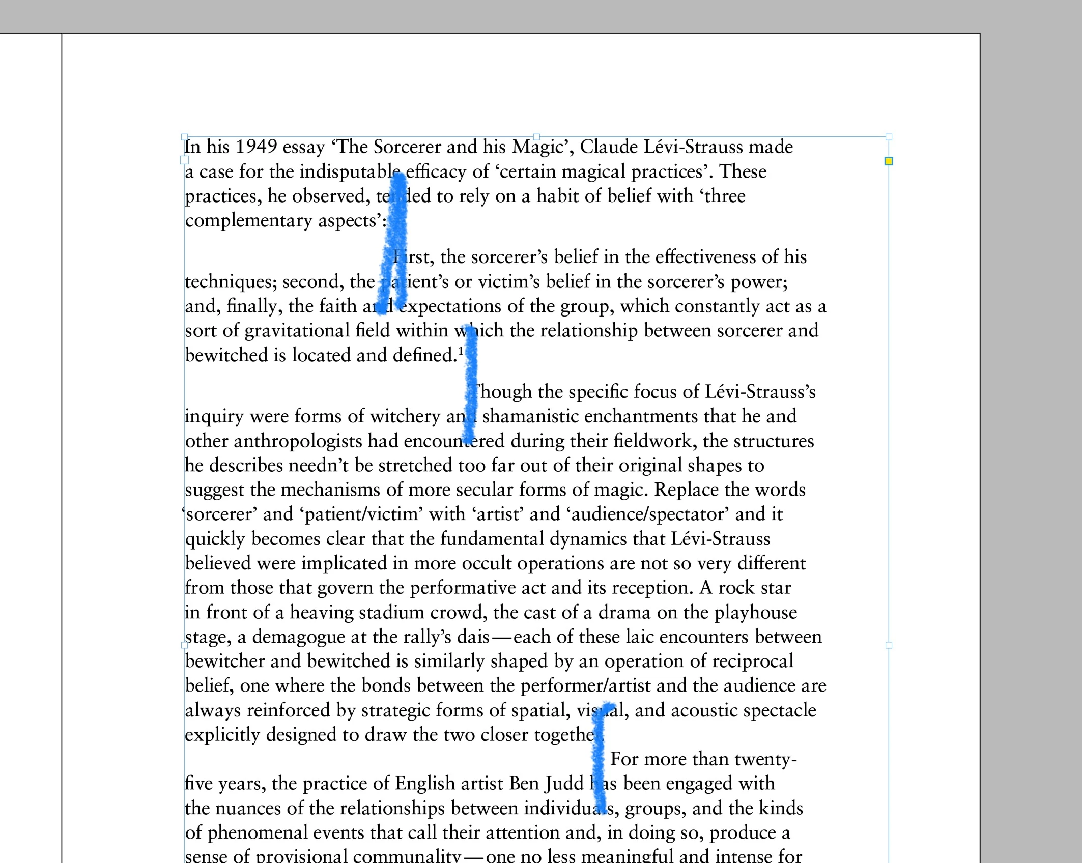

In this example below, my text has an existing 40pt left indent. The script has done its thing and left-indented to the end of the preceding line — but ADDING the existing indent to the newly calculated indent value... (you can see the text BEFORE running the scrip at the bottom...)

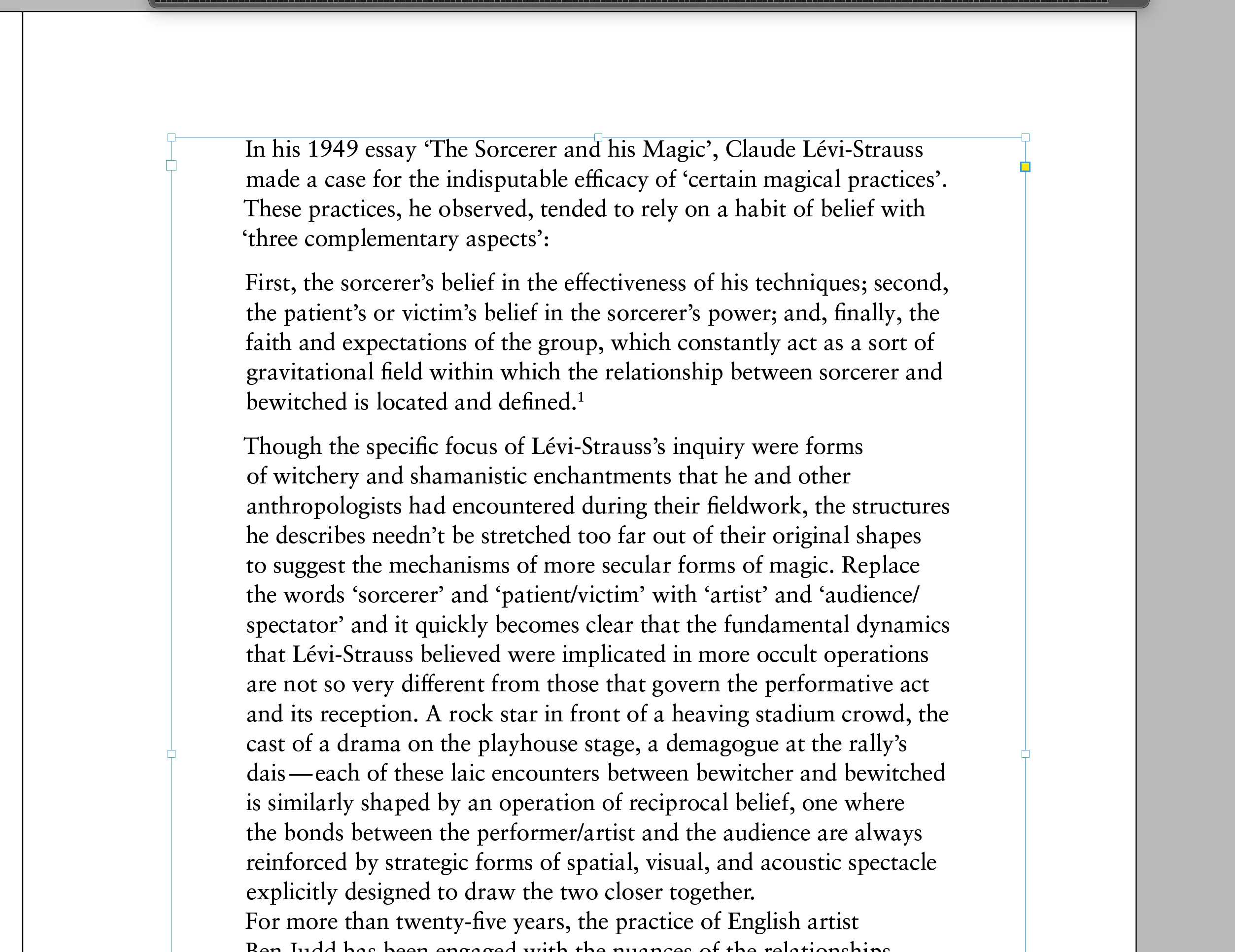

fig.1  below shows text frame after running the script — indents have been added that also include the 40pt left margin

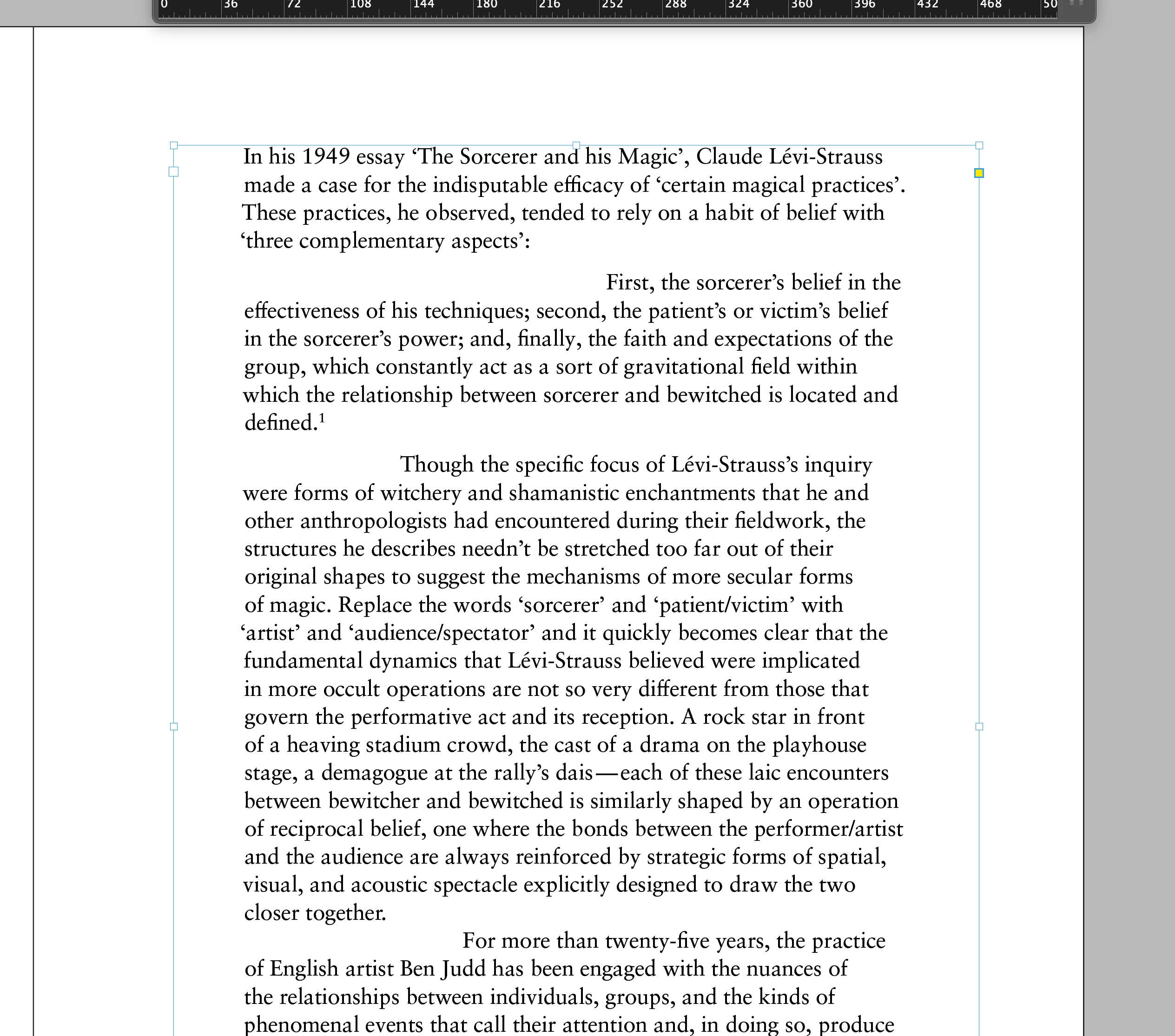

fig.2 below shows text frame beofre running the script —  with 40pt left margin

if I run the script on a text box with NO overall indent it works well... see below
 but if I run the script on a text box with pre-existing indents, the indent-to-end-of preceding paragraph 'overshoots' by the value of my global left indent...
I want to be able to set an overall left indent AND run the indenting script... does that make sense?
