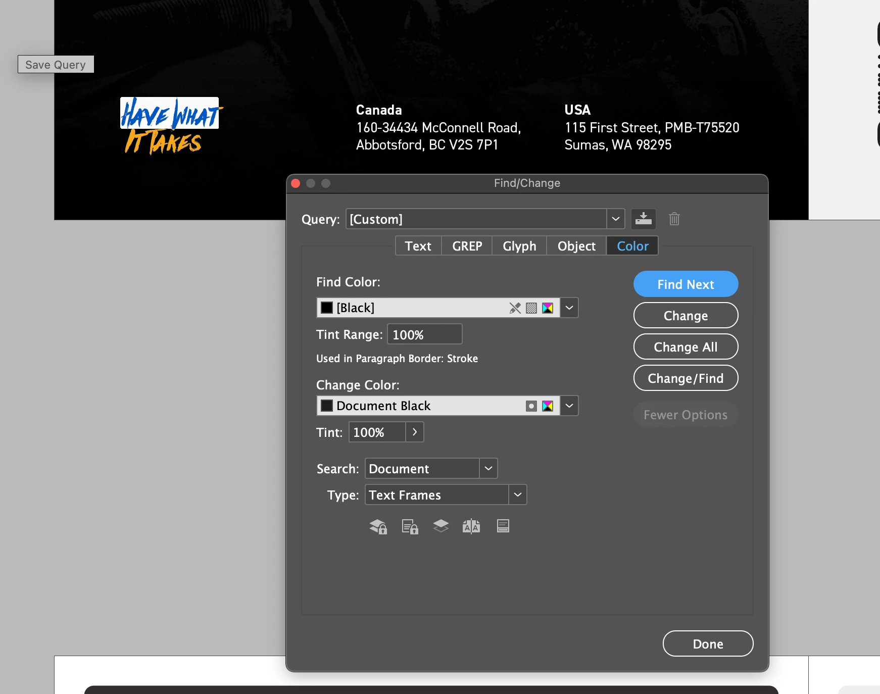

Hello there, I am trying to change [Black] in my document to a new swatch I created and normally, I'd go to Edit > Find/Change and do my thing. But this time, when I am searching for [Black] in my document, so I can change it, the dialogue box is finding pretty much every colour BUT the black in my document.
Using the screen shot, you can see that what it found isn't [Black] but a completly different swatch in the document.
What am I doing wrong?
Thanks!

First of all, thanks everyone who took the time to chime in. I really appriciate it. The problem for me came down to user error and preconceived expectations in how I should be searching for certain colours.
Like what some of you have mentioned, it was the "used in" that was causing the confusion for me. I was looking for 100% [Black] and when I kept clicking Find Next, it was finding things like, "Paragraph Border: Stroke" which isn't actually orange - which is what I thought.
In the end, I clicked "change all" and it did what I wanted and needed.
Thanks again. This is outside how I normally use Id.

I don't think I understand the problem.
In your screenshot, I see "Find Color" = [Black] and "Change Color" = Document Black.
So you are searching for [Black] and changing it to Document Black in text frames in your document.

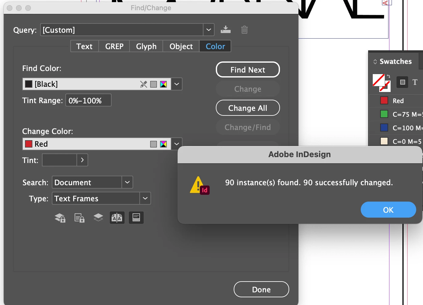

My test: (MacBook Pro, OS 13.7.4 Ventura, InDesign 20.1)
Find Color = [Black], Change Color = Red
All of the text in my document was changed to Red
Robert at ID-Tasker
Mar 6, 2025 12:18 AM UTC
@tonks_the_auror
You've missed "stroke".
tonks_the_auror
Mar 6, 2025 2:38 AM UTC
I used "change all" so it changed everything all at once. If I use "find next" it finds each element with [black] applied, one at a time, including "Used in Paragraph Border: Stroke"
Robert at ID-Tasker
Mar 5, 2025 11:43 PM UTC
@The Mosho
Stroke might be 0pt thick - but 99% is [Black] by default 😉
James Gifford—NitroPress
Mar 5, 2025 10:53 PM UTC
Many things get odd when you try to work with the various [default] styles and settings. I suspect this is a case where for whatever mysterious reasons, ID isn't seeing [Black] as, well, black.
I do note that your search seems to be for a color named Black (no brackets); in a quick test, searching for default [Black] is a different selection.
ETA: either my eyes or the screen shot changed - never mind on that last.
Peter Spier
Mar 5, 2025 7:14 PM UTC
I'm thinking this has to do with where it says Used In Paragraph Border: Stroke but I don't see anything like that coming up on my system.
What version of InDesign and OS are you using?
