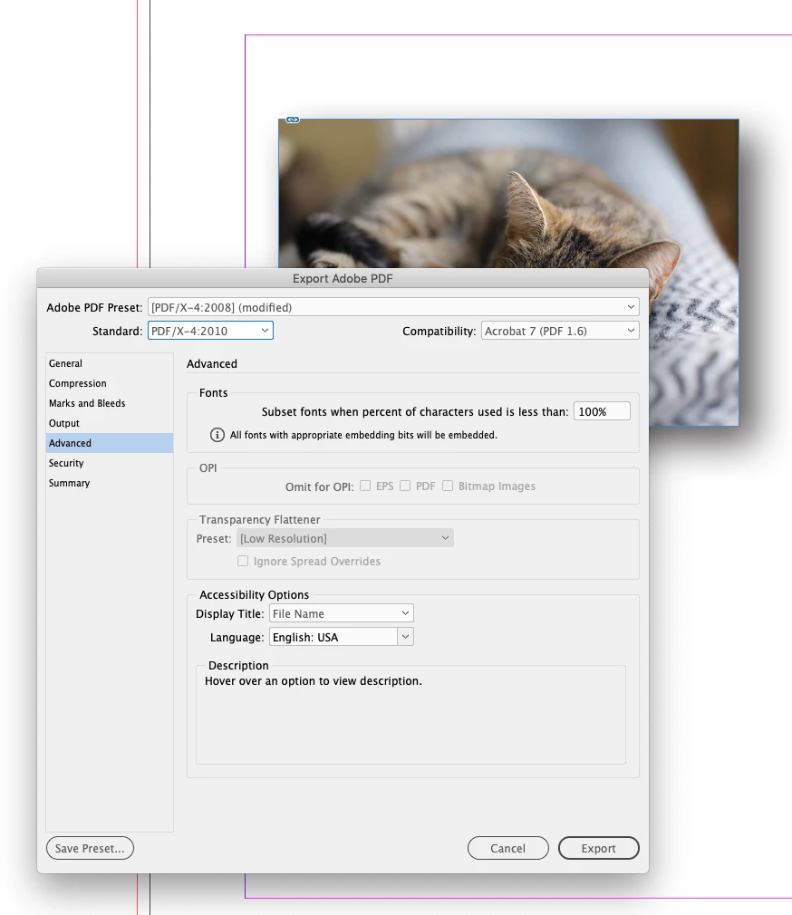

The Flattener preset would only affect an Effects’ resolution (i.e., a drop shadow), not the image’s output resolution. Here’s a PDF/X-1a with the Transparency Flattener is set to Low Resolution and the image with an Effective Resolution of 400pppi exports unchanged. So it sounds like the problem is something else maybe missing links, or the scaled image’s Effective Resolution is too low?:

Hi Bob, the Flattener preset’s affect on live transparency exports (X4) has come up before, unfortunately I think the thread is gone. But even with PDF/X-4 exports, the flattener preset affects effects like gradients and shadows—the grayed out default High Resolution normally is adequate. With either PDF/X-1a or PDF/X the flattener preset shouldn’t affect an image’s Effective Resolution when there’s no down sampling.
I can set the Compatibility to Acrobat 4, change the Flattener preset in Advanced, then set the Standard back to PDF/X-4 and the chosen preset will be used on the export. With AcrobatPro’s preflight I can get the resolution of the exported Effects. So this custom flattener I made passes a 250-450ppi resolution preflight in Acrobat:
