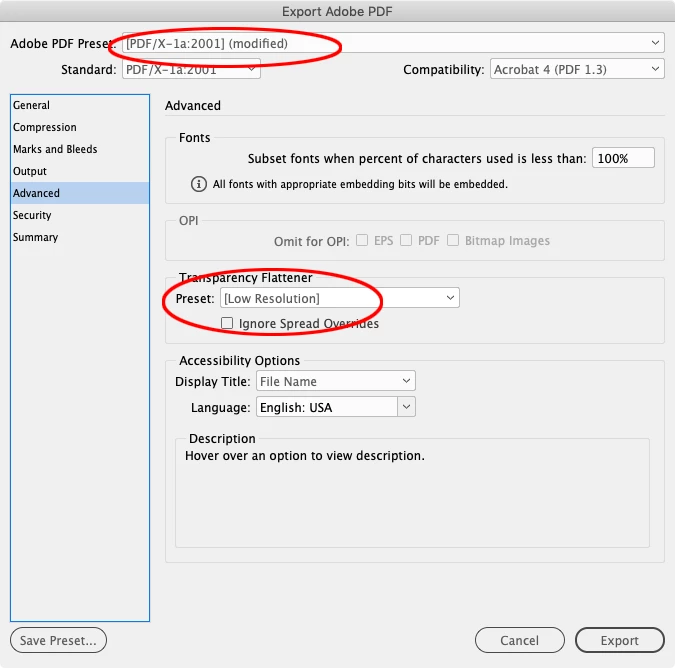

Is Edit > Transparency Flattener Preset… broken in InDesign 2021? I can’t get any setting besides [Low Resolution] to stick, nor custom settings. Exporting compatibility Acrobat 4/PDF 1.3 (requested from vendor printers) produces low-resolution flattened images that I have to up-sample in Photoshop. Have tried everything. Used to work. Others have posted outside ASC that custom settings will save won’t stick either when applied.

The Flattener preset would only affect an Effects’ resolution (i.e., a drop shadow), not the image’s output resolution. Here’s a PDF/X-1a with the Transparency Flattener is set to Low Resolution and the image with an Effective Resolution of 400pppi exports unchanged. So it sounds like the problem is something else maybe missing links, or the scaled image’s Effective Resolution is too low?:

I’m not seeing that. If I create and set a custom flattener in the PDF/X-1a Advanced tab it’s sticky for the next export.
Well, I appreciate all your time on this. Unfortunately, I need resolutions that don’t trigger Agfa to reject. I’ve tried  your X4HiResFlattener.joboptions (that default to your HiResGradients.flst in the Advanced tab), I’ve used my vendor’s Acrobat 4/PDF 1.3 joboptions (and then modified using your HiResGradients.flst in the Advanced tab). I’ve created my own .flst file setting the Gradient/Mesh resolution to 1200 ppi … “every which way” still produces some flattening at only at 125–175 ppi which Agfa doesn not like. I will just have to continue fixing the PDFs after the fact, or pre-flatten my object effects by exporting them as images out of InDesign. I really don’t see anything else to do. This may not be a “bug’ according to Uwe, but they should delete the Edit > TFPresets… out of the menus since it doesn’t do anything, It did work once upon a time. And using the Advanced tab in InDesign File > Adobe PDF Presets (selecting a custom .flst) doesn’t catch everything.
