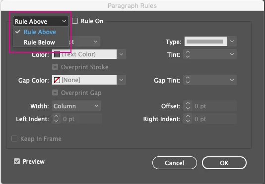

Apr 17, 2020 8:32 PM UTC
What happens when you click on the drop down menu and then select either Rule Above or Rule Below, which ever one is not checked (see screenshot)? It sounds like which ever one isn't showing when the dialog is opened may already be on.
Aug 15, 2025 1:50 PM UTC
THANK YOU!!!!!!! I though I was loosing my mind! This was the answer I needed!
