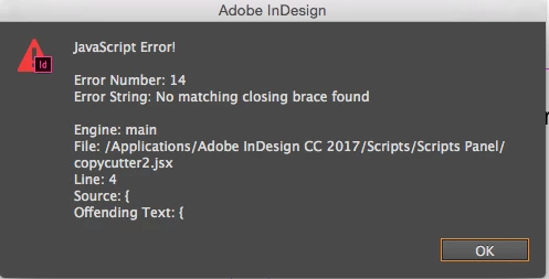

That new code gives me this error

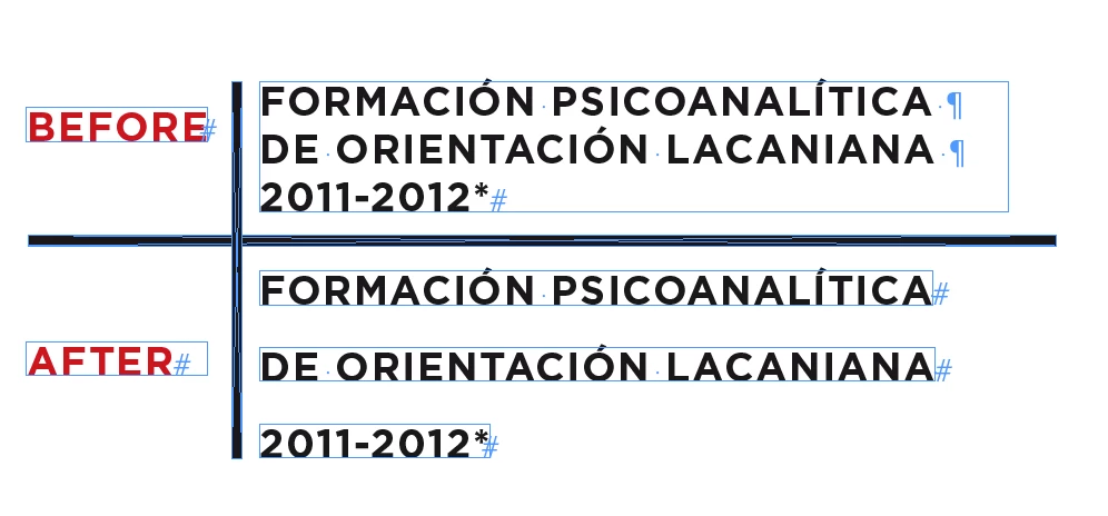

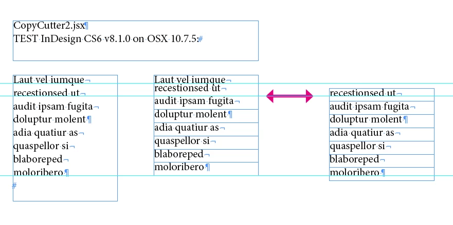

just tested your CopyCutter 2 script on a simple text frame with InDesign CS6, also CS5.5.
It is working—every single line is cut, but the second line is at a wrong vertical position.
All consecutive lines are ok if you see the relative distance to line two.
From left to right:
1. Original text frame
2. Script result on a duplicate of the frame showing the problem with the vertical positions.
3. The relative vertical distance from frame two to all the frames following is perfect.
Not so the distance from frame 1 to frame 2.
Depending what one likes to do with the single text frames after running the script this little flaw might be not relevant.
I did not look closer to the code why the shift happens.
But I would suggest, that before doing the dups of the lines
1. All baseline values of the original text frame could be read out
2. The text frames could be moved according to differences found in the old and new values of baseline
Fixed version CopyCutter 2.1 plus global undo added:
