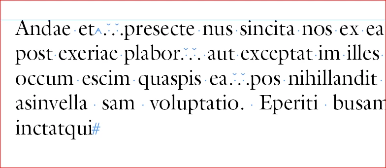

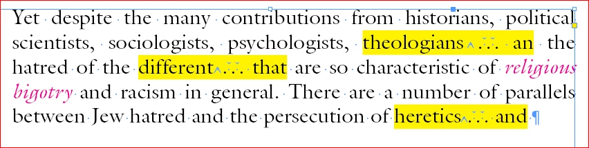

I have used below grep to find the ellipsis in my indesign file through script with various condition, such as three dots (...) with before space, after space and without space [my requirement], but greps are highlighted the text which is really not required. I have not included such condition but assigned greps running that also. please advice.
highlight('\\w+.?\\h? . . .\\h?.?\\w+');
highlight('\\w+.?\\h?. . . \\h?.?\\w+');
highlight('\\w+.?\\h?. . .\\h?.?\\w+');
Extra highlighted by script (which is not required):

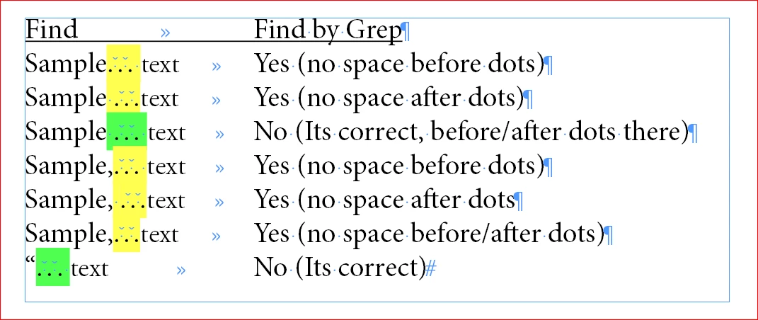

Exact expectation by greps (my requirement):

I tested with all above suggested greps but everything find everywhere. But I want to find exactly yellow highlighted condition only.

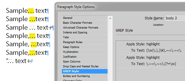

Well, these two regexes may be useful. Works in F/C panel, also can be used as a para style option:
[\w\.,]\K\.~<\.~<\.
\.~<\.~<\.(?=\w)
hasviAuthor
February 27, 2019
thanks for your swift reply and it works well.
