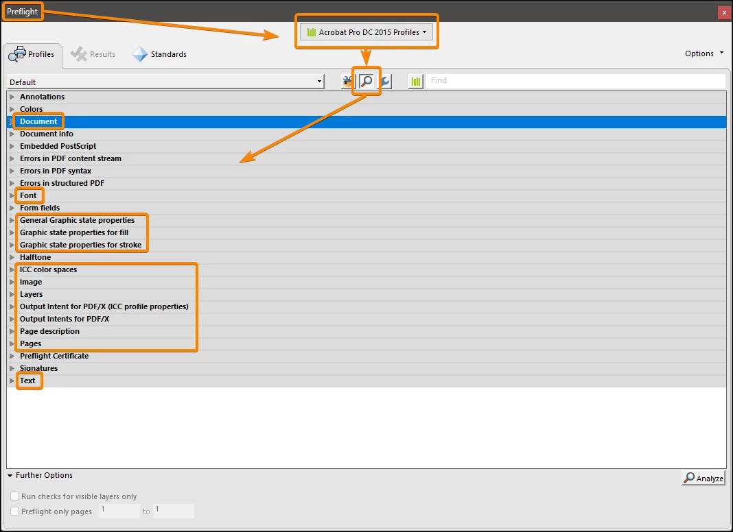

In your case, the most productive would be to create an Action (Action Wizard) in Acrobat Pro that would analyze the PDFs using the Preflight verification profiles. So you would quickly know if the PDF is compliant or not.

I can (and do) test any PDF against a set of spec's. (I don't use the Acrobat default preflights. I write my own.)

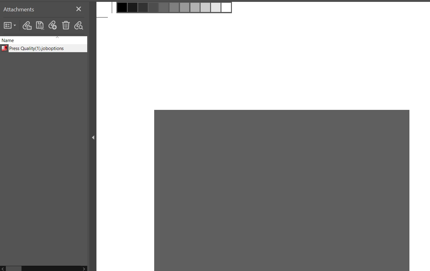

I've been playing around with Distiller and I turned on all the options etc.
Is this what you're after?
Just curious - as it's just attaching the .joboptions to the file.
