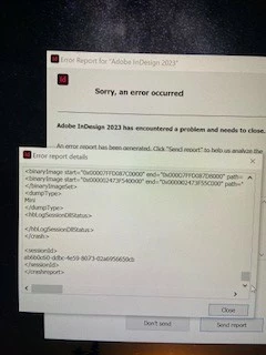

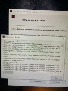

When I try to change the color of the first end note in this book this is the error I get and inDesign closes. There are a lot more lines between the top and the bottom. I just  brought in photos of the first and last lines. It appears to be the only endnote that gives me this problem. There are other endnotes that I have changed from black to red with no problem. I do have a lot of endnotes that I need to change the color. I've been doing it one by one because I haven't found a way to do it all at once. Perhaps someone can give me a simple way to make the change.
 I do get an error when I open inDesign that says "Document my be damaged. Do you want to open it anyway?" Are the two related or am I looking at a separate problem?
