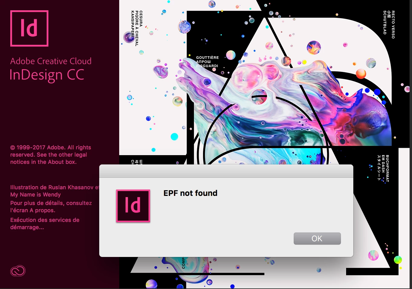

EPF not found alert - Indesign
I'm using indesign cc and when I open the app it says "EPF NOT FOUND" and thats it. I cant use it.
I tried uninstall it, and shut down my computer but nothing work.
Please help me,
Best,
Zoé

This method worked for me. I had installed a trial verions of Extensis and leftover plug-ins caused the issue.
  • Close all Adobe applications
  • Locate and remove the previous versions of the Extensis plug-ins from the following location(s):
    • Application/[Adobe Application Name]/Plug-ins/Extensions/ExtensisFont....

This reared its head for me with Photoshop Beta 2026 when Extensis Connect became Monotype Connect. In my Photoshop Beta application folder inside plugins → automate the update of now Monotype Connect added it’s new plugin called ConnectPS2026.plugin but did not remove the old one called ExtensisFontManagementPS2025.plugin. As soon as I trashed the old one, Photoshop Beta started up just fine.

An old thread I found said this is the result of a missing font auto-activation plug-in. If you are using a font management utility make sure that it is installed correctly. If it is installed correctly then check the font management's Plug-in manager to confirm that the correct InDesign plug-in is activated.

Are you using any font management plugins? Try removing any third party plugins from /Applications/Adobe InDesign CC 2018/Plug-Ins
Mar 4, 2020 9:10 PM UTC
Thanks! Had the same error show up and though it didn't affect launching and using Photoshop was still a nusance.
I got rid of Suitcase/Fusion and replaced it with Typeface 2. Had some left over associated files from Extensis and when I got rid of them per your instructions, the error was gone! Thanks again.
