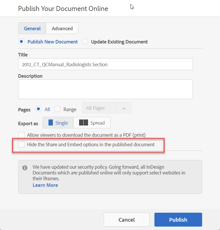

I have a query from a client on the adobe browser window that opens up when you publish an epub.
They're asking about the buttons at the bottom of the menu bar and if I can find out any information on what their purpose is. I think their capabilities are probably pretty limited, but wondered if anyone can help shine a light on their purpose please.  thanks in advance!
Please see attached screengrab for ref:
  1. Toggle Thumbnail – this doesn’t seem to serve much of a purpose since we just have one page – is it possible to remove this from the navigation bar?
  2. Share –  is it possible to disable this?
  3. Report Abuse – who does this reporting go to? Basically, what happens when you click that and is it possible to remove?
  4. Language – are you able to remove or disable this button?
  5. It appears that you are able to get an embed code when you use this button – is it possible to disable that?
BobLevine
April 4, 2022
Publish Online is NOT an epub and if you look at the export dialog your question will be answered:
April 4, 2022
Thanks Bob, yes got my terminology mixed up, Its a published interactive pdf.
So your replyanswers the question to one of the button queries, but I still wonder about the other buttons... If anyone has any ideas? thanks!
rayek.elfin
April 4, 2022
No, it is not possible to remove the other buttons (aside from the share and embed ones). Those are part an parcel of Adobe's online publishing platform.
