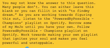

I am new to InDesign and EPUB creation so go easy on me for my lack of foundational knowledge.

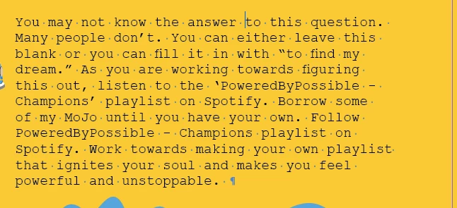

When I export my ebook to EPUB format, I am losing spaces between some words (but not all). For example, "fill it with" comes out as "fillitwith". I am using InDesign version 16.1.0.20 on a Mac. My font is Courier New. I checked the hidden characters and my spaces are shown there, but not in the EPUB conversion. Is my problem with my font selection?
