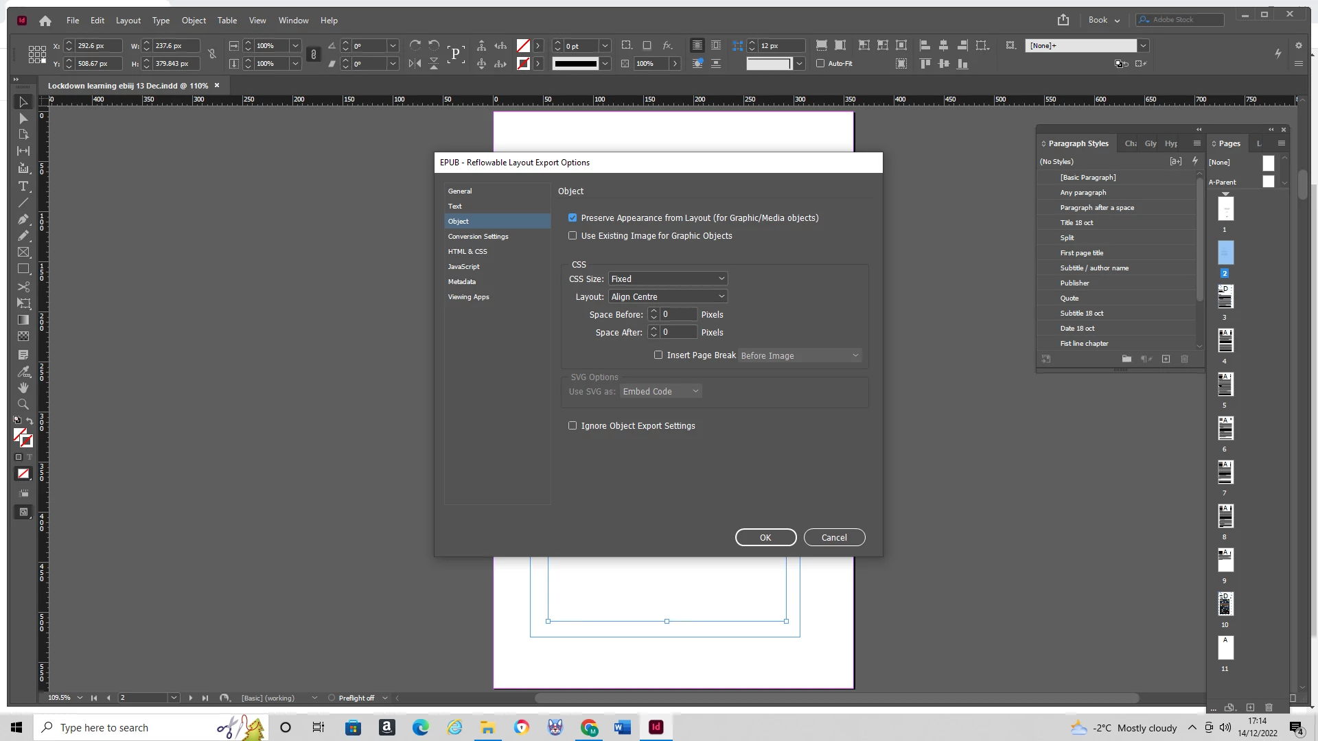

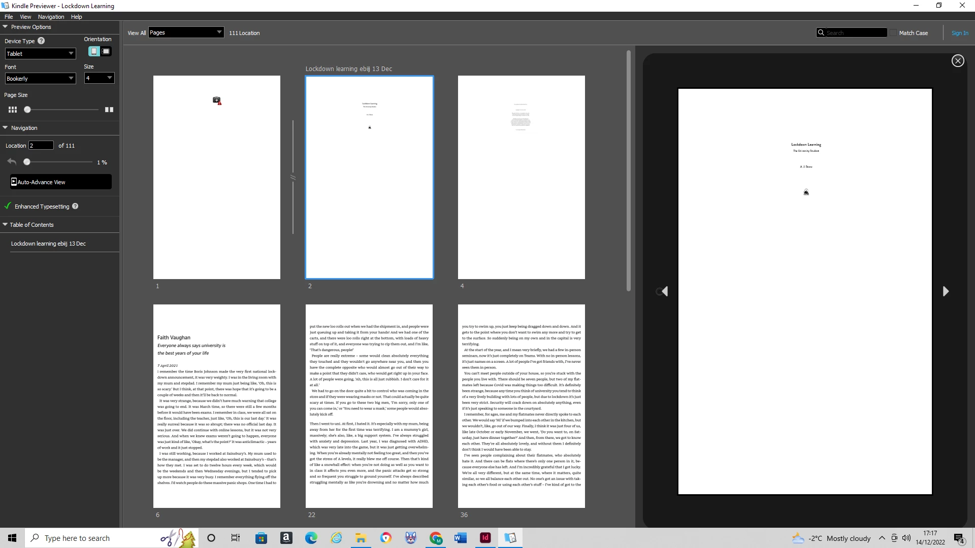

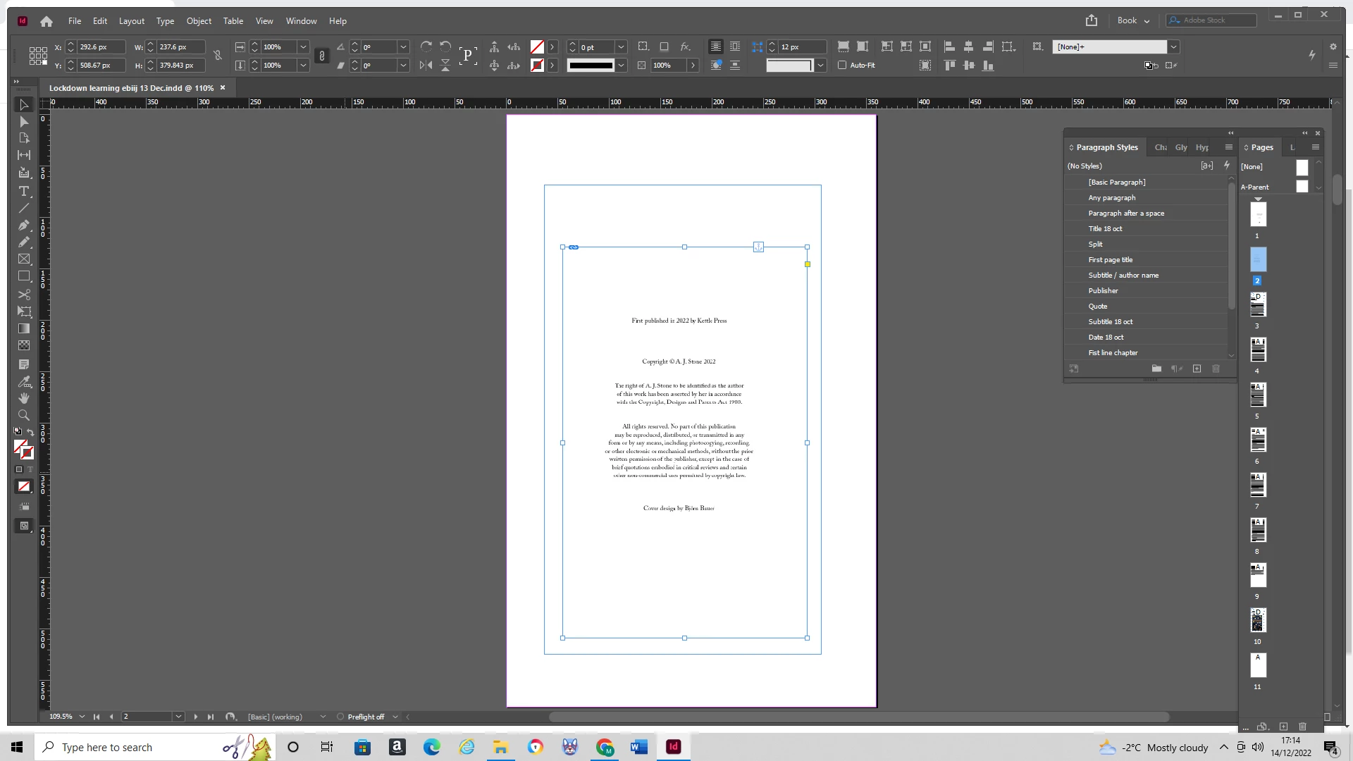

I'm exporting my book as an epub reflowable. How do I get the title and copyright page to take up a full page and fit to size according to whatever device people view the book on? I tried creating the title and copyright page as an image to get around this problem - don't know if this was a good idea? I've attached screenshots from InDesign to show what I'm trying to achieve, and then how they end up looking. Help would be appreciated. Thanks!

First of all, there are some things you can only "mostly" do in EPUB. As a liquid format dependent on the reader (much like web pages used to be), you have only loose control of how things will display to each user. That is, you have nothing like the control and precision you can get with print layouts.
To get a title and subtitle to show on the first page, make each one its own style. Position them as you like on that first page — centered, font size, spacing, etc.
Then add a large "below paragraph" spacing to the subtitle, half the page height or more. This will have the effect of forcing a page break — something reflowable EPUB does not quite have, as it doesn't have "pages" at all — and push whatever is next to the second display page.
But as for precisely filling the page, or being exactly in the center, or even being a completely predictable space down from the top... some of this can be done using CSS styling, but you can only approximate it from an ID export, and can't achieve all of it.
