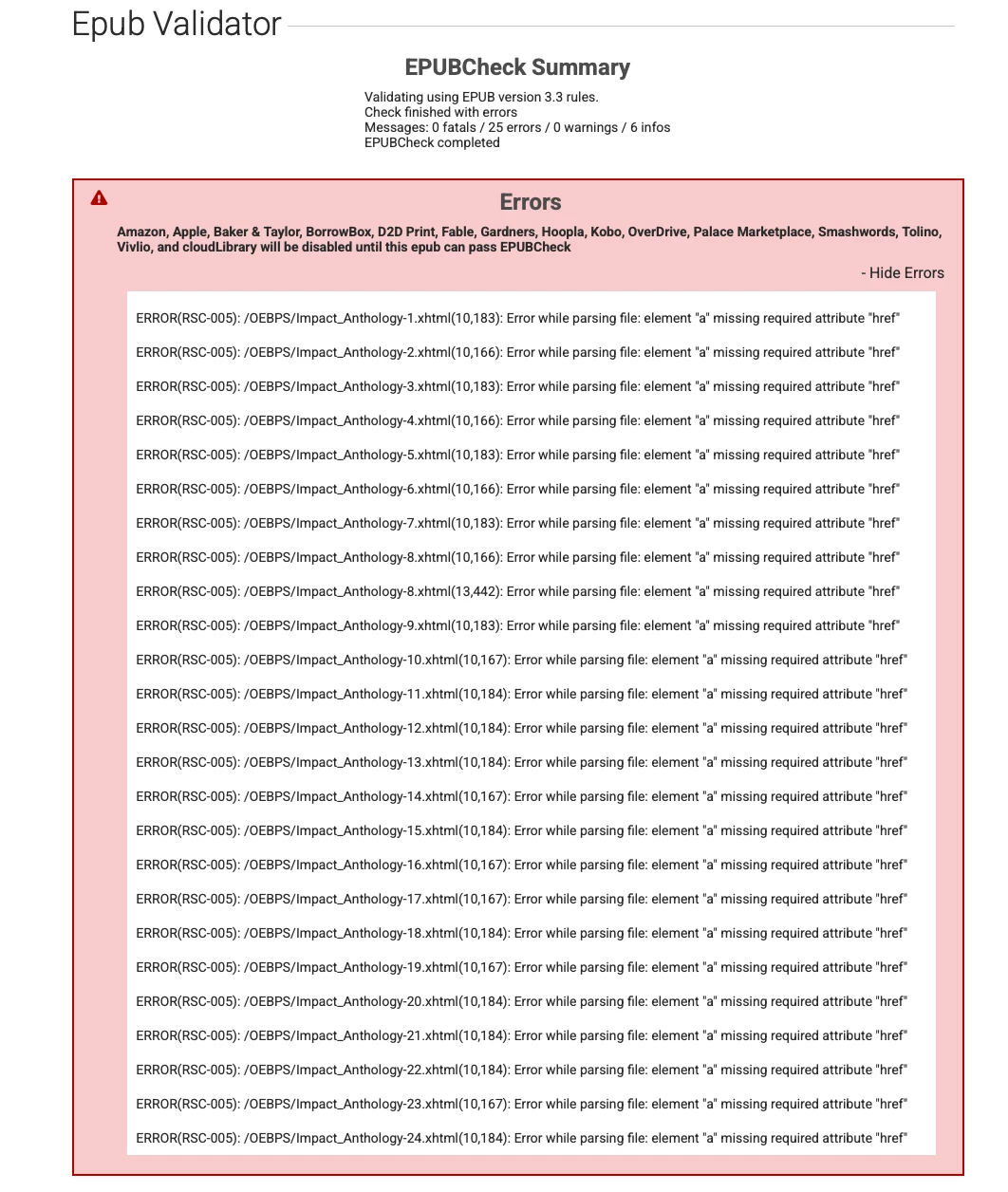

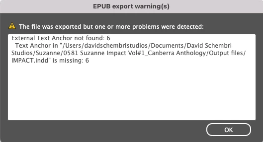

I have been successfully getting correct epub validation through Draft to Digital for a few yewars now, but now that's stopped. I have been having a lot of problems with an Indesign file and getting the attached errors.
I have been using eCanCrusher to expand my epub to elimate the 'encription' file (which use to cause errors in the past) then I would validate it, and it's good to go. Now, after that process, and even without it, I'm getting the attached errors. Can someone please provide some advice?
I don't know how to fix the 'Missing: 6' warning
and
The long list of 'href' errors I believe is related to incorrect hyperlinks? I have redone them =several times and there is no change.
I have also created a new fresh Indesign Document and tried again, but the same thing happens.
Is th eonly answer to start xcompletely again from scratch and rebuild the Indesign file from raw text, and try that?

Hi @dschembristudios,
Thanks for reaching out and sharing those screenshots.
We've seen a few similar reports recently in the community. Could you please go through this thread and confirm if the issue described there matches what you're seeing? Thread: Reflow 3.0 EPUB Export TOC RSC-005 Error (Bug since last update)
If it looks similar, try the suggestions shared in that post and let me know how it goes. I'll be happy to help further based on what you find.
Looking forward to your update.
Abhishek

dschembristudios
Aug 4, 2025 5:43 AM UTC
Hi Abhishek!
Thank you Thank you! Yes, updated to 20.5 and export3ed and passed validation first time. Awesome.
