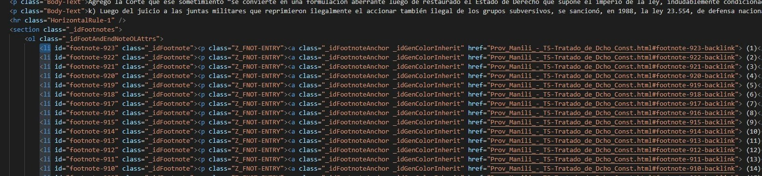

Hola, comunidad. Tengo un problema con indesign que se presnetó a partir de esta última actulización. AL exprotar el libro a formato e-pub o html, las notas a pie de página les pone estilo de lista y antes solo colocaba una etiqueta div. Esto ocasiona que hay que limpiar cada nota de forma manual. ¿Saben comos epuede arreglar esto sin la necesidad de retroceder a versiones anteriores del programa?

This change, which came in with v19.4 as nearly as I can tell (maybe 19.2), is a permanent revision of the EPUB export model. I don't know why or what drove the change, other than that it's in parallel with many other accessibiilty changes. I don't think it qualifies as a bug or a fault, and seems unlikely to be reverted. This may be a case where Adobe, in working with the EPUB accessibility groups, is actually ahead of the curve, and it's up to all the validators and so forth out there to catch up.
There are hints that different export options might use the <div> method, but I have not had time to do any A/B testing to see. I do know it passes EPUBcheck and works in the base readers... so any problems with other readers, processors, validators and working methods are likely to have to be fixed at those ends.
