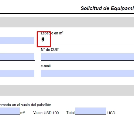

error en pdf interactivo
Hola, tengo el siguiente problema que no logro resolver: cuando exporto un pdf interactivo (form con cuadros de textos para rellenar) tengo el problema que el texto al escribir se pisa letra por letra, o sea, no escribe letras atras de letra sino que escribes y ves como va sumando letra por letra por una encima de la otra (como si fuera un bloque de una sola letra posible). es muy extraño el error.
E intentado cambiar la tipografia de inicio y con algun pdf me lo soluciona, pero con otros pdf no, sigue persistiendo el error.
pareciera ser un error de la tipografia que toma para el form.
alguno le ha sucedido?

What font did you use for the fields?

Hi @maxi_design,
Thank you for reaching out and explaining the issue. I understand how frustrating it must be to deal with text overlapping in your interactive PDFs.
To help us troubleshoot this further, could you please provide a bit more information?
- Which version of InDesign are you using?
- What operating system are you working on?
- Is this issue happening with just one specific file or with multiple PDFs? Would you mind sharing a screenshot showing the issue?
Sometimes, certain fonts can cause these issues, but knowing more about your setup will help us find a solution. Looking forward to your reply so we can get this resolved for you!
Thank you,
Abhishek Rao
Luke Jennings3
Aug 26, 2024 2:53 PM UTC
Are you using Acrobat or Adobe Reader to open the form? Are InDesign, Acrobat and Reader up to date? Try editing the form in Acrobat, delete the form field and re-create it.
