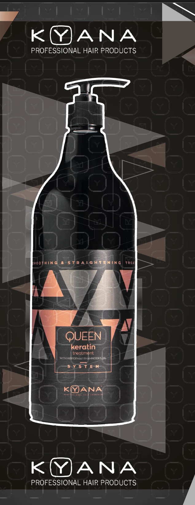

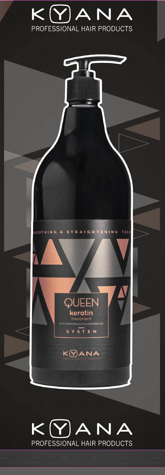

Every time I export my product catalog from InDesign, the images of the products in PNG format appear transparent. The background pattern shows through the bottles. This issue has only started recently. I don’t know what the problem is. Previously, InDesign never had issues with exporting.
What is the problem? Here are some example images showing how the output looks in InDesign and how it appears as a PDF.
inDesign:
exported PDF:

Sep 7, 2024 9:11 PM UTC
I have to export the inDesign file in PDF/X-1A because my printservice wants that. I didn't know that i can open PDF  with Photoshop?
I hope you get my issue right. In inDesign is the version it should look like, but when I'm exporting the file in PDF my pictures and the whole layer is transparent. You see the first layer "Background" shines through.
is there an export issue? And how can I fix this?
