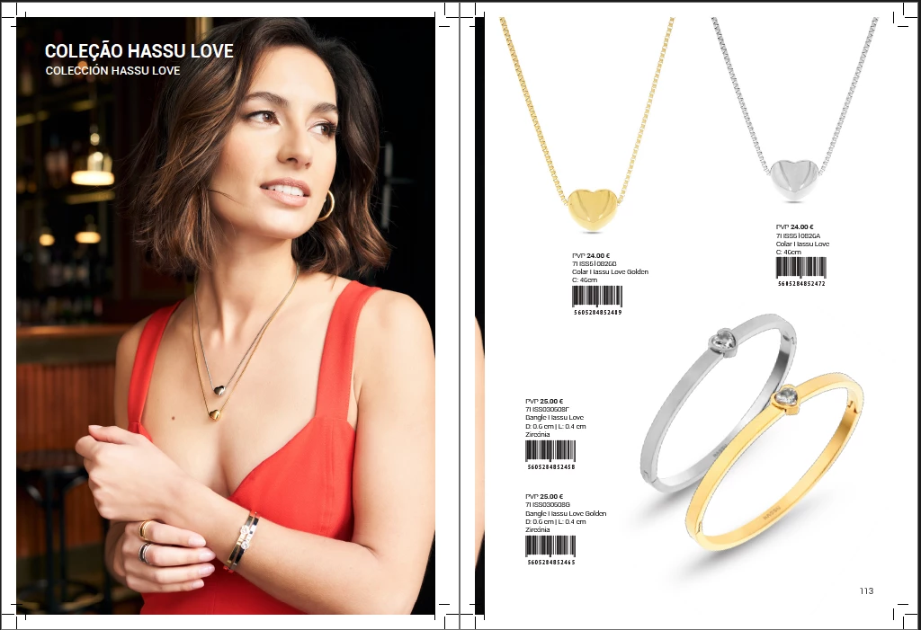

I have a urgent catalog that I need to export for printing. I've put in 5 mm bleeds and crop marks, however, the second pages take the image that's on the other page  and I assume that could be a problem  for the printing services to print and crop the catalog since wanted things could appear.

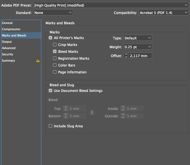

This is how i saved it:
this is how it turned out on pdf:

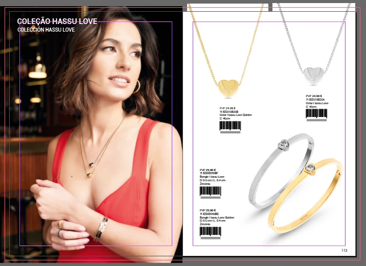

and  this is what my document looks like:
Why there is white margin? i have all the margin filled in with the photo.

Correct answer BobLevine
Set the inside bleed to zero

BobLevine
BobLevineCommunity ExpertCorrect answer
January 12, 2024
January 12, 2024
THANK YOU SO MUCH!
