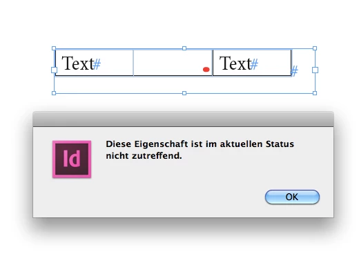

Here a case where the insertion point cannot show, because the cell is of fixed height and the point size of the text is too large.
From my German InDesign also showing the Story Editor window. "Übersatz" means "overflow" or "overset".
If I run the following snippet on that selection my German InDesign will answer with a German version of your error message:
"Diese Eigenschaft ist im aktuellen Status nicht zutreffend."

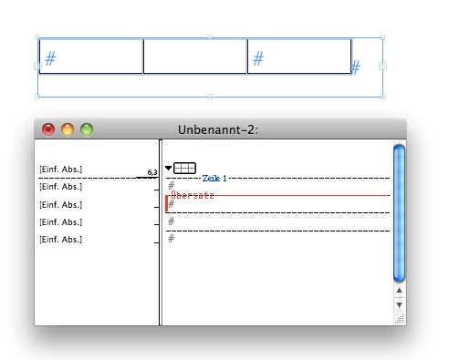

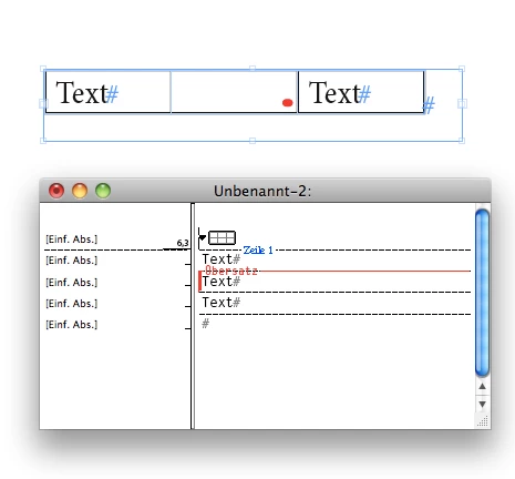

Maybe at first glance you will not see the "red dot" in the cell showing the cell overflows, because the contents is empty?
Like that:
Note: The end of story marker is also missing in the cell.
Because you cannot see the end of the story. And the culprit here is an insertion point that is formatted with 32 pt and cell is of fixed height.
Also look for other formatting in your table cell that would force overset cells.
