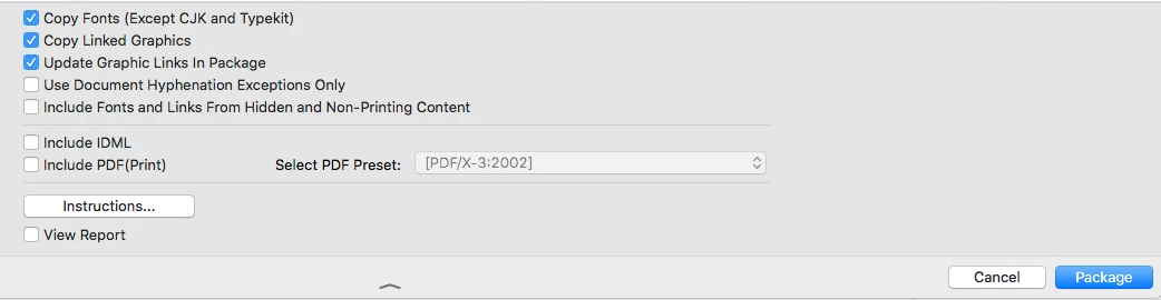

For archiving purposes you don't really need the PDF. When you package for an archive you can uncheck Include PDF

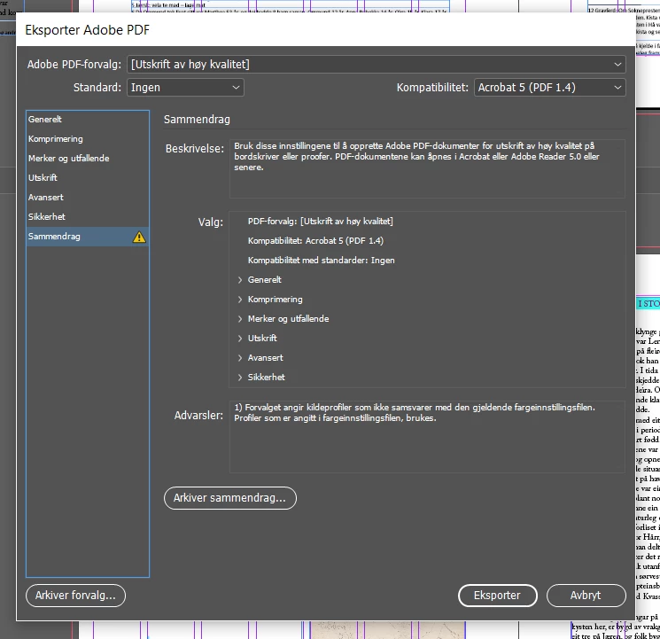

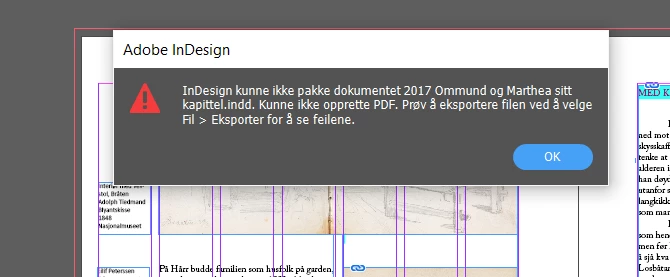

1. When I start the "Pakke" (packaging) I get this warning : InDesign couldnt pack the dokument (document name)... Could not make PDF. Try to export file to PDF to see the issues.

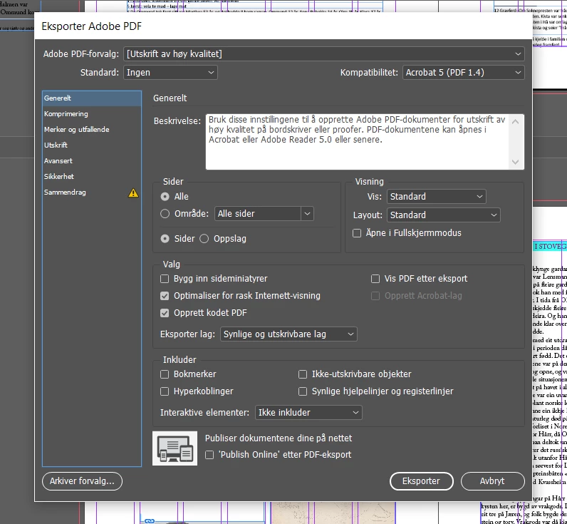

2. I export the same file to PDF and get this message in "Sammendrag" (yellow sign):
3. And when I open the "Sammendrag" (yellow sign) it says: the sentence I translated with Google translate
1) The preset sets source profiles that do not match the current color setting file. Profiles specified in the color settings file are used.
4.
Does this help to understand my question?

Is your printer asking for the PDF along with the Package? If not you could package without the PDF.

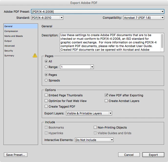

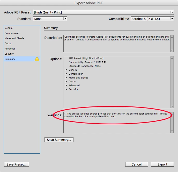

I see the PDF Export warning
1) The preset specifies source profiles that don't match the current color settings file. Profiles specified by the color settings file will be used.

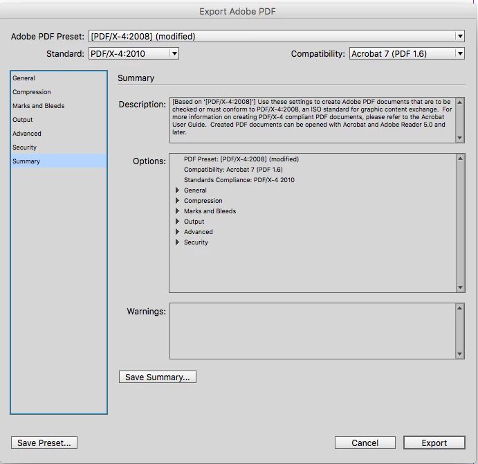

when I use one of the default presets—a preset in brackets such as [PDF/X-4:2008]. You can safely ignore the warning, but if you modify the preset in some way the warning will go away. Here I choose the [PDF/X-4:2008] preset, set the Standard to none and back to PDF/X-4 2010 again and the warning disappears in the modified preset:
Your layouts include placed RGB files, which is OK as long as your printer has agreed to make the conversion to CMYK for you at output. Usually when you are delivering layouts with RGB objects the PDF/X-4 preset should be used.

Are you seeing the warning during packaging or in the PDF Export dialog? Like this:
January 11, 2018
Hi Rob,
I guess it's the warning issued by preflight that "74 files in RGB color space are present".
That would be just a message, nothing serious, no problem. Some screenshots posted by Gjertrud would help to sort things out…
Uwe
