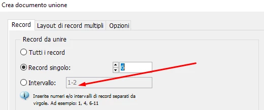

I found the problem, or at least a solution, with a relative path it works (and it saves on Documents).
What I'm still missing is
  • how to understand last recordNumber (Number of file rows) or the source of the data for the merge. In the script (and also AI sites) suggests to use DataMergePreference.recordRange but it's the range selected to merge, nothing regards last available
  • How to read a value associated to a merge field and a selected record
