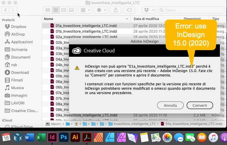

Good morning,
first of all, sorry english ...
I have the 2019 version of InDesign. I also downloaded the 2020 version (15.1 serious problems for the numbering of notes and the elements of the master pages, such as testatine… bug already reported by others). I uninstalled the 2020 version 15. to download the 15.0.3 version that "seems" to have no problems with the notes and headers. The problem, however, is this: I still want to open my documents with the 2019 version, because in the printing phase, and I don't want to have "loose errors" due to the 2020 version. Even if I open the documents with the 2019 version with which they have been created, I get an error saying that they were created with a later version and that to open them use 15.x or convert them. Because?
If I opened InDD 2019 and open the files from the menu or by dragging them into the application and, I repeat, the files were created with InDD 2019, why this error and I have to do the conversion?

I tried to open it from the menu and by dragging the file onto the InDesign 2019 icon! It's crazy error...

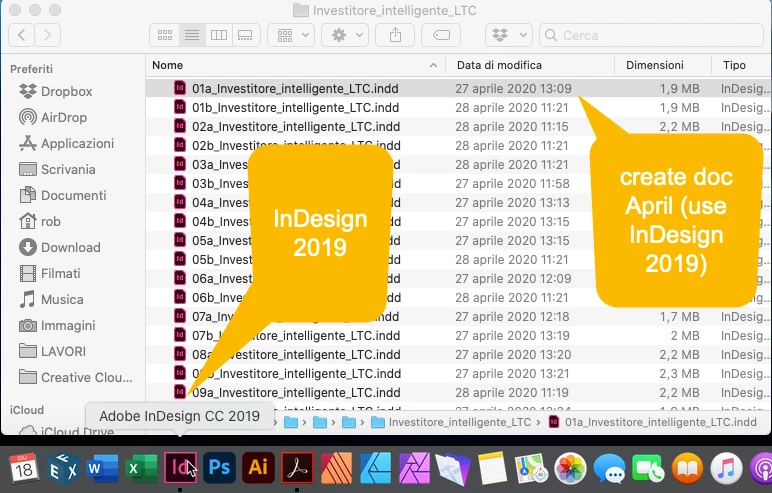

Ute LeoneAuthor
June 18, 2020
No, the files are not synchronized on the dropbox. On the MacBook I copied the test file today. The thing is, it happens with all the "old" backup files that I take from other disks.

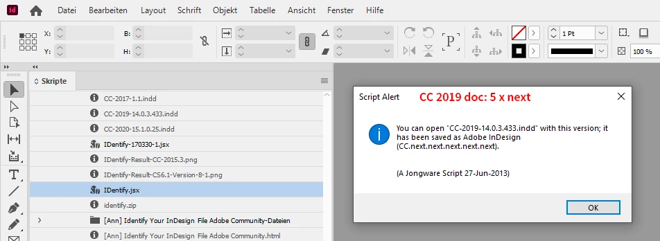

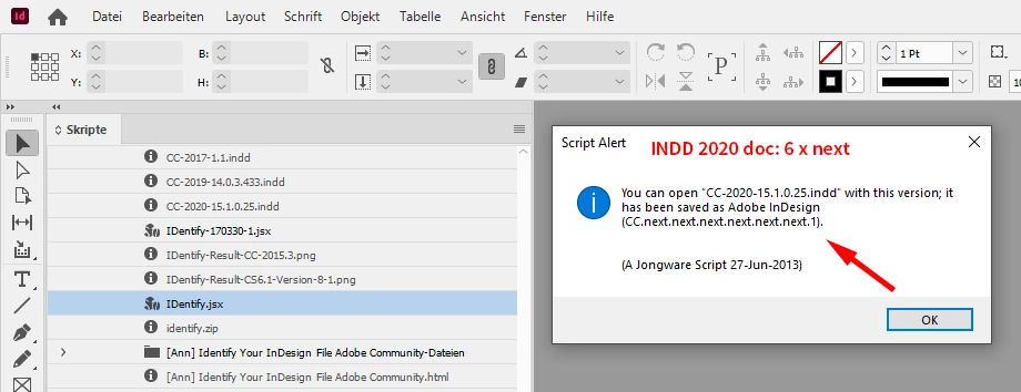

June 18, 2020
Well. I tested Jongware's script on a InDesign 2020 document vs a InDesign CC 2019 and had:
6 times "next" on the 2020 document and 5 times "next" on the CC 2019 document:
That result suggests that you tested a InDesign 2020 document on the one machine and a CC 2019 document on the other.
Note: Do not get confused by the next.1 in my result for InDesign 2020, my current version is 15.1.
So I would run Jongware's script on both of your machines.

June 18, 2020
Thanks for your intervention, but as I have already explained the files are native InDesing 2019 and never opened with the 2020 version. Look at the creation dates (of the file 27 or 28 April), they are prior to the release of the 2020 version...

June 18, 2020
Hi Ute,
don't think so.
Jongware's script gave you 6 times "next" after CC.
First CC was version 9.
Next was version 10
Next after that was version 11
Next after that was version 12
Next after that was version 13
Next after that was version 14
Next after that was version 15
So in effect, I'm not sure, but I think I'm right, the script says that the document was saved with version 15 which is InDesign 2020. Again: Make a document available and I will test with Werner's script that explicitely shows the right version number. And also all the versions the document was saved from start of creation to the last time.

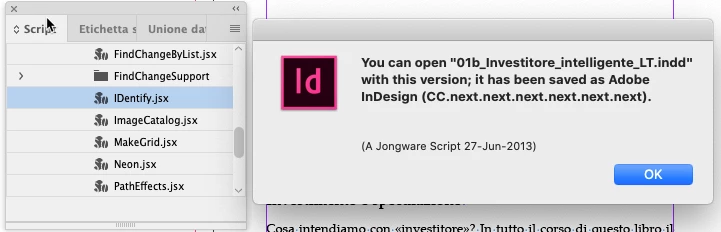

June 18, 2020
I launched the IDentity.jsx script: "in theory" I can open it. But if I really want to open it with InDesign 2019 (repeat: create file with InDD 2019), he asks me to convert ...
