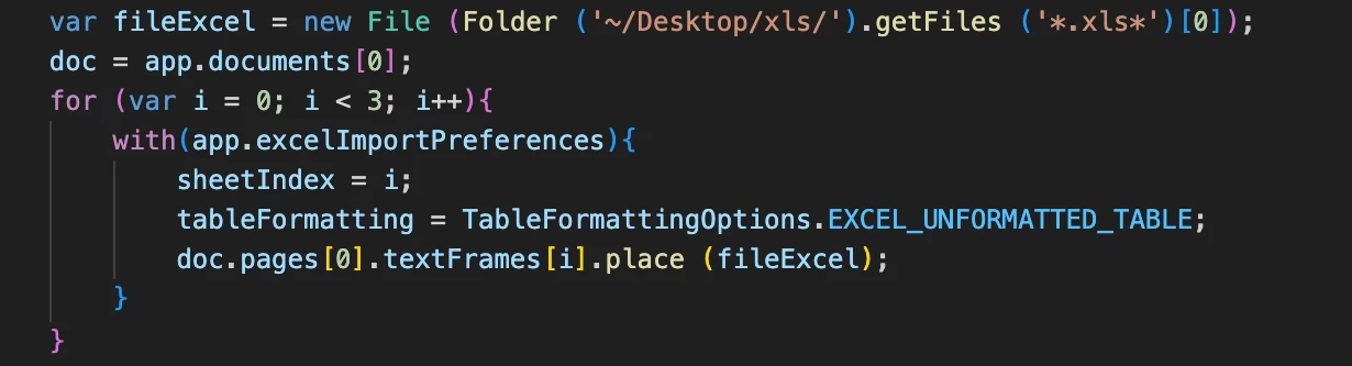

Hello there,
I'm wondering if anyone knows solution to this problem. I imported any Excel sheet other than the first sheet from a multisheet Excel having the "create links when importing text or spreadsheet" preference on. Then I made some changes to the imported sheet in the Excel program. Updating the link changes the source sheet to the first Excel sheet. Is this a bug or am I missing something? Many thanks in advance!
Cheers!
Funtom

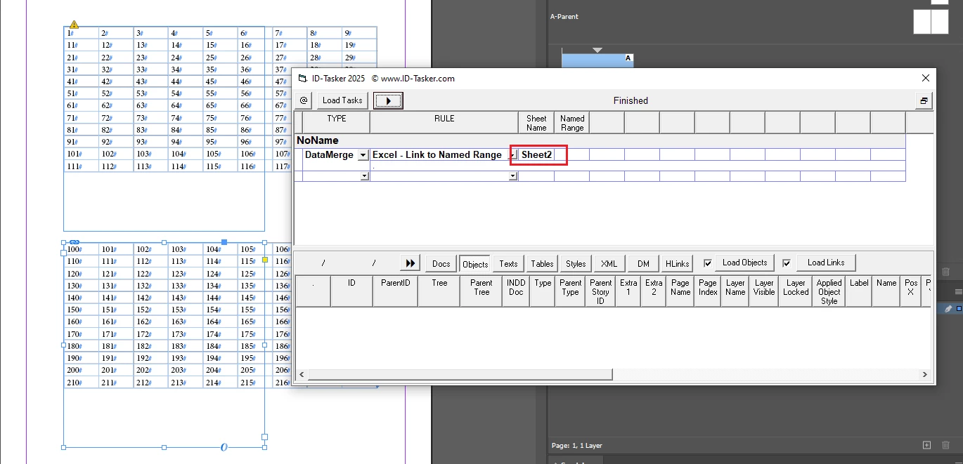

Robert at ID-Tasker
Jan 21, 2025 5:22 PM UTC
@Funtom
I've also checked linking to a whole sheet:
TOP - initial state - linking to the whole 2nd Sheet from my tool - red rectangle on the right.
BOTTOM - I've duplicated top TextFrame, edited linked XLSX file and then updated only this duplicated TextFrame - everything is as it should be.
(and also I've added new option to this linking rule - "Sheet Name" - which, of course, can work with other rules, that first populate NamedRegions from Excel file, so if there are references in the text to those named sheets / regions...)

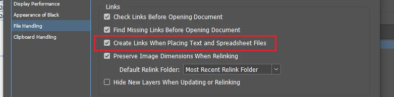

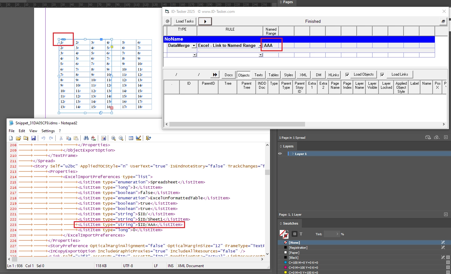

Robert at ID-Tasker
Jan 21, 2025 4:55 PM UTC
@Funtom
It works for me - including later update:
(this is a test so name of the XLSX file is hardcoded)
Unfortunately, problem is somewhere else - I can't set GeneralPreferences.CreateLinksOnContentPlace to TRUE from script ?!?! At lest in VB...
When set manually in the InDesign's UI - then it links Story to Excel file and when I update Excel file - it updates contents in InDesign perfectly fine - no change to first sheet.
Dave Creamer of IDEAS
Jan 21, 2025 5:02 PM UTC
@Robert at ID-Tasker Robert, when you say it works for you, are you referring a manual process or script-base process? It's already been established that the manual process works properly.
Robert at ID-Tasker
Jan 21, 2025 5:06 PM UTC
quote
By @Dave Creamer of IDEAS
As per screenshot, script-based process - I'm linking to the NamedRegion using my tool - no manual steps involved - beside setting manually to TRUE first:

FuntomAuthor
Jan 16, 2025 12:36 PM UTC
Hello Robert,
The files are new test files, Macintosh Sonoma 14.7.2, InDesign version 20.0.1. I've discovered that the problem is caused by an InDesign script placing the Excel. And yes, the subforum should be "Scripting".
