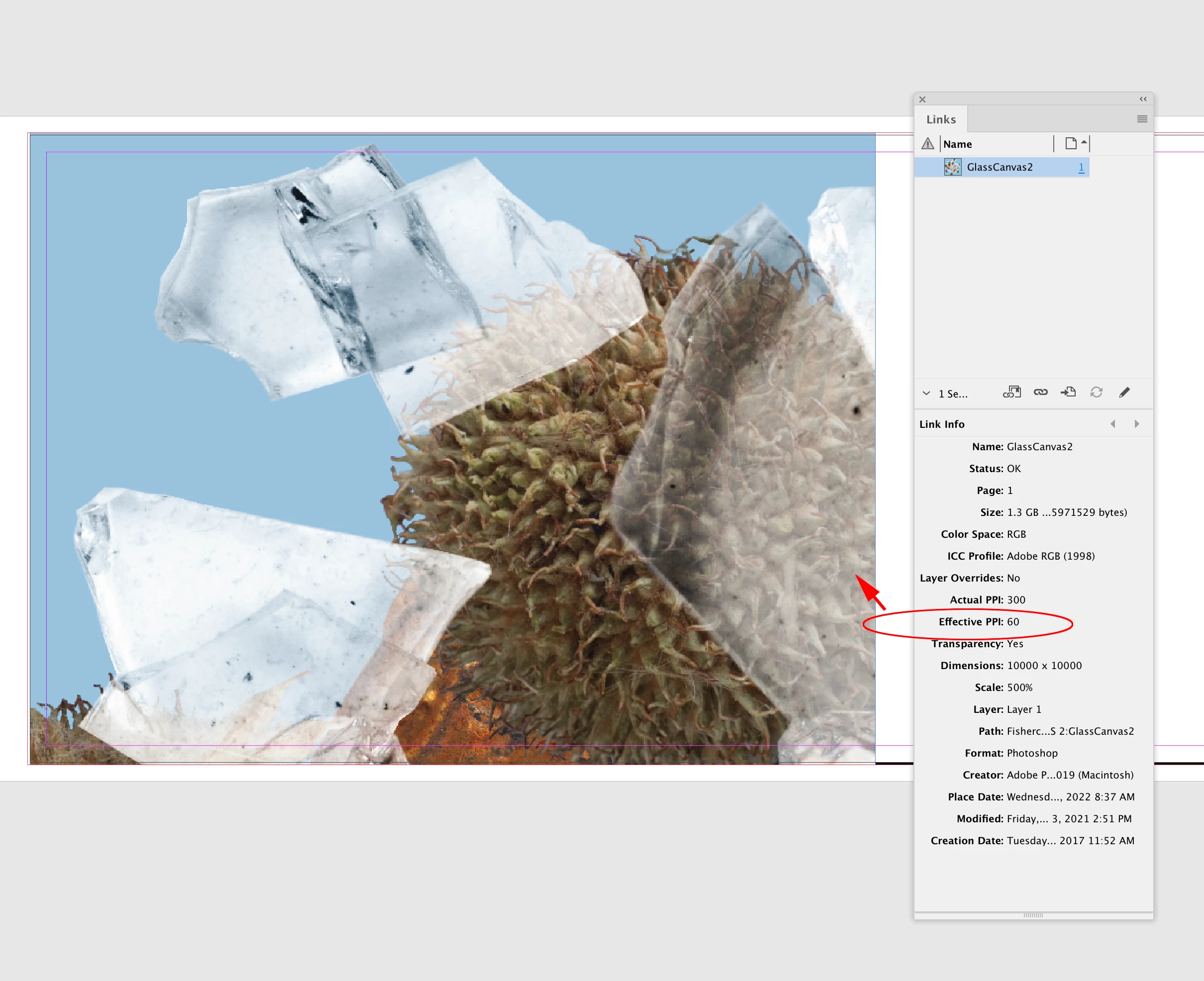

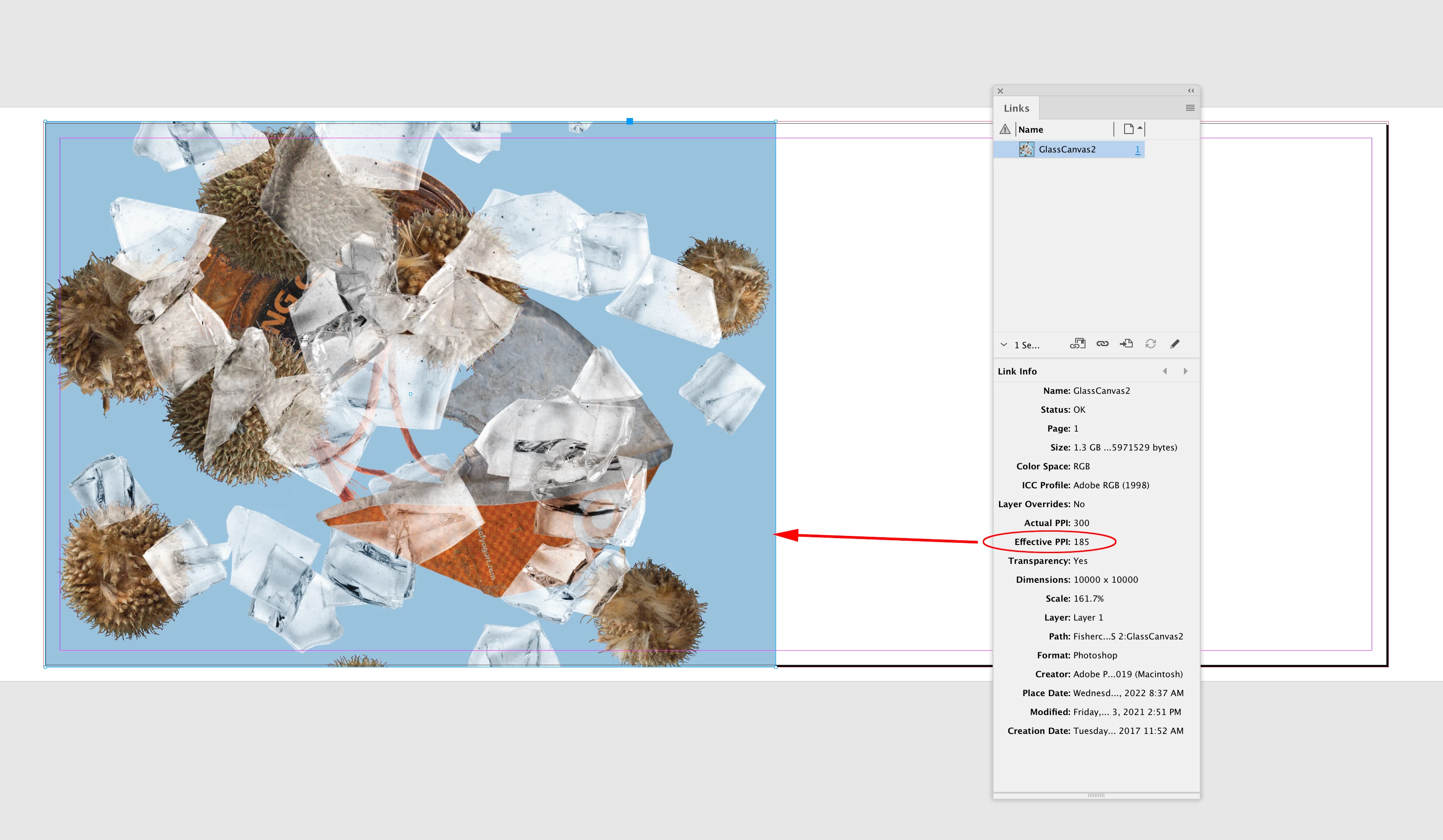

Hi @Susanne5E63 , your 2340mm width under the InDesign maximum dimension, so you can work at full size. To meet the printer’s resolution requirement you just have to make sure the place images have an Effective Resolution (not Actual) greater than 75ppi. Select an image and check the Link Info panel
For example this is OK:
But this is not:
