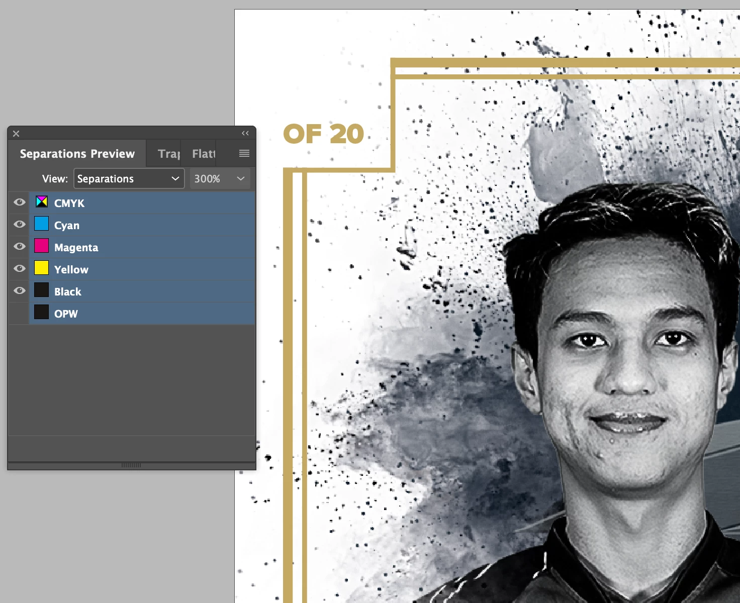

I'm wanting to export just a flat jpg, png, pdf don't really care, of a seperation preview but I'm struggling to find a way, or if it is even possible.

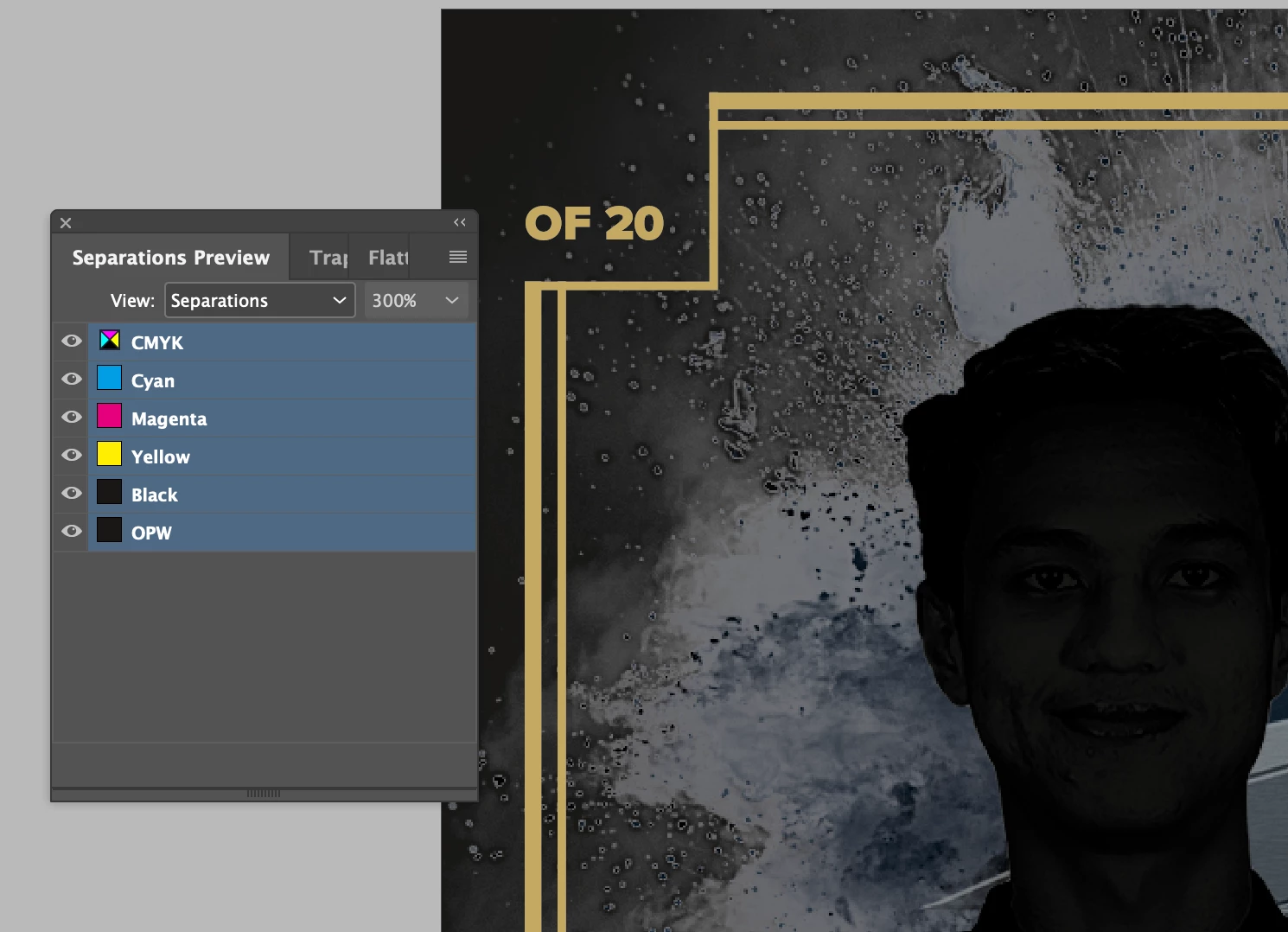

So explantion for reason, I'm printing onto holographic paper. There are areas of the design which the holographic effect will be full, but there are also areas of the design which need to be a matte white. This is done usign a spot ink labelled OPW (Opacity White). This spot ink gets printed first and effectively turns the holographic paper into normal matte paper.
The problem is, this matte effect is applied over a lot of the design, and so when visible, the design doesn't look like it should. This doesn't matter when sending to the printer, but this does matter when I want other team members or clients to check over the design. To make sure the image looks correct, the text is correct etc. Clients especially aren't the most tech savvy so trying to explain using seperations preview in adobe reader is a no go, and also quite frankly too slow a process for checking over things.
I just need a flat version of the design, which doesn't show the spot ink. Just like when you flick it off in the seperations preview.
Note I have hundreds of these designs, with a lot of the OPW having to be applied within the main images PSD. So I'd much rather not have to make seperate versions of every image / indesign doc in order to create it.
Only option I see right now, is using seperations preview and taking a screenshot…which is a pretty lame solution.

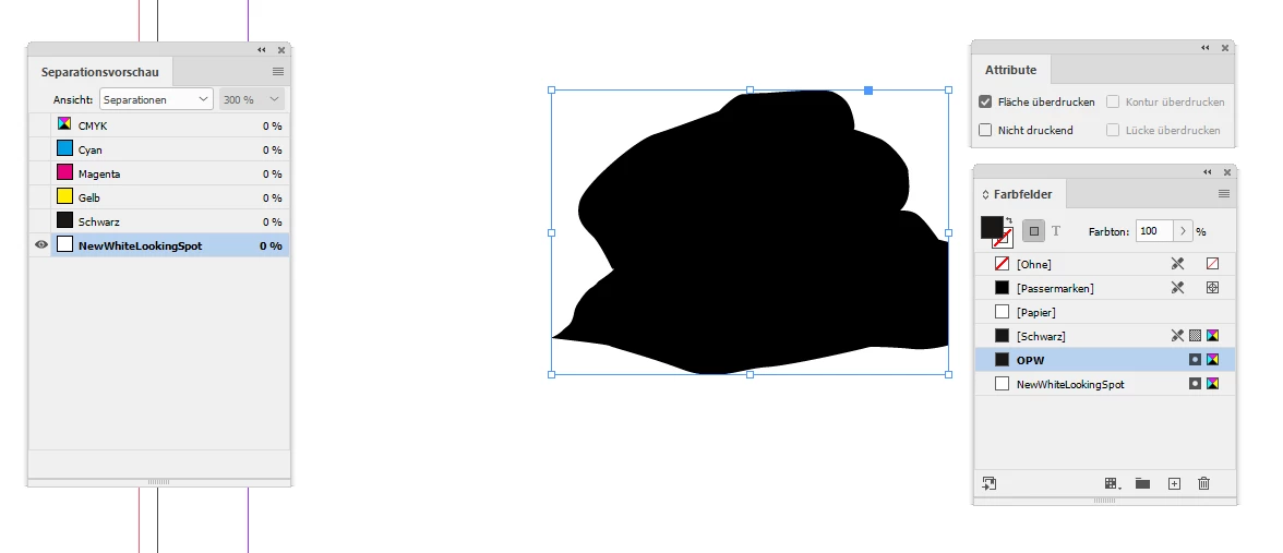

From my German InDesign where the two spot inks are visible and also the Ink Manager:

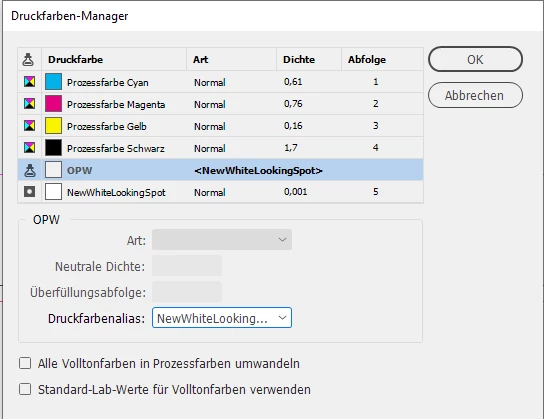

Now we redirect spot OPW to this new spot ink:
Unfortunately the Ink Manager has no Preview checkbox so we must hit the OK button to see the result with Overprint Preview and Separation Preview:
Disable all inks but the new spot ink to see that the spot ink is still filling an area on the page:

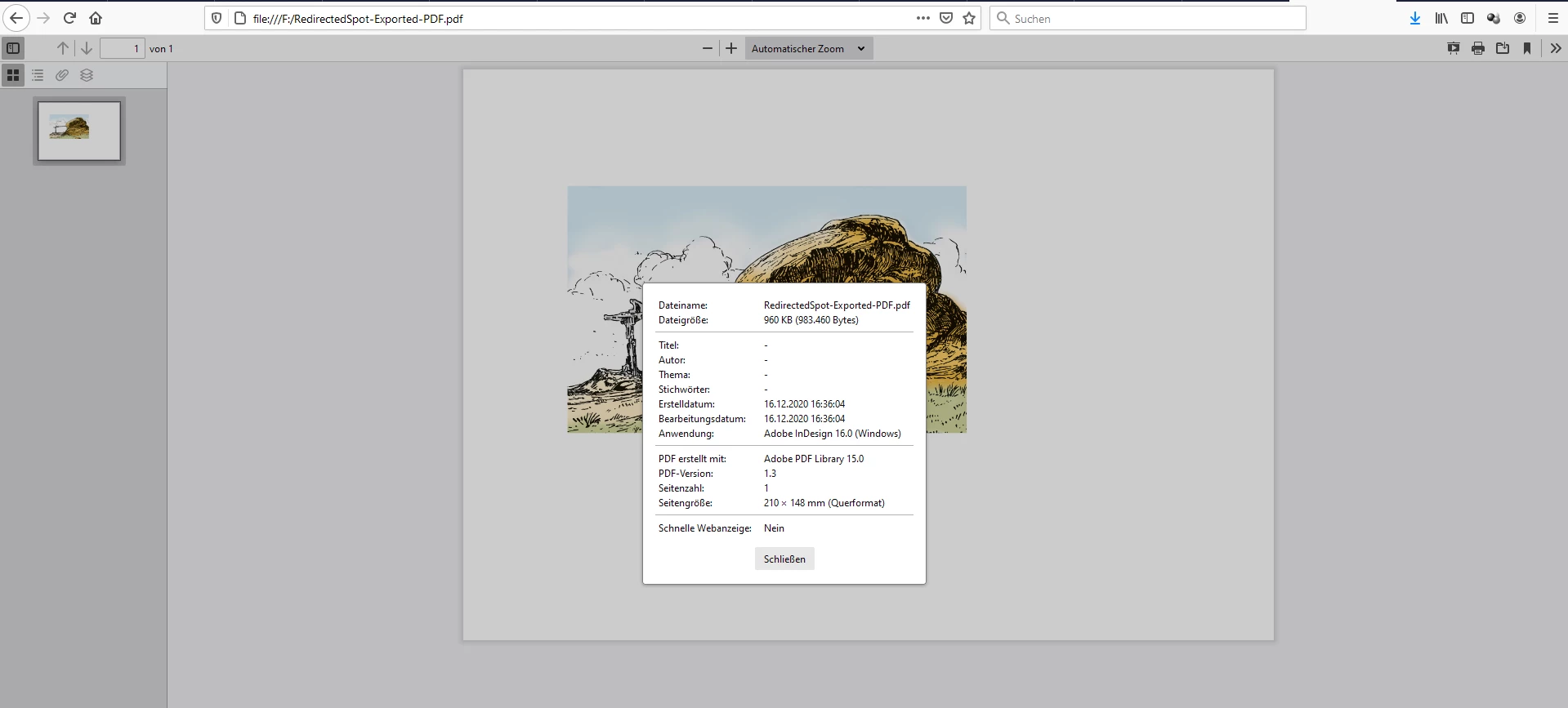

Export to PDF (Print) with PDF version 1.3, converting all colors to sRGB and simulate overprinting:
Exported PDF opened in Firefox browser's PDF viewer showing the PDF File Info:

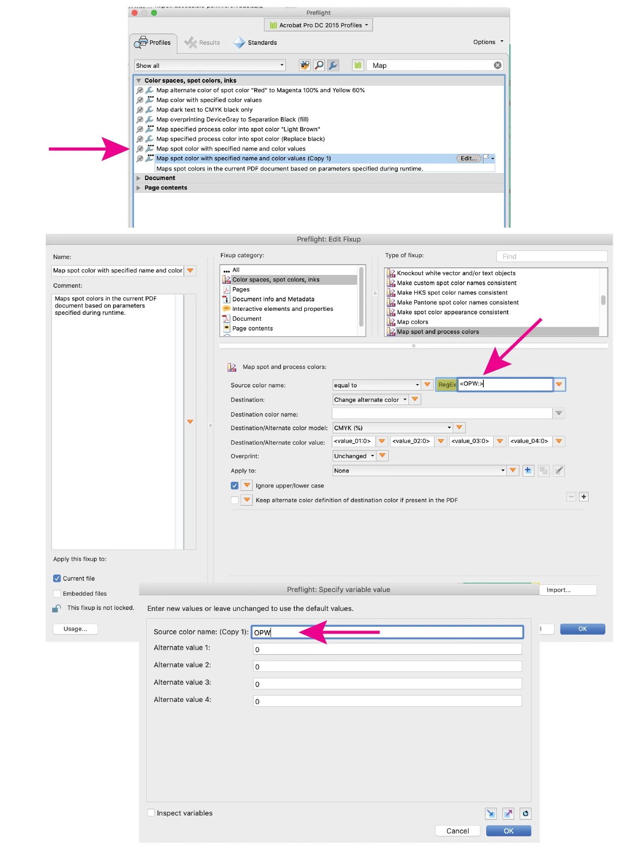

You could try using an Acrobat Preflight fixup to effectively remove the spot white separation on your proof PDFs. Duplicate your PDF, in Acrobat, go to Tools> Print Production> Preflight Fixups, find the fixup Map spot color with a specified name and color values and duplicate it from the fly-out menu (you can't edit an existing preflight, so you need to create a duplicate), change the Source color name, set the destination to 0, 0, 0, 0, save, click Fix to run the preflight. This assumes your spot white is overprinting the other elements (as it appears in your previews). You can add the new preflight to an Acrobat Action using the Action Wizard, so you can easily apply it to other files or folders of files.

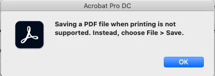

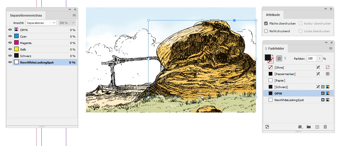

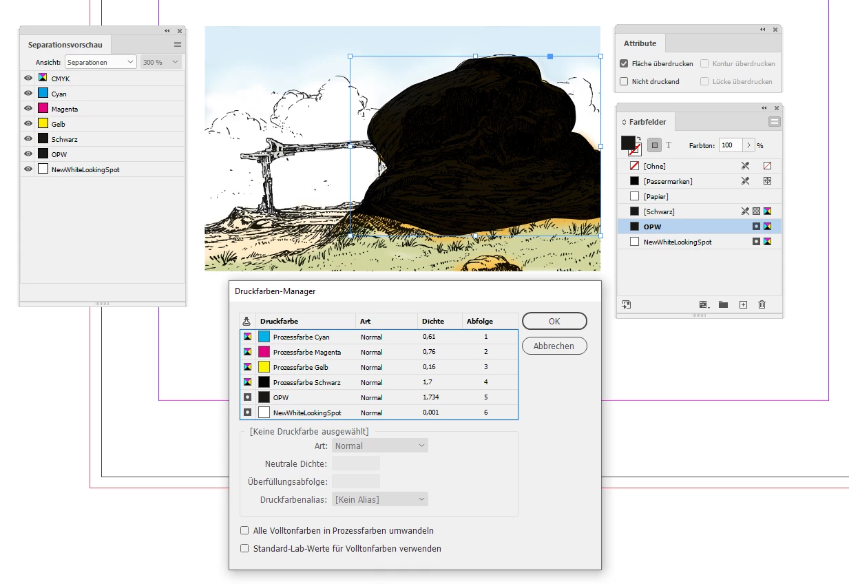

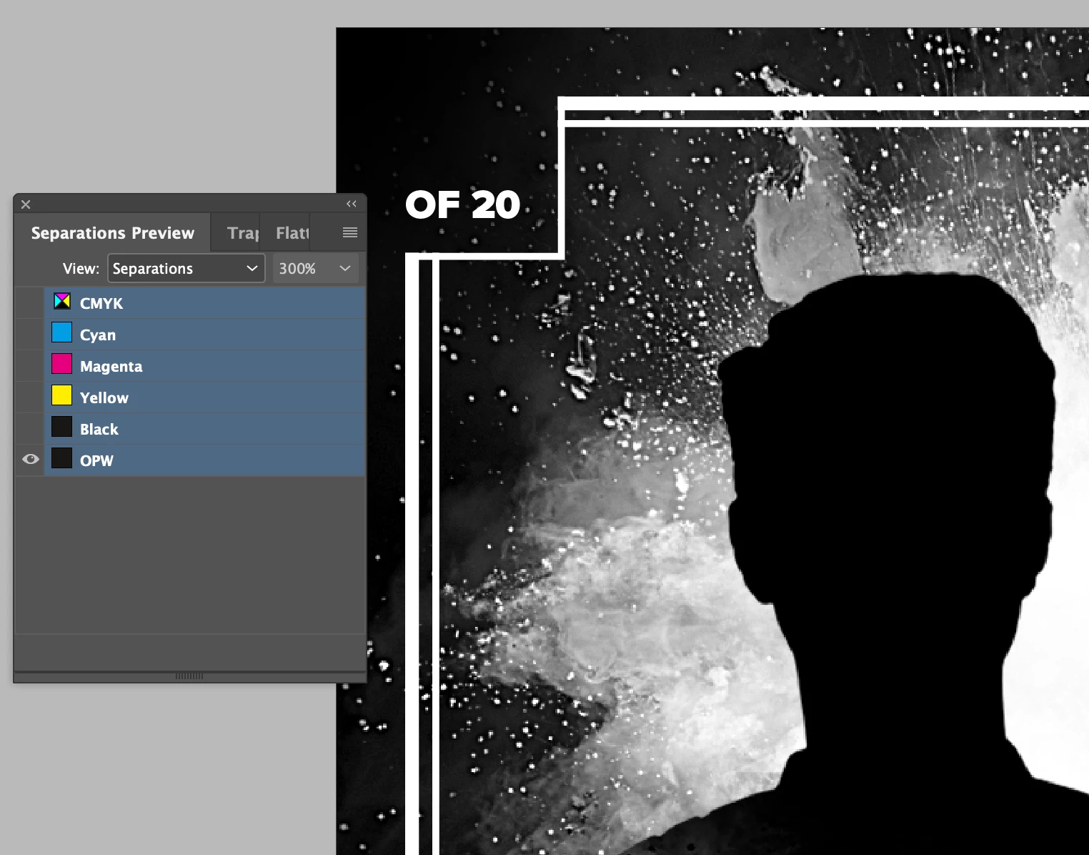

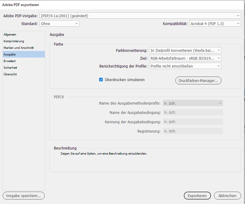

PrepressPro1
December 17, 2020
This function was removed from Acrobat. You can no longer print separations to PDF. I have tried and get this message.
I have had to resort to using layers for softproofs of opaque white and other opaque treatments and educate clients as to what they are looking at. Even Acrobat Reader allows you to see and turn on and off layers
