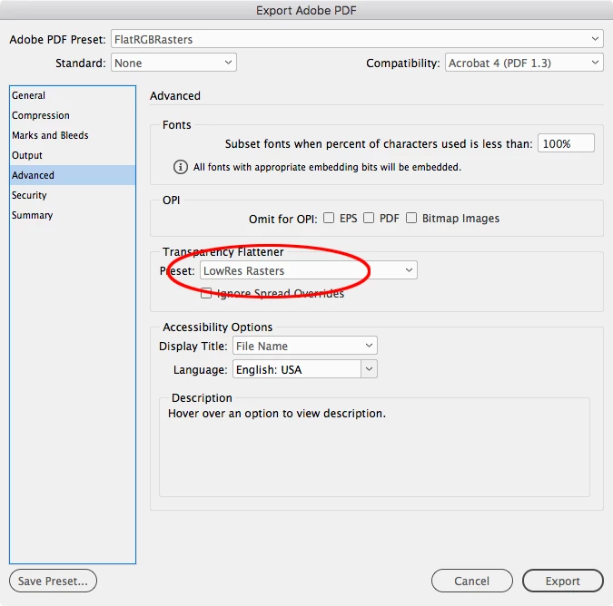

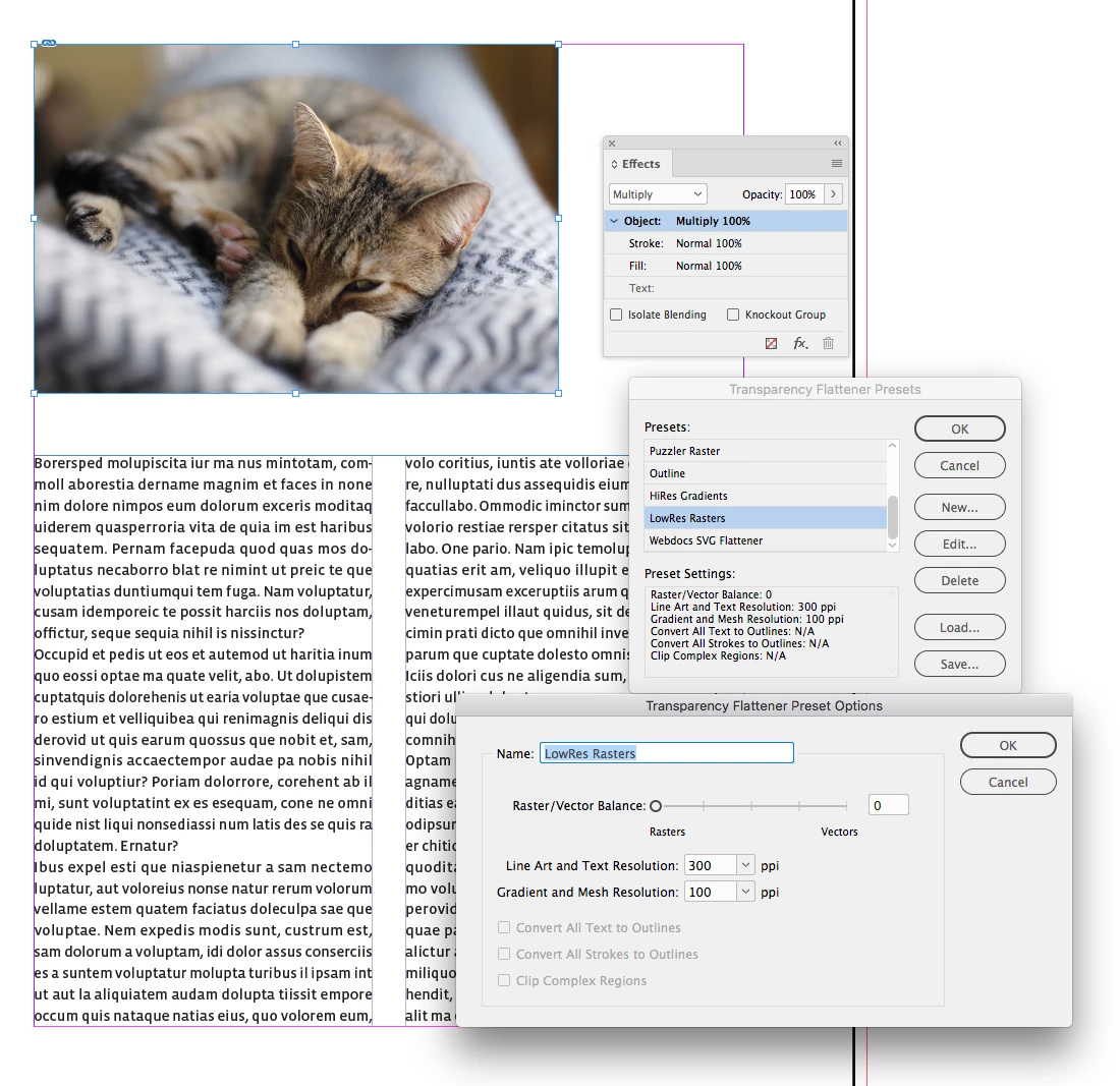

I don’t think you need a script. You can use a Transparency Flattener preset to force a PDF Export to rasterize the pages. Check Create Separate PDF Files to export individual pages.
If you include any transparent object on the spreads—it could be a background rectangle on the masters set to 0% Opacity— and export to PDF 1.3, the page will be flattened using the Advanced>Flattener Preset, which can be set to all rasters:

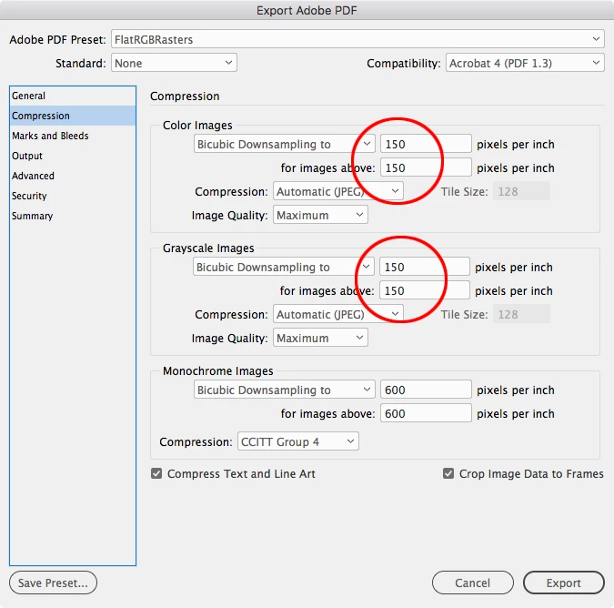

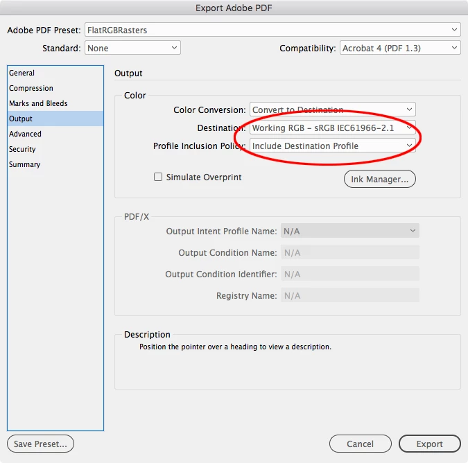

You can then control the color space of the page via the Output tab, and the Resolution of the rasters via the Compression tab:

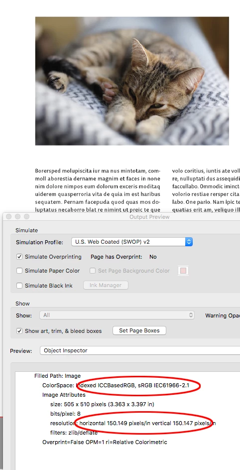

Inspecting the exported page shows the entire page has been rasterized to 150ppi, with the color space as sRGB:
