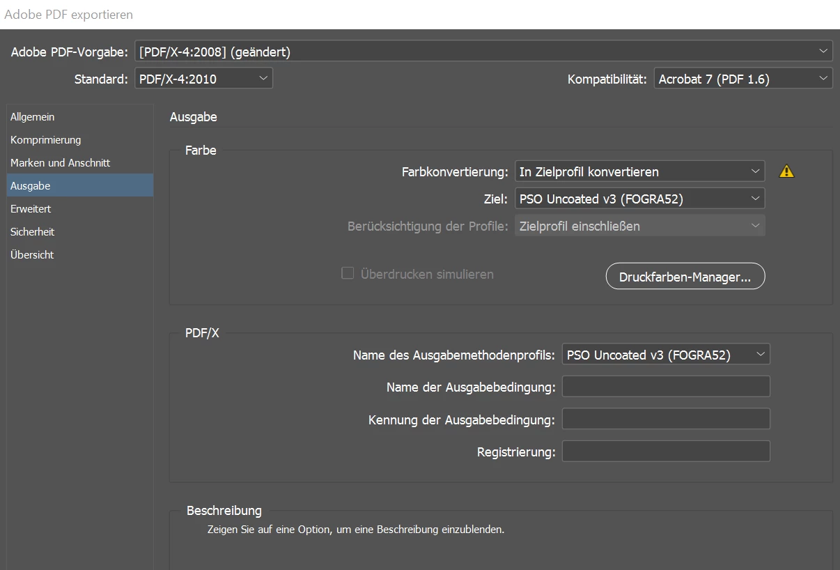

Problem: When exporting with a new color profile, our K=100% becomes CMYK.
Desired result: use FOGRA52 for export and change just the export settings and still keep the text in K=100%
Any idea how to do that?
Here a few screenshots:

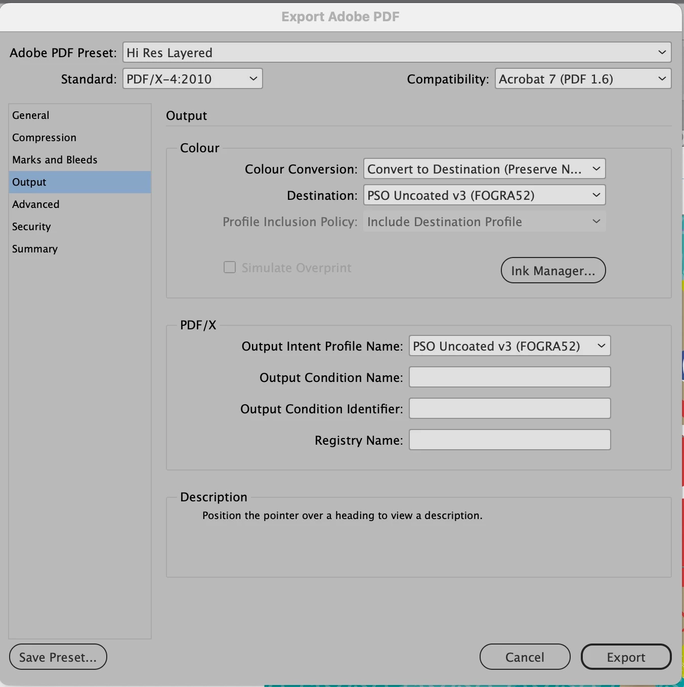

NEW export settings (just showing the differences to the working export, which is just the color conversion into the target profile):
This is the only change we do in comparison to the previous export that works just fine.

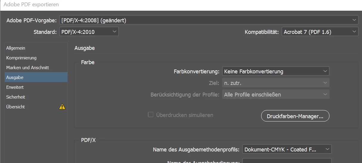

This are the settings that work (Fogra39 and not color conversion):

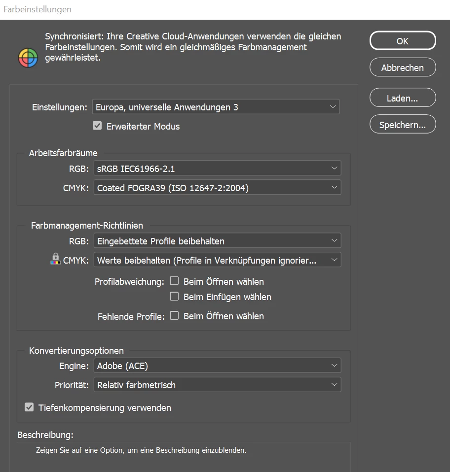

Color Settings (standard - no changes done) (as I understand, this is for all future documents, so we do not want that):

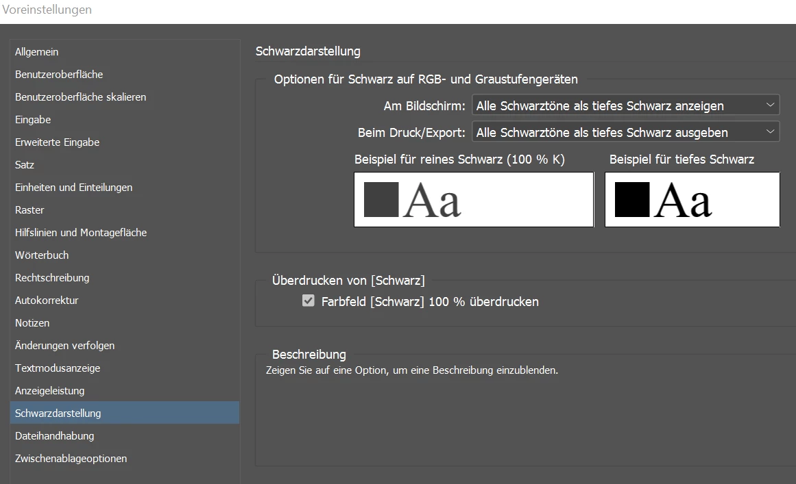

True Black (tested changing "use correct black for output" -> didn't yield any effect in the export result):

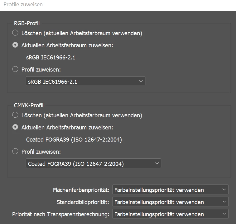

Set Color profile (as I understand this is just for display and as I have no calibrated display, it makes no difference):

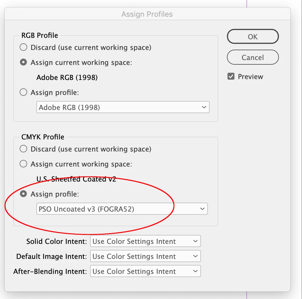

Hi @Improving , Coated FOGRA39 (your document’s Assigned CMYK profile) and PSO Uncoated v3 (your Export Destiantion) are not the same profiles, so the conflict forces the conversion of  Black to 4-color. Set your document‘s CMYK profile to PSO Uncoated via Edit>Assign Profiles... (not Edit>Convert to Profile), and in the Export>Output tab set the Destination to Document CMYK - PSO Uncoated.

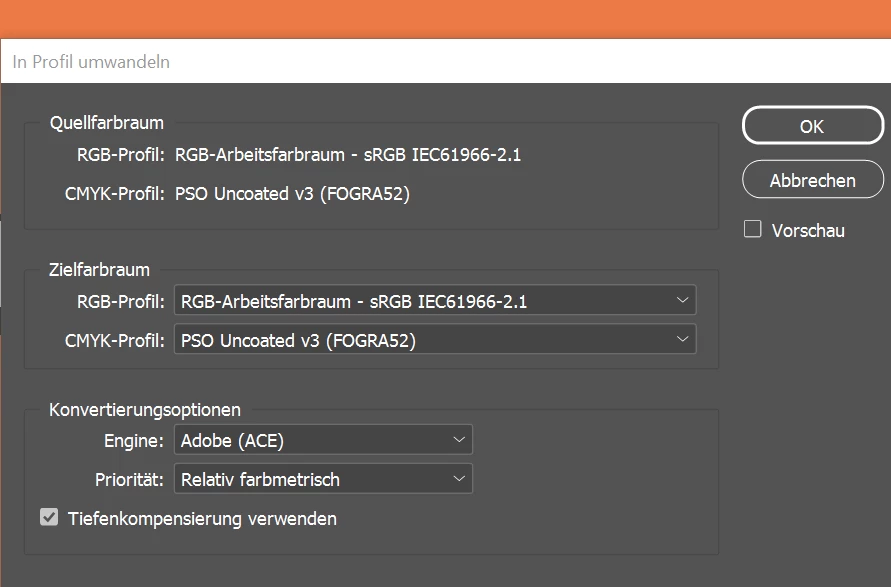

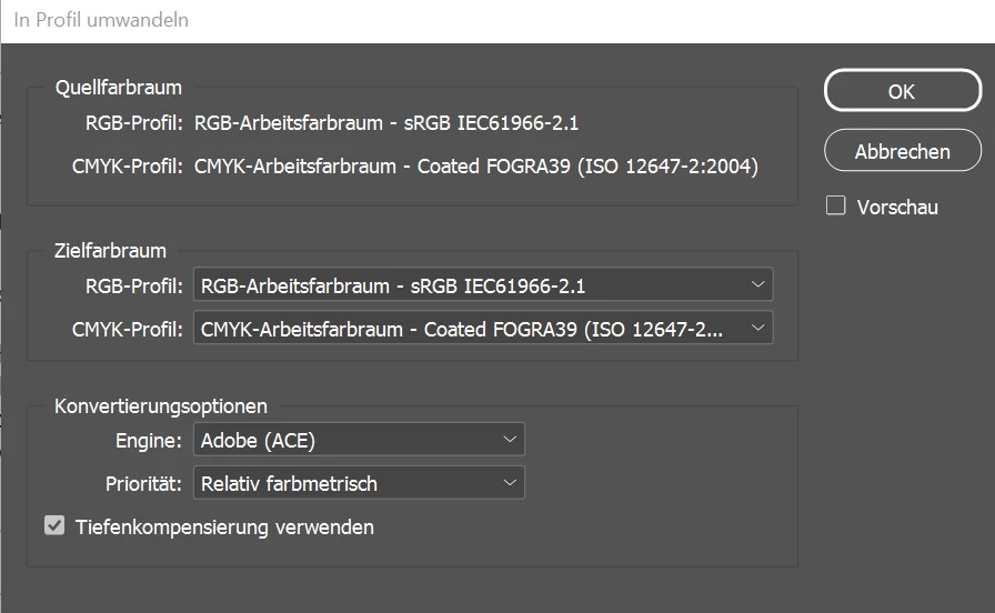

1. So I just go to "Edit > convert to profile > Fogra52"?

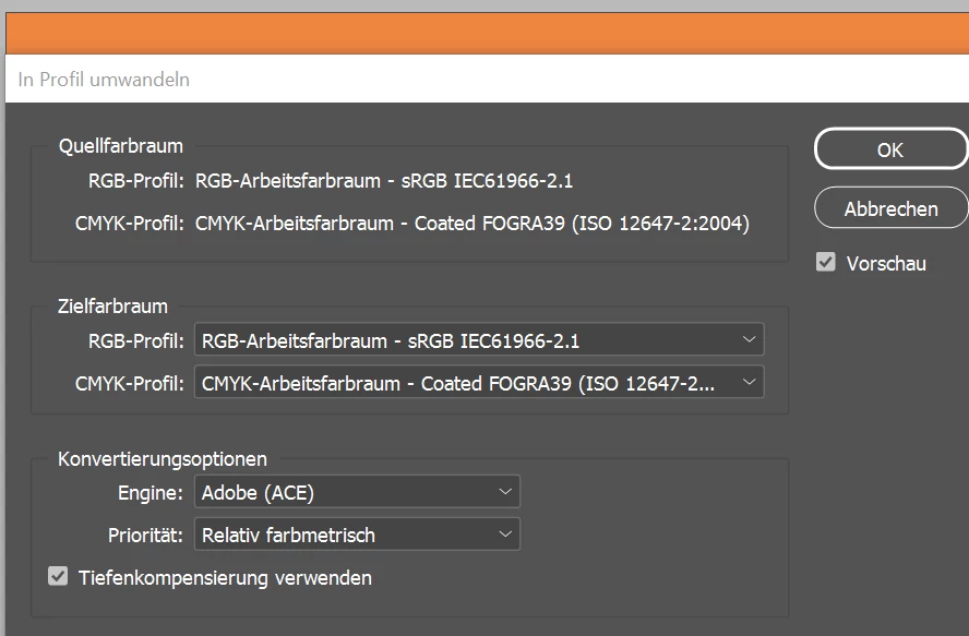

2. Strangely, when I go to convert profile it says the CMYK: Fogra52. But I am 100% sure I have not yet run the conversion . Also when I run it, the orange remains dark.
When I set "assign profile" back to Fogra39 the source CMYK profile changes under "convert profile" and the orange looks as we are used to it.
So what are the correct steps, to have this latest orange exported under Fogra52?
Seems like, I should not use asign profile to 52 but return it to 39? When I then do "convert profile" to 52, the color remains the orange we want it. When I then check "asign profile", I see 52, thus the conversion worked also on "asign profile". And exporting it with in
Color conversion: convert to destination
Destination: PSO Uncoated v3 (Fogra52)
The orange is light again.... I think that is it?!? But are these really the logical steps (also for future projects, as all of our data is in Fogra39).
Yet, I am now again confused on the differnce of "asign vs convert" profile 😄
Why did the "asign profile" show up in the "convert profile" as the source CMYK profile, given that it was only assigend and not coverted and also if the results between asign and convet are actually different?
The Convert to Profile dialogs you are showing have the same profiles as the source and destination so nothing happens.
The difference between assign and convert is with assign you are simply changing the document’s assigned profile—the output values don’t change. If the CMYK profile is changed all CMYK colors are displayed in the new space—the amount of appearance change depends on how different the profiles (printing conditions) are.
Convert to Profile does two things—the actual CMYK output values are changed for the new printing conditions and the new destination profile is assigned. In many cases the color appearance is preserved because the new assignment compensates for the change in values.

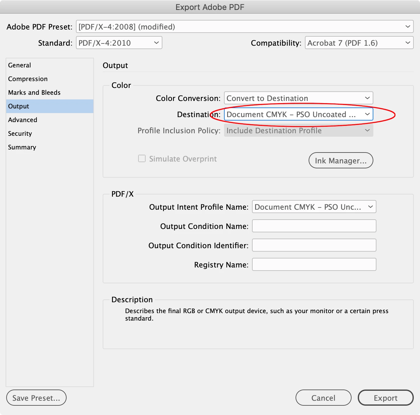

  • export  .. why did you chose the Dokument-CMYK and not the "standalone" "PSO Uncoated V3". And why did you actually chose any conversion at all, given that the profile was already in "PSO Uncoated V3" after the first change.
When you choose Convert Colors with the Destination set to Document CMYK, the native CMYK colors and swatches export unchanged, but any RGB color, or CMYK images with conflicting profiles, would get converted into the Destination CMYK space.
